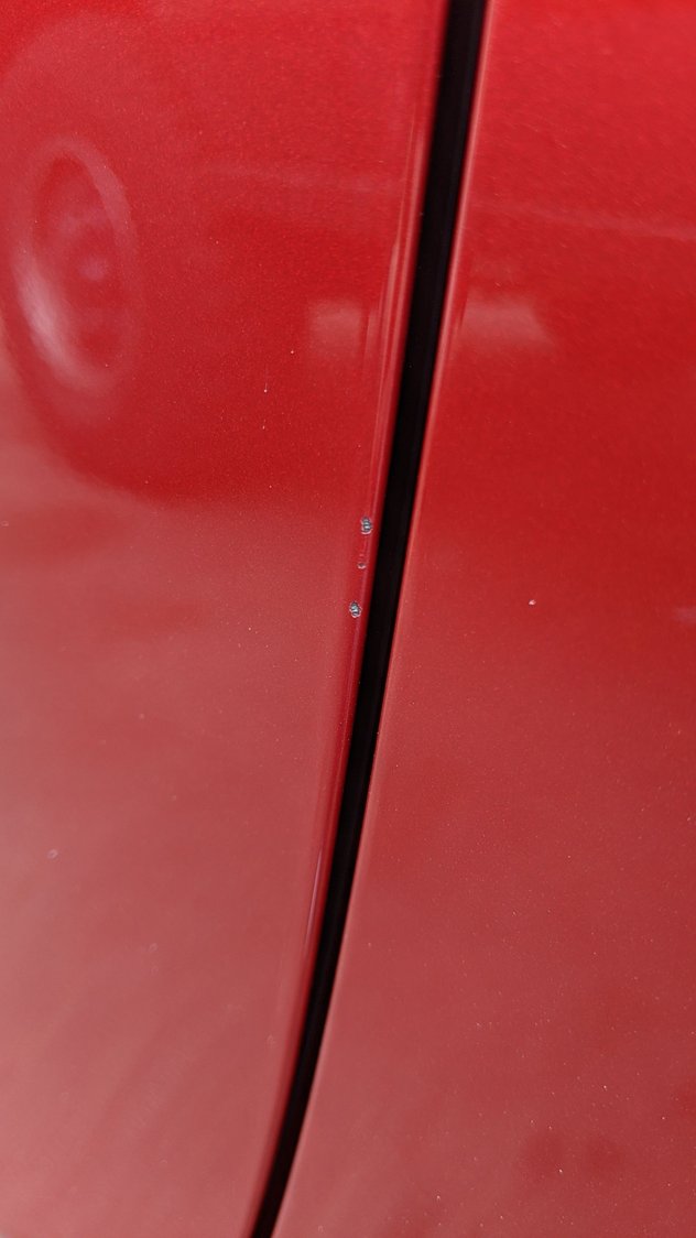

I'm not sure what you mean about the vent. Nothing is wrong with the vent, it was weird, they put duct tape on it. Anyway, it was removed. It was just weird that it was there in the first place.

Oh, OK on second look it is glue from tape thought it was damaged.

Yeah, it was strange. Why would there be two pieces of tape? The dealer claimed that was from the factory, but I think I would have noticed that when I bought the car. And it's only been out of my sight at the dealer. So who knows.
Once, a long time ago, a Mercedes dealer used windshield putty to try and fix the rear seat trunk latch on my E350. So now, I don't expect much from dealer repairs.

I had tape in the same location when I bought my car new. They missed it when they were washing it and getting it ready. I noticed it before I drove off the lot and had them take it off.
It seems weird that tape would be sandwiched between two panels like that. And what was it for?
Its gone now so no big deal.
Same!
Boy it sure looked ripped to me.
