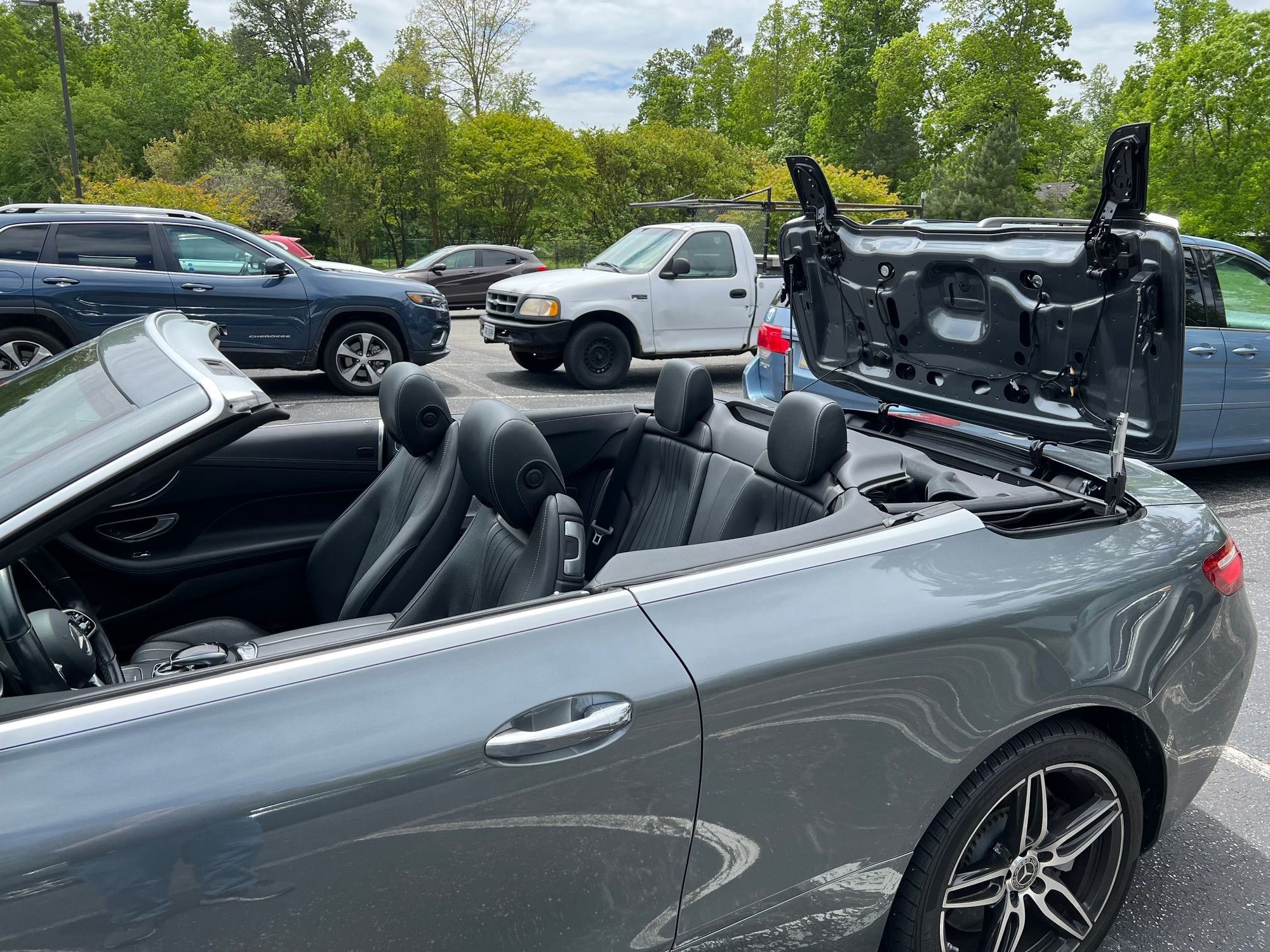

The second time in two years, the top has stopped working. Was closing the top, the well cover opened up, extended it's little flaps then stopped working. All it does is complain the top isn't fully opened/closed.
Currently on hold for 20 minutes and counting for MB roadside assistance. Does it usually take this long to get "emergency roadside assistance" on the phone? Don't want to drive it at 45-50mph on the roads to the dealership becuase it'd be WAY over 31mph you're supposed to be able to drive while moving the top. It'd probably put too much stress on the part that's sticking up.
Anyone else ever had this problem?

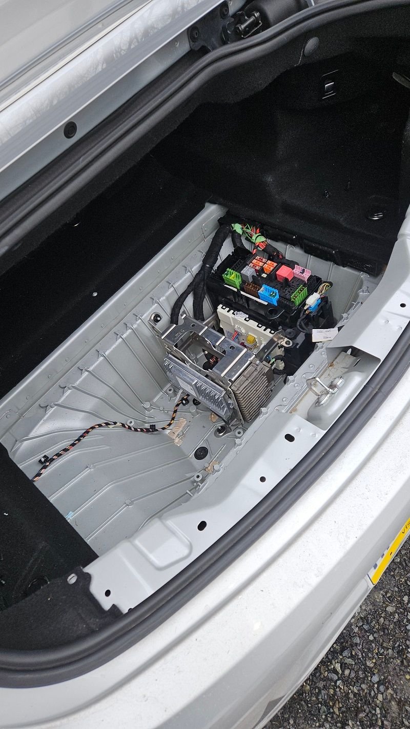

I'm going to add a roll of duct tape & some ratchets straps to the tool kit in our A238 I already scoped out the extra space under the lower trunk storage area. Looks like a bit of additional space there due to un-installed options.
