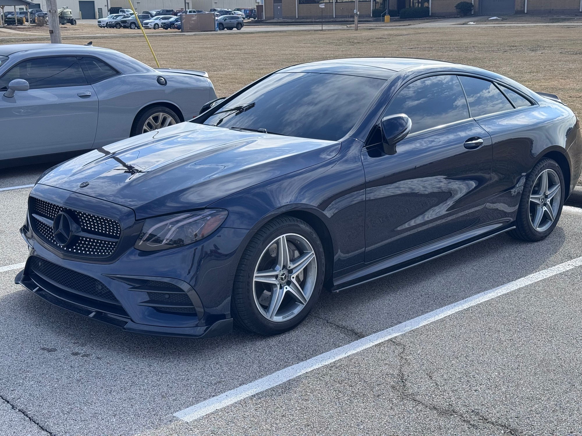

I purchased a 2019 E450 4MATIC Coupe AMG-Line. I am curious to know if either of you have any follow-up for this thread? I started with new/aftermarket wheels (should be picking up and installing in the next few days). I too, would like to reduce the roll during turns, and stiffen up the suspension a bit.
Dumb question, My car has the dynamic driving modes that I can choose from, does that mean that I do have the air system that adjusts in different modes? I have not tried putting it in sport or sport+ mode when taking fun curves. That’ll be my next step, to see if I notice a difference. That might solve my problem.

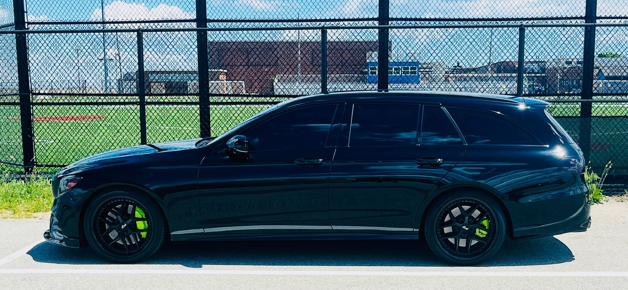

Congrads on your car.... I finished off my wagon last fall. Came out pretty close to what I was going for. Pretty sure you don't have air on your coupe. What I ended up doing is sport springs in the front and tricked the car to lower the air bag system in the rear to the new lower height in the front. It cost me about $210 for the front springs ( you would need four springs) and it cost me about $1100 to have it installed at a trusted performance shop. You have to get an wheel alignment so make sure the shop has one. Worth looking into to, one stop shop. The shop for me was a hour away, after I picked it up I had that time coming home to feel the difference in the cars performance. Big improvement from stock. I didn't get the full performance upgrade due to having to stay with the air bags in the rear (wagon) but lowering the rear help my wagons performance as well. Your 450 coupe you will get four lowering springs with your kit so it will be $500 price range plus install. In my opinion this helped my car a lot from that soft suspension they set the car up with from factory. I then dropped 20 inch rims on it and went way wider on the tire size. My roll has almost disappeared unless I'm really pushing it in a corner. The bottoming out is better and I don't ever bottom out hard like the stock springs did, but I'm always watching for **** like that.. Going bigger on your rims and tires, in my case 18 up to 20's my MPH reading was off by 2 MPH now. For instance showing 68MPH on helm but GPS radar shows 70 MPH just an FYI. Next I pulled the brake calipers off the car and had them painted Kawasaki Green with the Black 20's I put on the car. The Black and Green really PoPPed!! Loved how that part came out. The last thing I did was re tuned my ECM. I went to AGAIN a trusted performance shop. The shop you use, if they know there stuff will have all the software to crack into your ECU (engine control module) and re map your air fuel mixture and timing. The V-6 Twin turbo motor already puts out 362hp with 369ft/lbs after my tune it went form that up to 480hp with 528ft/lbs. Took the car for a ride and OMG! Worth every penny at $1500. We did the math and with the mechanical loss I'm around 400 at the wheels and it feels like it. The torque now on the car puts your head into the head rest. The Sport and Sport+ function. I NEVER drive to car in sport +, it's undriveable unless you shift with the paddles yourself... I find. It revs out the motor so high and for so long. You find yourself saying "shift already....."
Springs. By just doing the springs you keep you factory damping system on your car the same. No error codes on your helm because the system function as normal. Getting shorter springs to lower the car for body roll and a stiffer springs for bottoming out. The car will ride a little stiffer but the trade off is well worth it. If I'm looking for a smoother ride I just put the car in comfort mode because the damping system still works after your performance upgrade. Also if you tune your car, when your in comfort mode the HP gain is still there so the car woke up BIG time when in comfort mode. I found before the tune the car was lazy and just wanted to get to 9th gear asap. Now it has a nice somewhat smooth ride(after the spring upgrade) but in no means is it lazy anymore, and in Sports mode! it's a force to be reckoned with. This is the most hassle free way to get more performance without opening pandora box. Oh yeah by the way they have a factory govern speed sensor on the car. Mine car falls on it's face at 130mph very disappointing....The motor has so much more. Hope this helps it took me so long to get here...
The finished vision.
