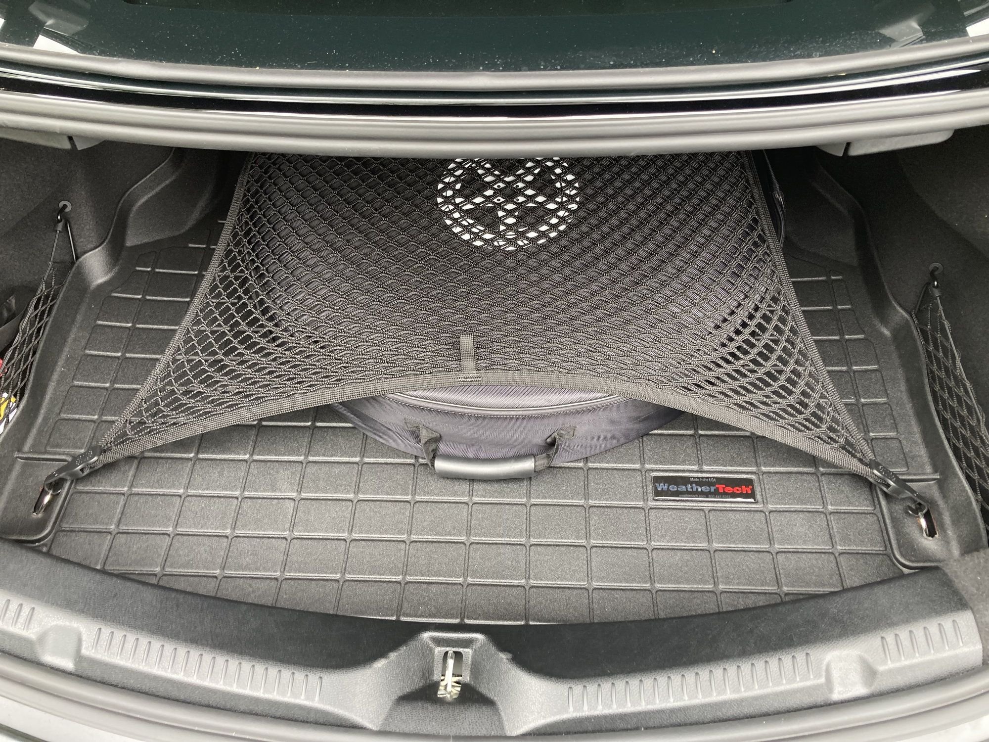

Here’s the spare and weathertec trunk liner

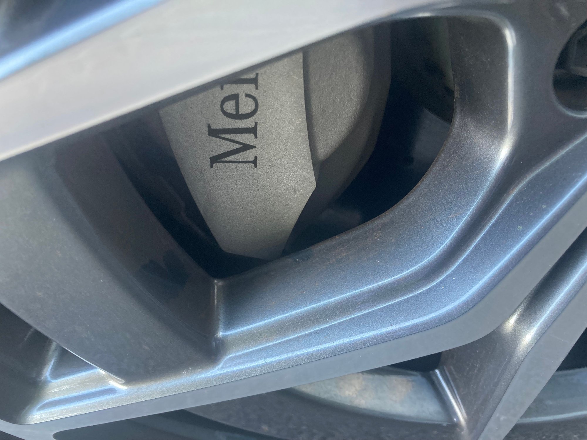

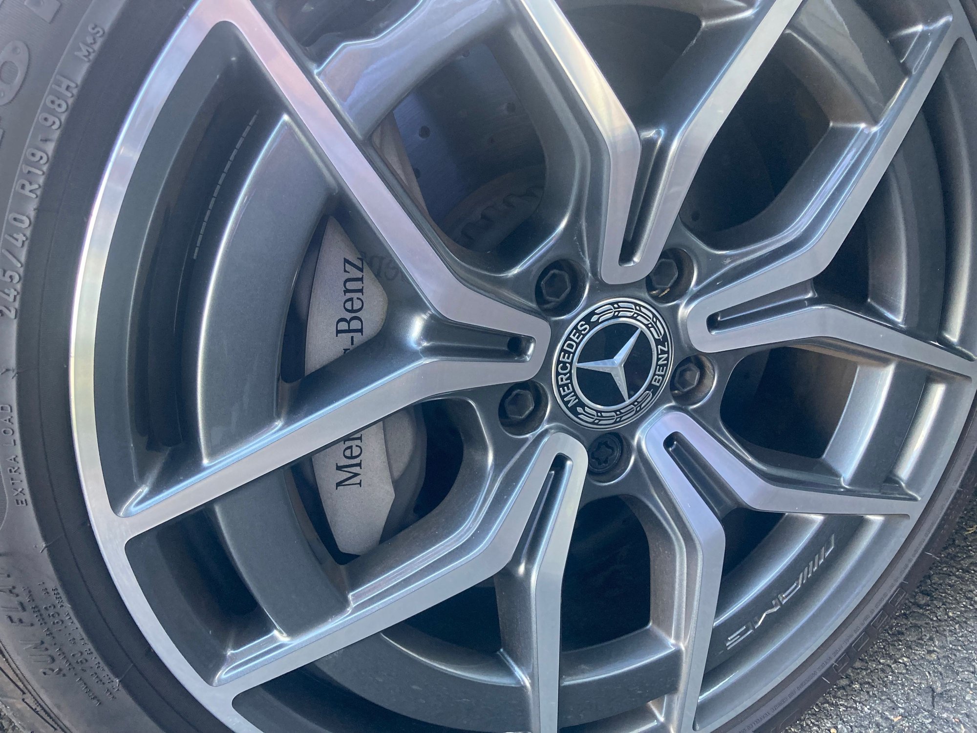

Never tried it on, maybe I’ll give it a go over the weekend and report back
here’s the front caliper pictures

If the Modern Spare tire doesn’t fit they have a spacer to push the rim/tire away from the caliber. That’s what they do for the AMG cars

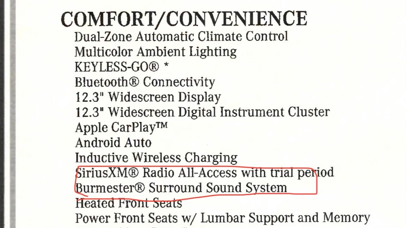

Bill I checked the WeatherTech website. They say the mat you have does NOT fit vehicles equipped with Burmester® High-End 3D Surround Sound System. Does your car have that sound system?
Old Aug 10, 2023 | 09:17 PM
BillMFD3's Avatar
Joined: Aug 2022
Posts: 23
From: NYC
E450 Coupe
I have the Bermiester Sound System that came standard on the car, not the 3D. I had the same question. The liner fits fine.
I did have to cut the small slits so the tie down hooks could be used.

Thanks for the reply. I’ve got the Burmeister, not sure about the 3D, which probably means that I don’t have it.

From my window sticker
