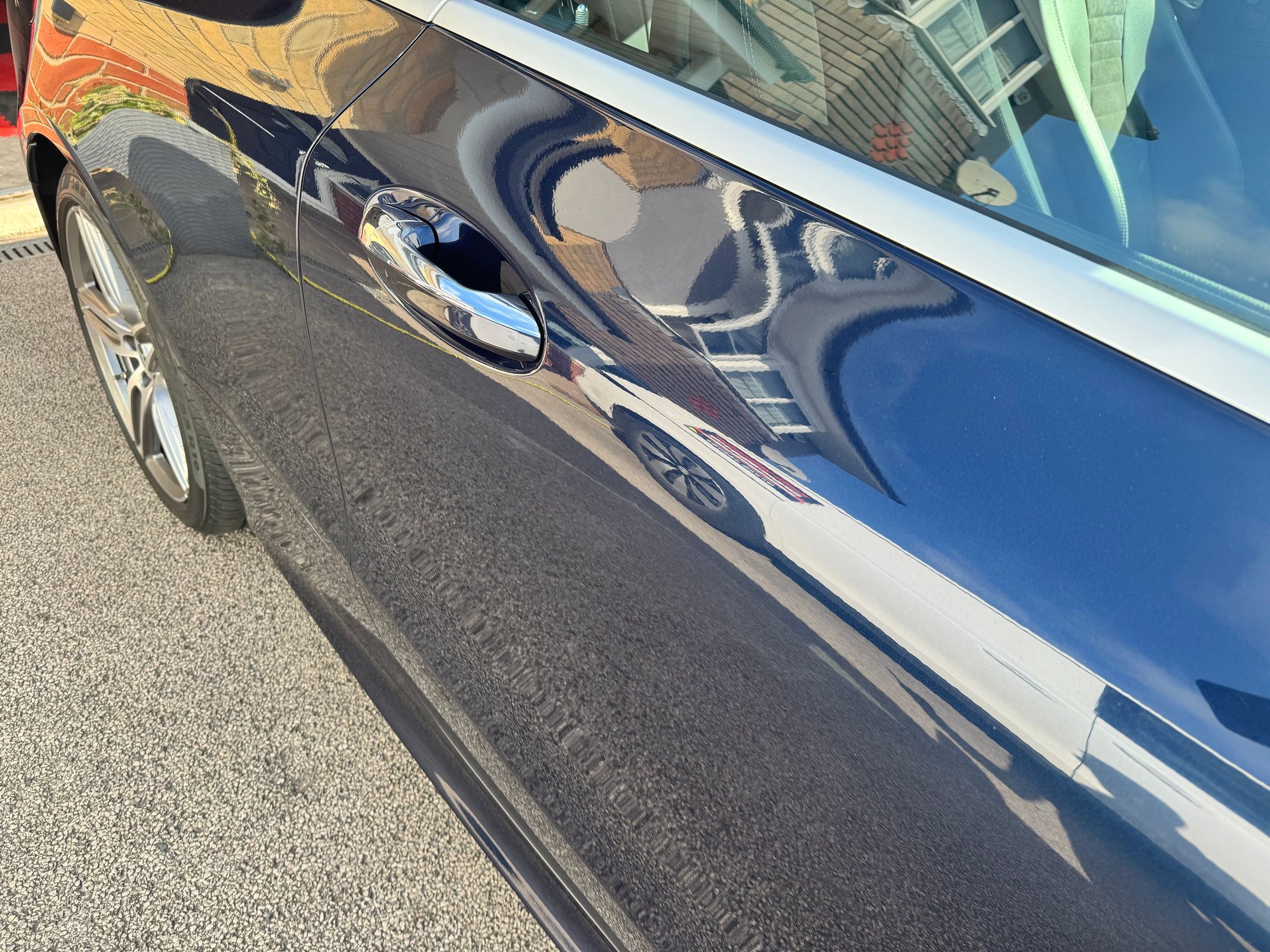

just a quick update

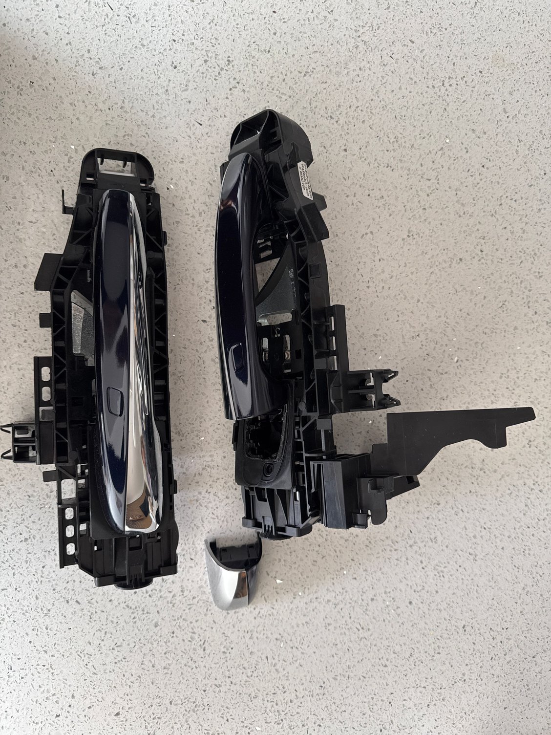

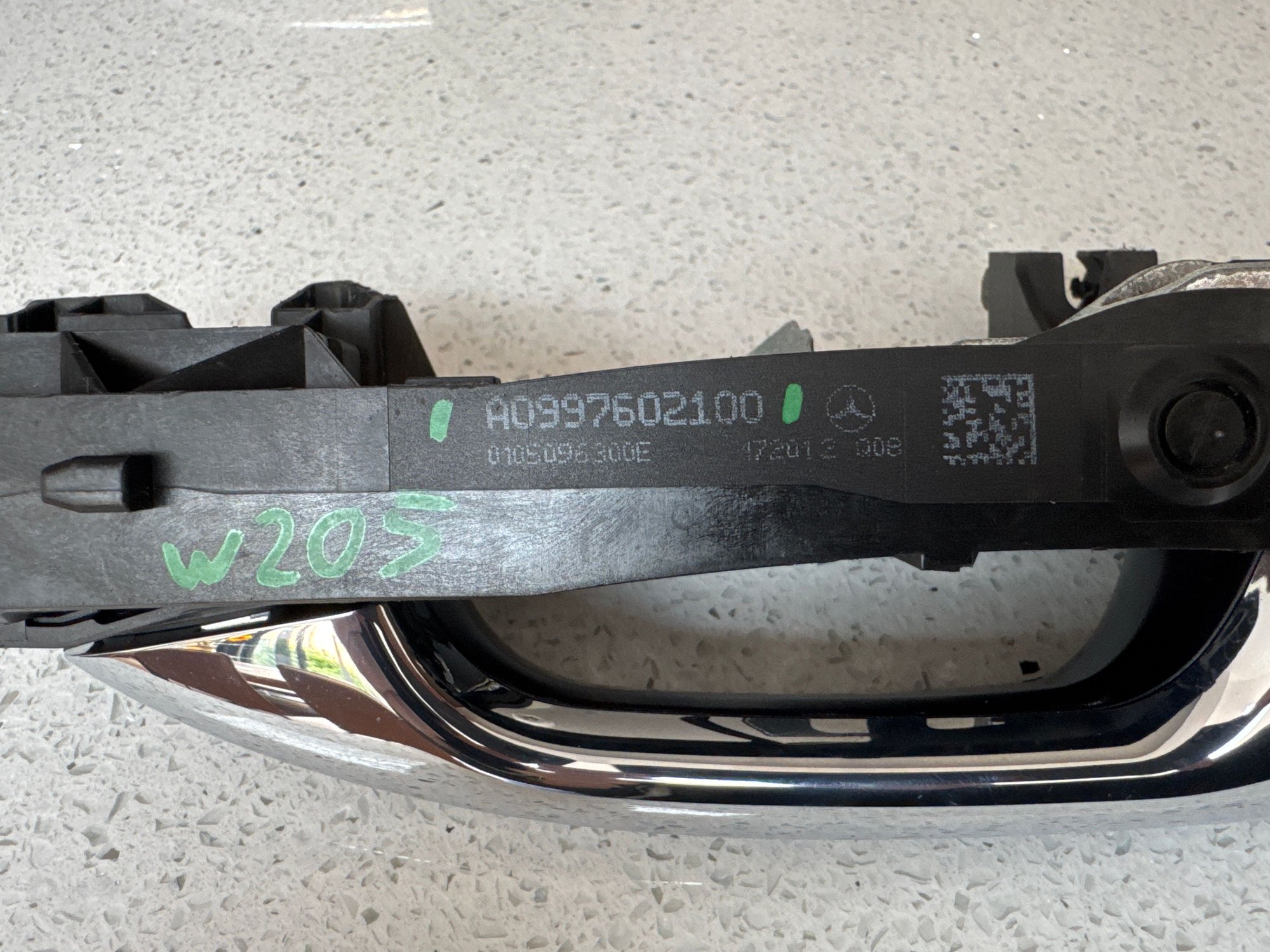

I managed to get hold of front passenger/drivers door handles
My car is 2020 cabriolet e class 238 but same handles as coupe and i think saloon w213
you also need the inner back mounts
passenger uk RHD is
drivers side uk RHD
as i only plan to make drivers side keyless entry i’ve only bought wiring for right hand side drivers door (uk)

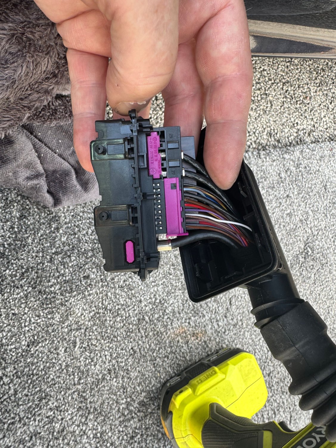

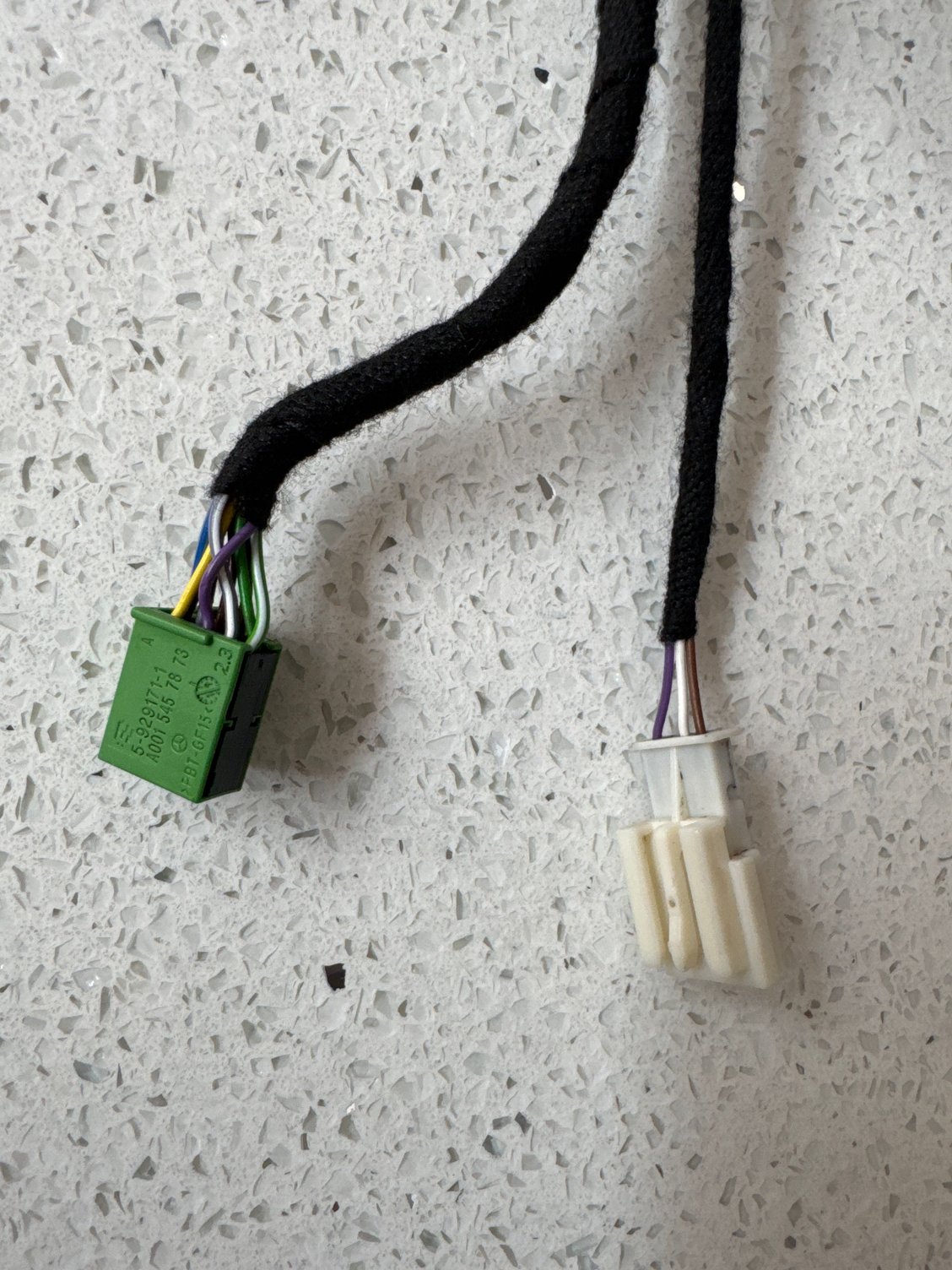

this wiring connects to keyless handle sensor and led door handle pocket led (this goes into green connector front door ecu and will need coding)
same part number fits passenger and drivers side, not sure if four door cars have same loom but would think it will be.

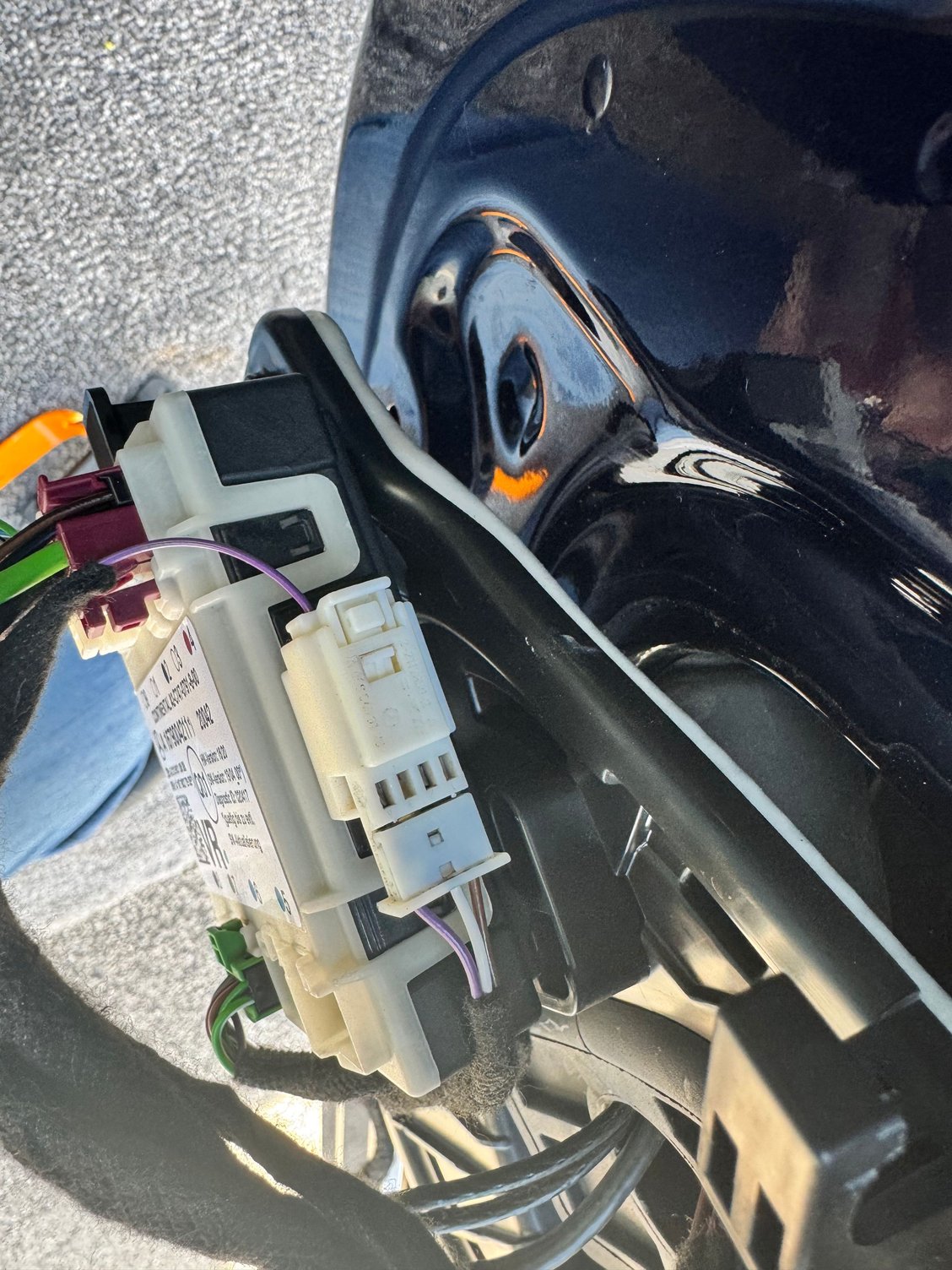

keyless part of loom missing from my car has three wires brown and white go through door connector (29pin x35)
to KGM module in rear
other violet wire in same connector comes from door control unit, at the moment i can’t find what this wire does as it doesn’t appear on any wiring diagrams i’ve found
green connector = door ecu
white 3pin = goes to kgm module in rear
the connecting loom from lock loom to door connector has two plugs
white extends into door connector for lock/unlock signal but as yet not sure on violet wire
this connector is for drivers door antenna

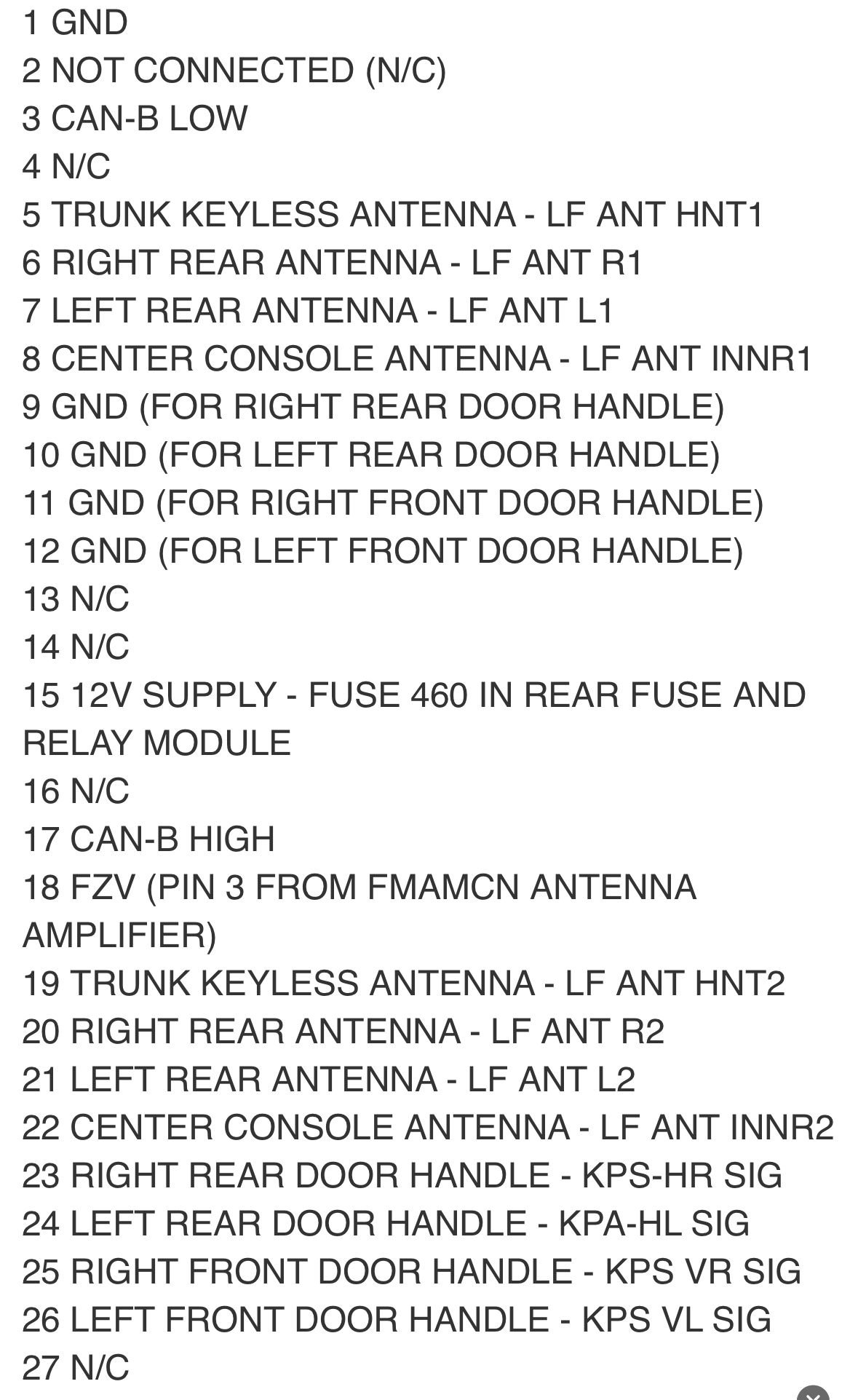

but KG module in rear has pins for passenger front rear drivers rear antenna but no drivers door so again can’t find where the drivers door antenna connects too
this is KGM pin diagram
So basically it’s two wire from drivers side door handle that connect to KGM in rear then two antennas one in drivers door and one in boot/trunk then coding by someone much smarter than me 🤣
but violet wire has me stumped and where to connect drivers door antenna.

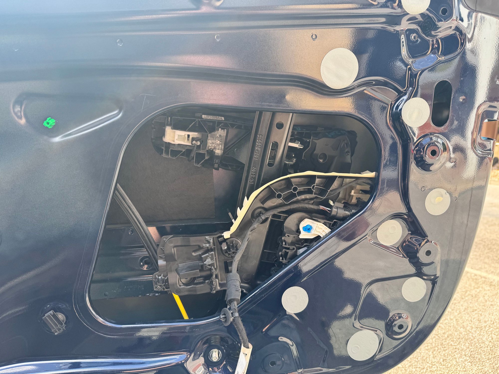

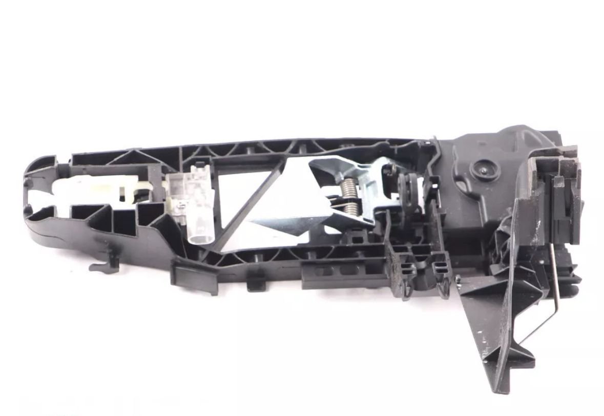

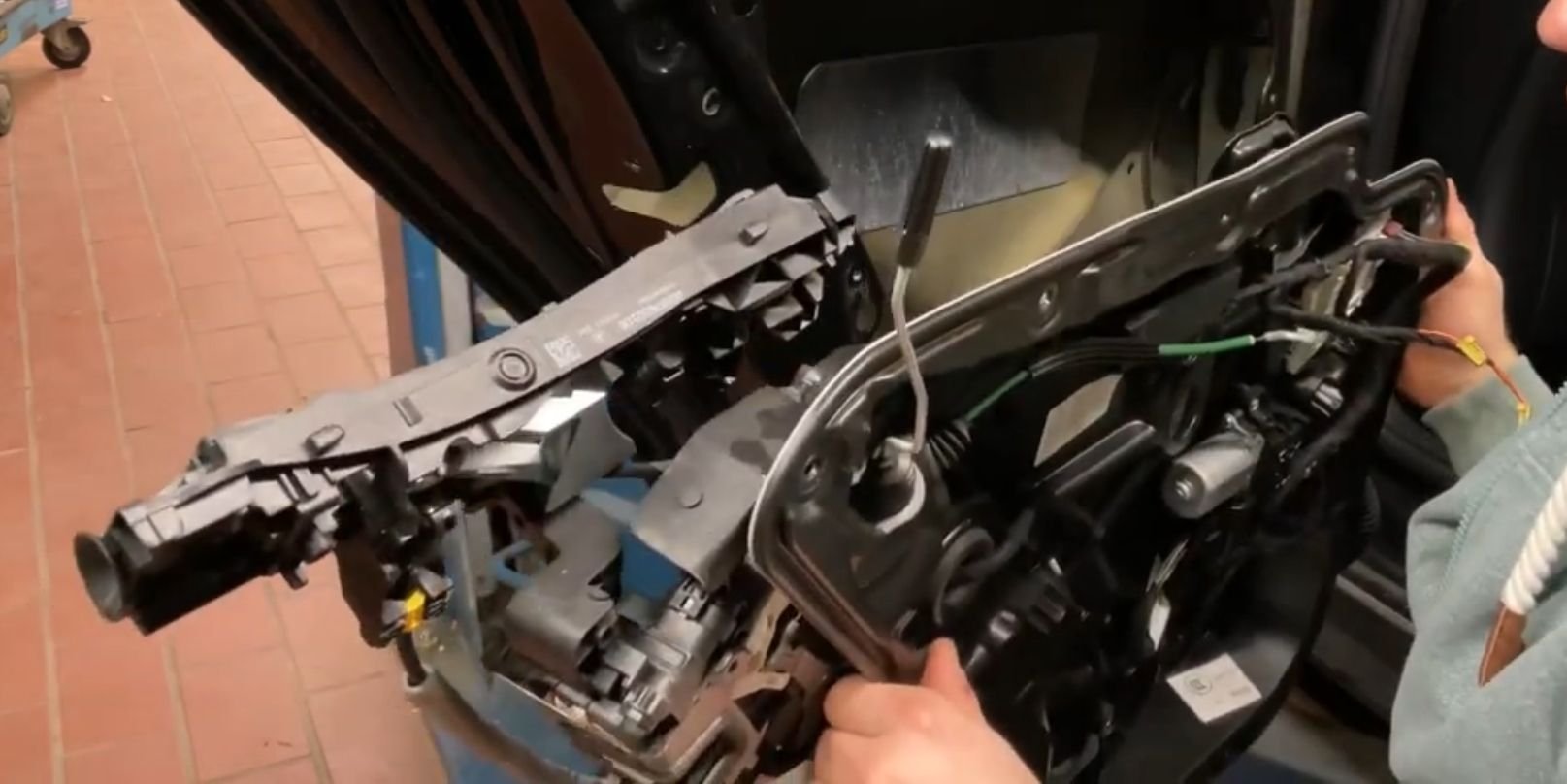

both inner door carrier's have to be changed for new keyless outer handles
This is a difficult as the whole locking mechanism has to come apart to fit
the new keyless door looms are plug and play connecting to door handle led’s, lock/unlock sensor, door lock motor, door control module then onto main door car connector

so getting ready to run the body loom up to KGM in boot/ trunk
after looking at mine it’s not got enough pins for keyless
found what i believe to be the correct one for my car but it’s not new
so not sure if used KGM can be coded or do i have to buy new ?

W213 All-terrain
No worries, it can be coded if is Second hand. The Keyless module doesn't handle any security, just forward the signals from each side antenna and capacitive sensor.
4 wires from each door to module

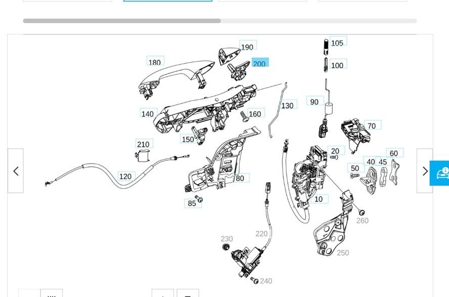

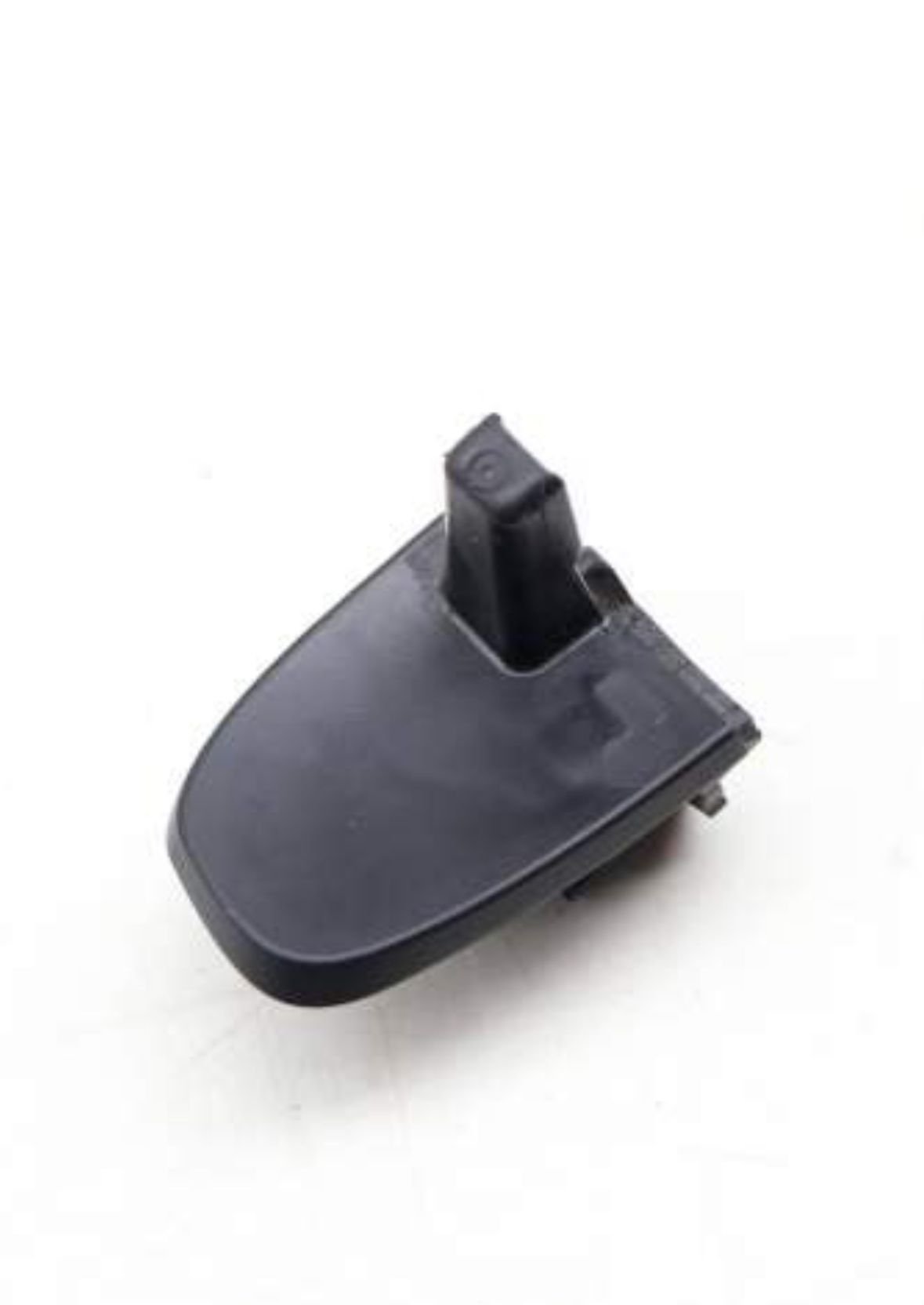

And besides handles, antennas, support for handles you have to be sure that the magnetic part - from the fixed part of the handle - should be installed as well
Old Aug 16, 2025 | 07:17 AM
mollie's Avatar
Joined: Oct 2024
Posts: 38
Likes: 8
Thank you that’s great

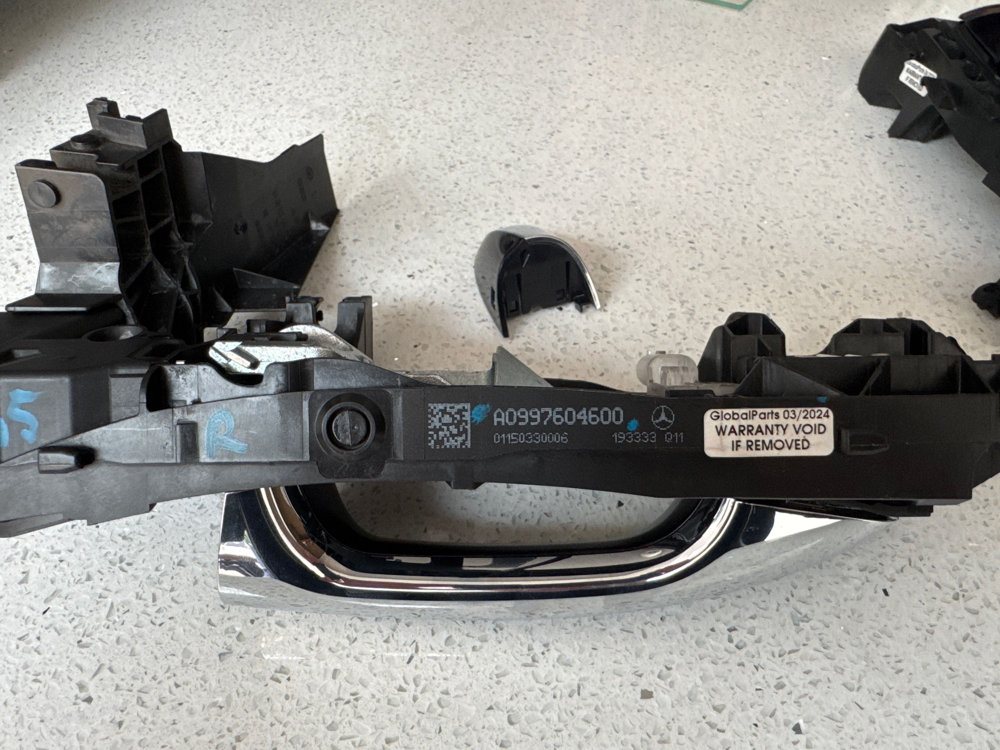

can i ask what you mean by magnetic part of the fixed handle
I’ve used genuine mercedes handles and back inner door mounts
Old Aug 16, 2025 | 10:11 AM
trigital's Avatar
Joined: Dec 2011
Posts: 1,692
Likes: 488
From: Spain UTC/GMT +2 hours
W213 All-terrain
On left door is included in Part numbered 190
On right door the Part 200 it's mandatory

Yes i have this 👍👍👍

Originally Posted by mollie
Yes i have this 👍👍👍
With Keyless option as the old one looks alike but not working

ok i’ll check the part number A0997602500
you are spot on mine is different to the keyless Version

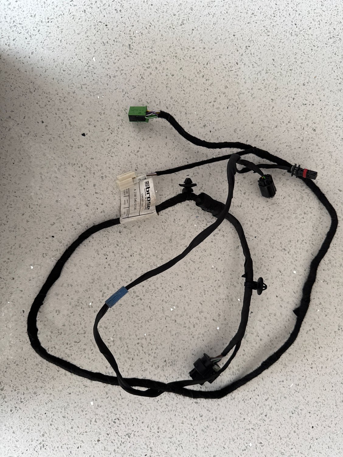

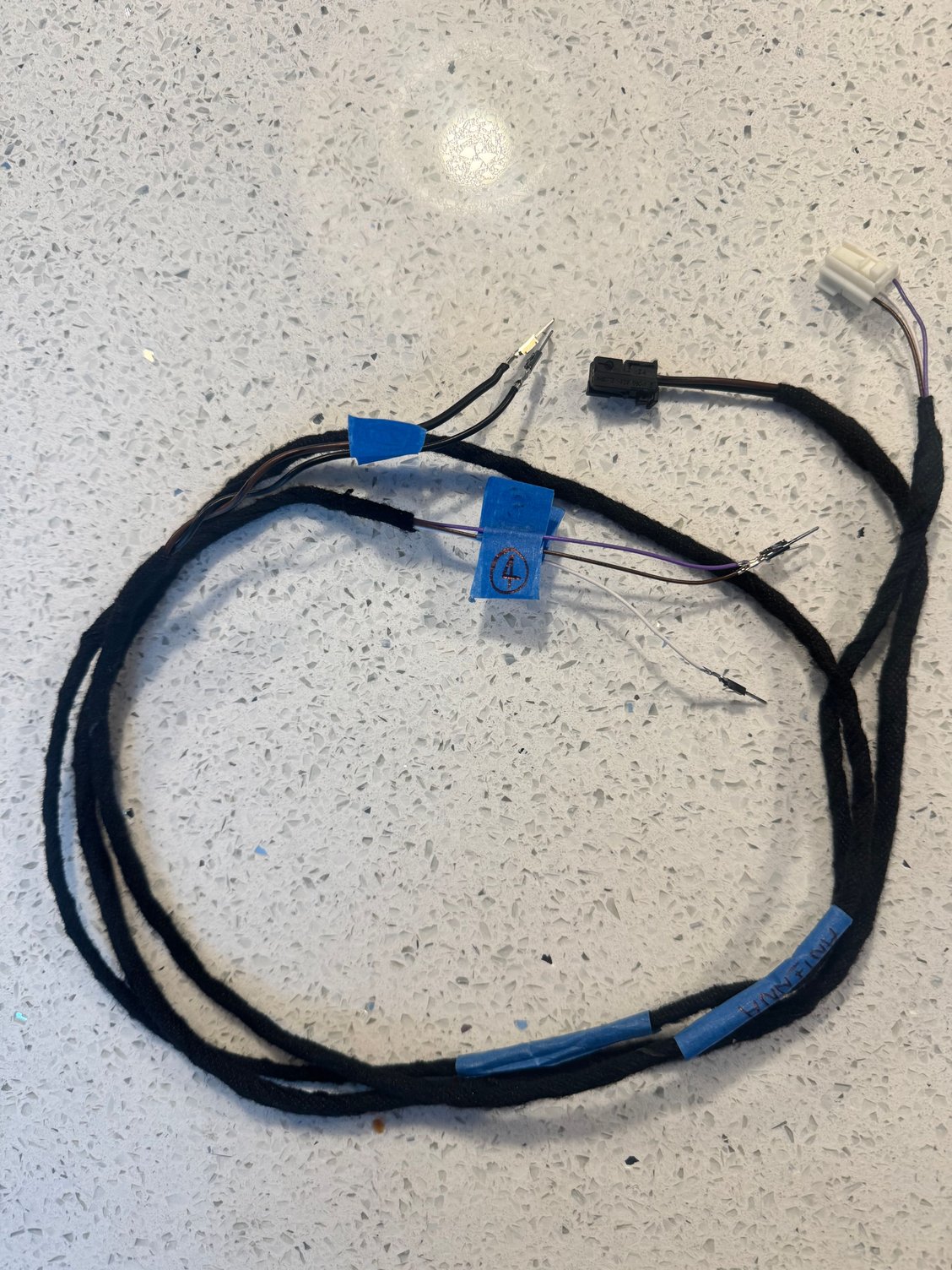

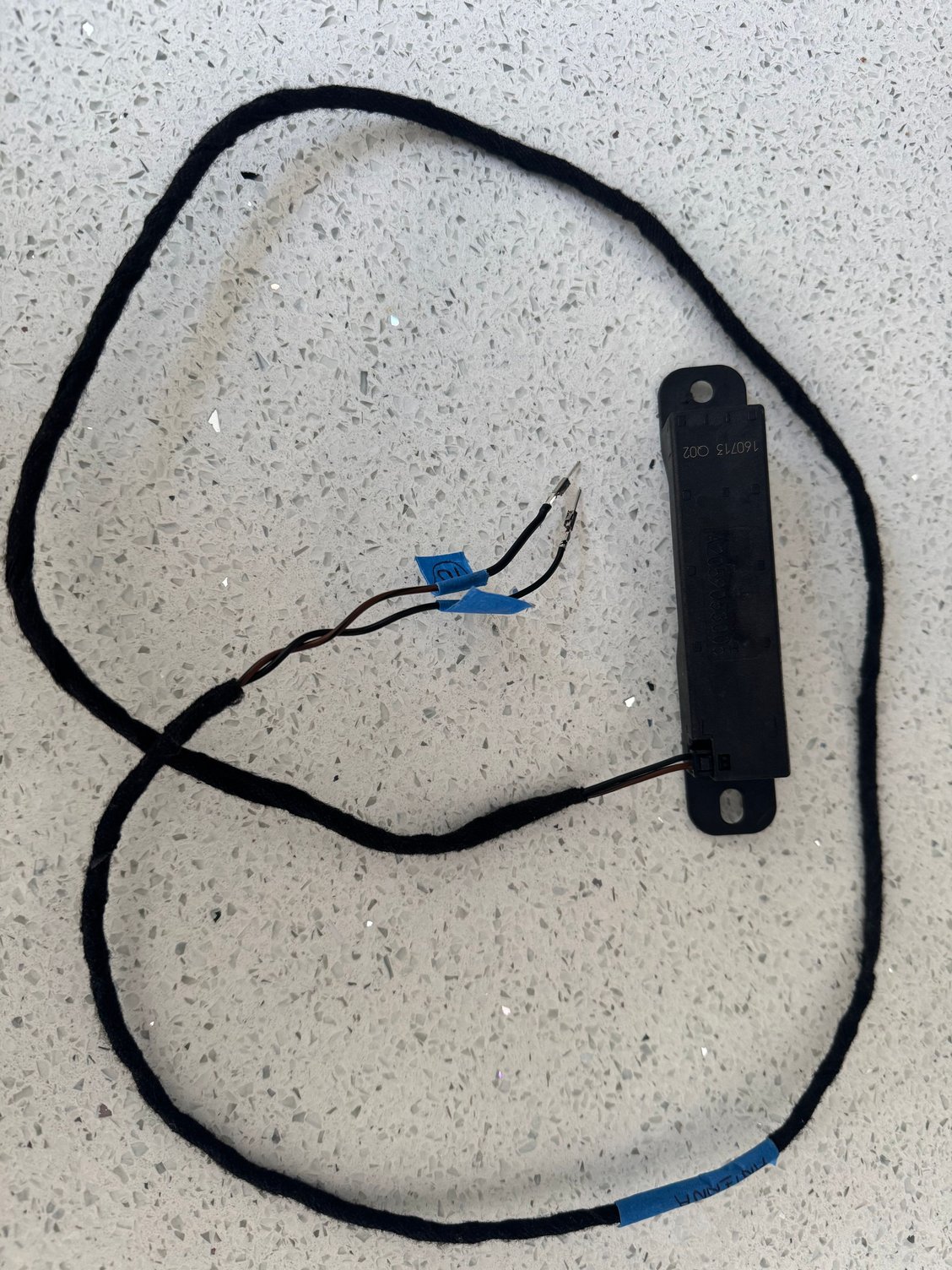

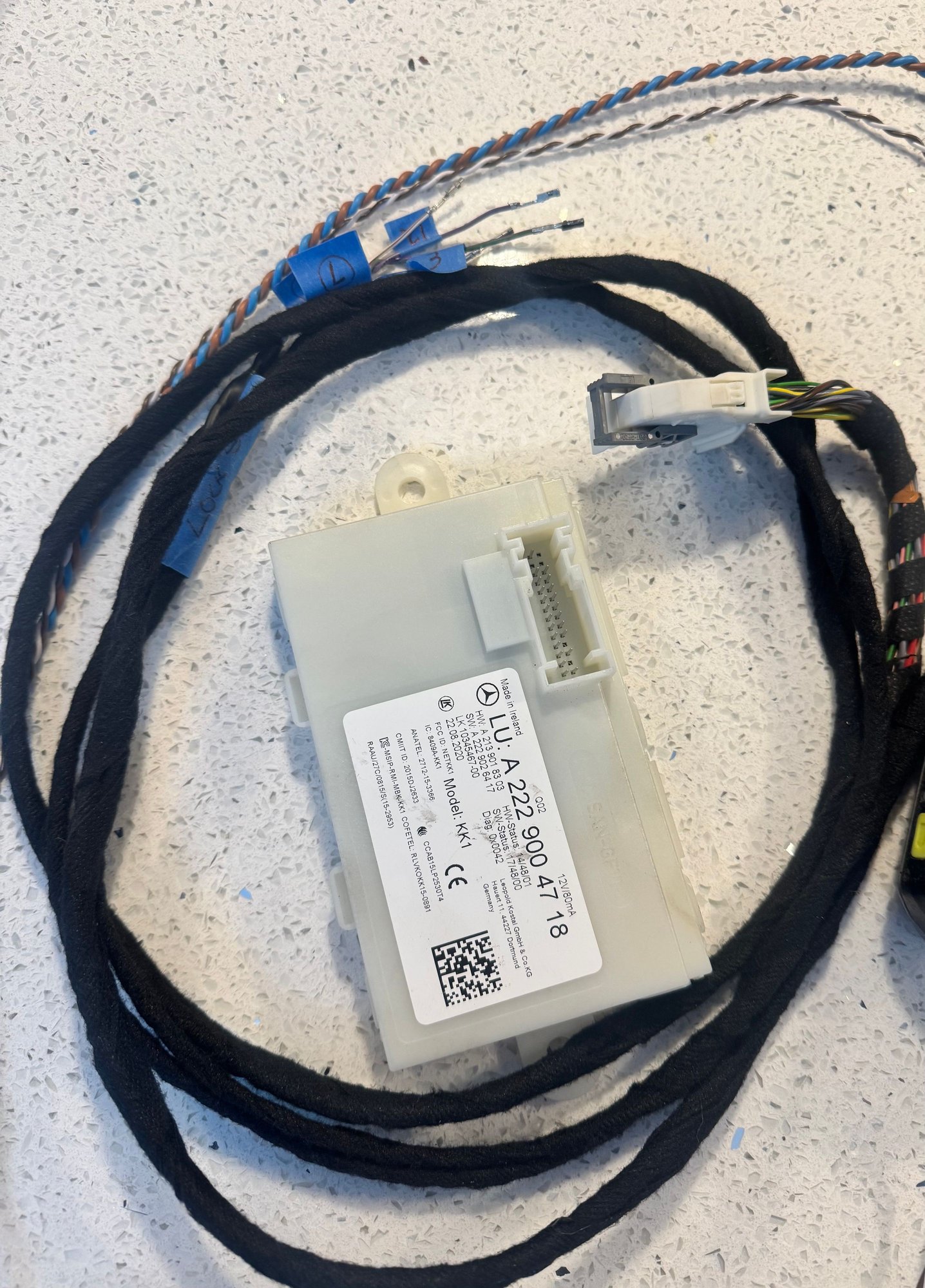

Today more parts arrived so made up my keyless go loom
Old Aug 23, 2025 | 11:55 AM
mollie's Avatar
Joined: Oct 2024
Posts: 38
Likes: 8

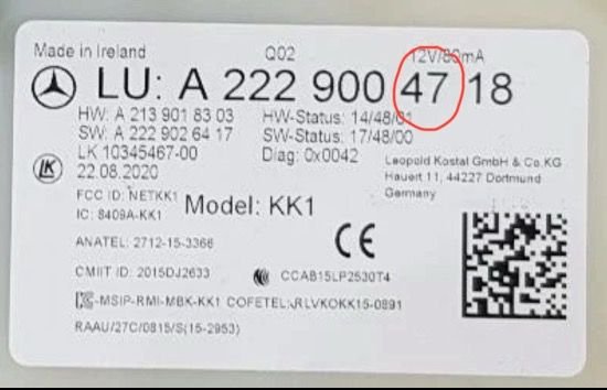

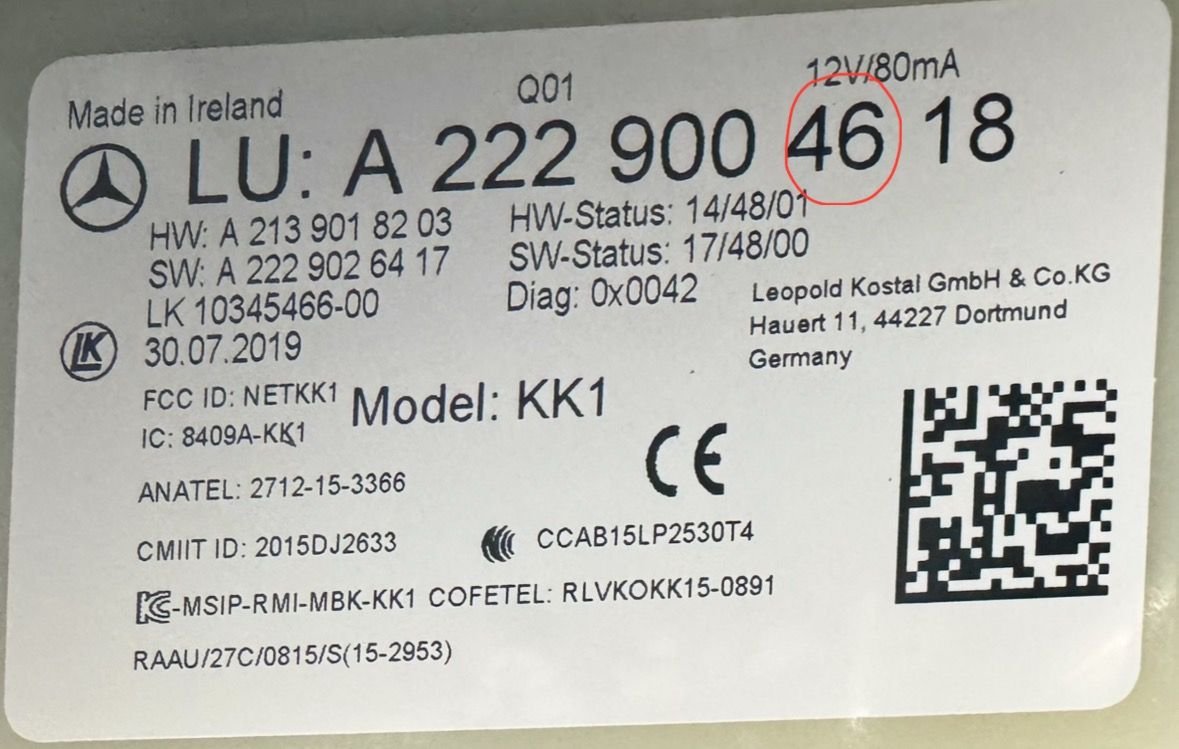

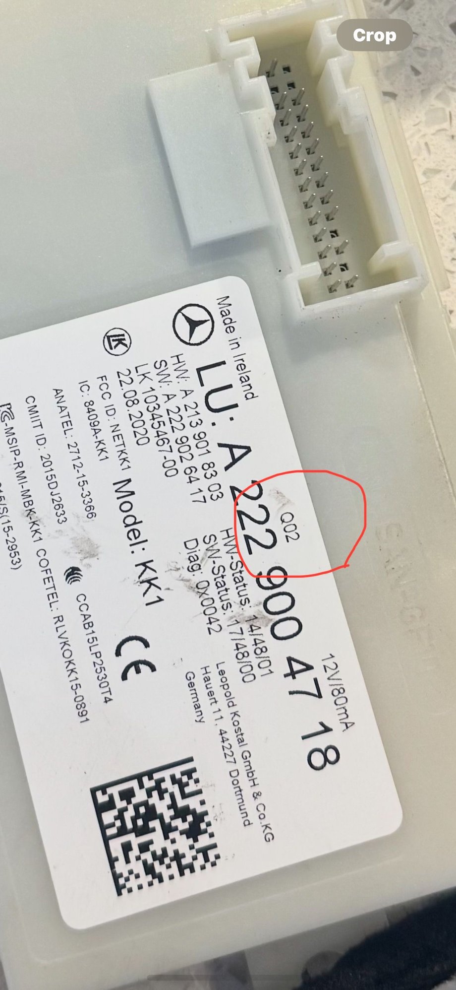

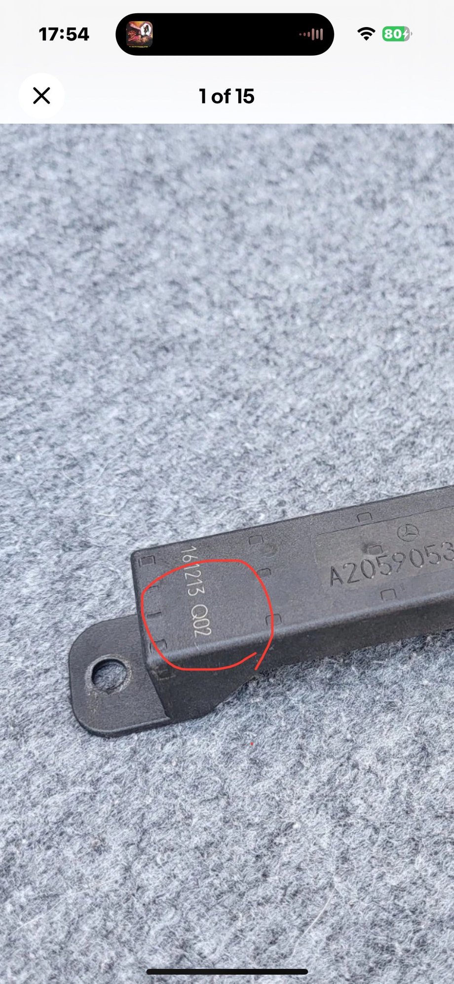

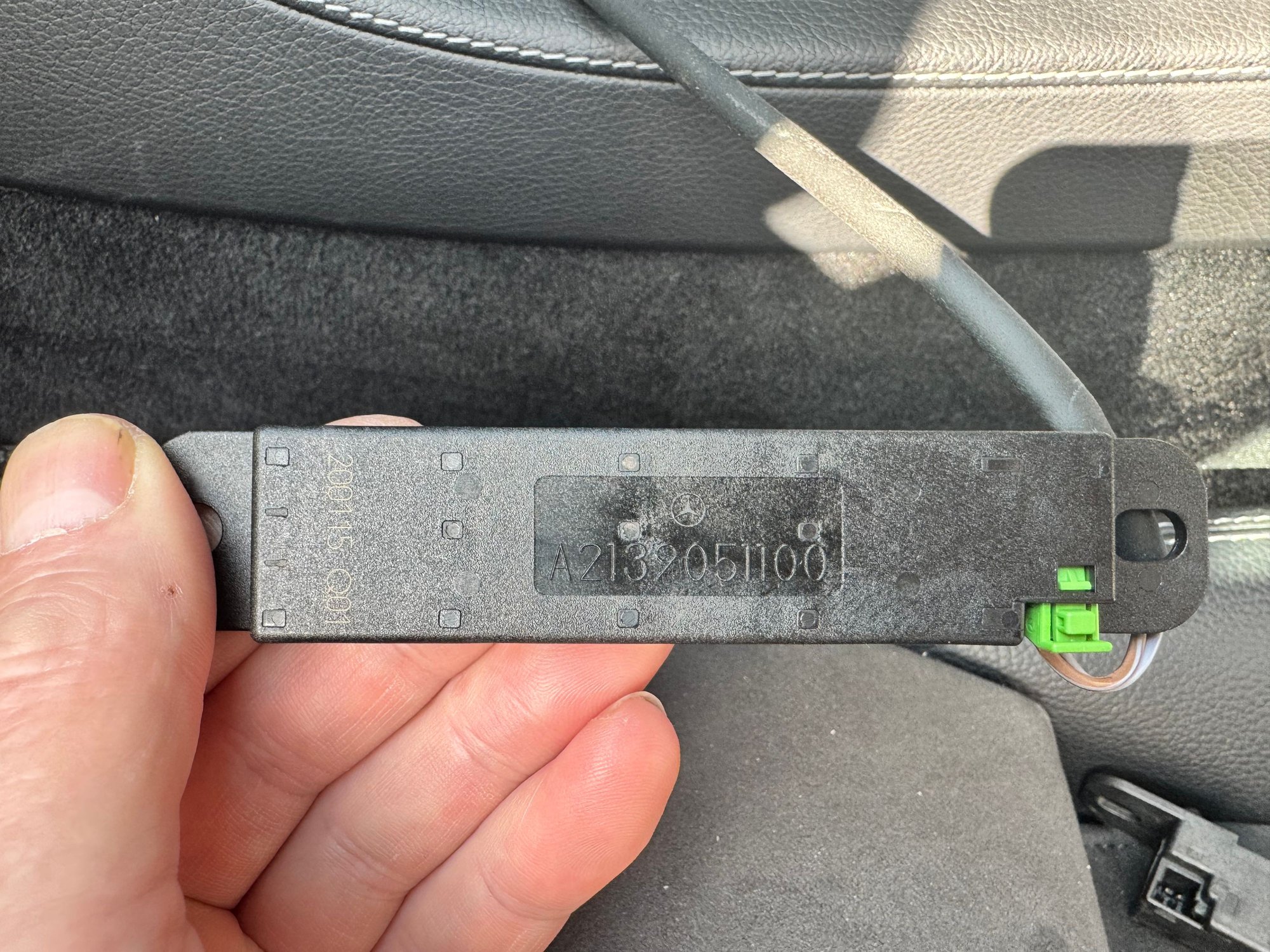

Not sure if i’m overthinking this but the kgm has a Q number
wondering if the antennas have to mach as i’ve seen Q1 Q2 Q3
Old Aug 24, 2025 | 02:34 PM
mollie's Avatar
Joined: Oct 2024
Posts: 38
Likes: 8
so now even more unsure my original KGM has Q1 that doesn’t support keyless entry the new one that does has Q2
My front centre console antenna already fitted has Q1 but boot/trunk has Q3
They all have same part number A2059053005 but is Q part relevant ?

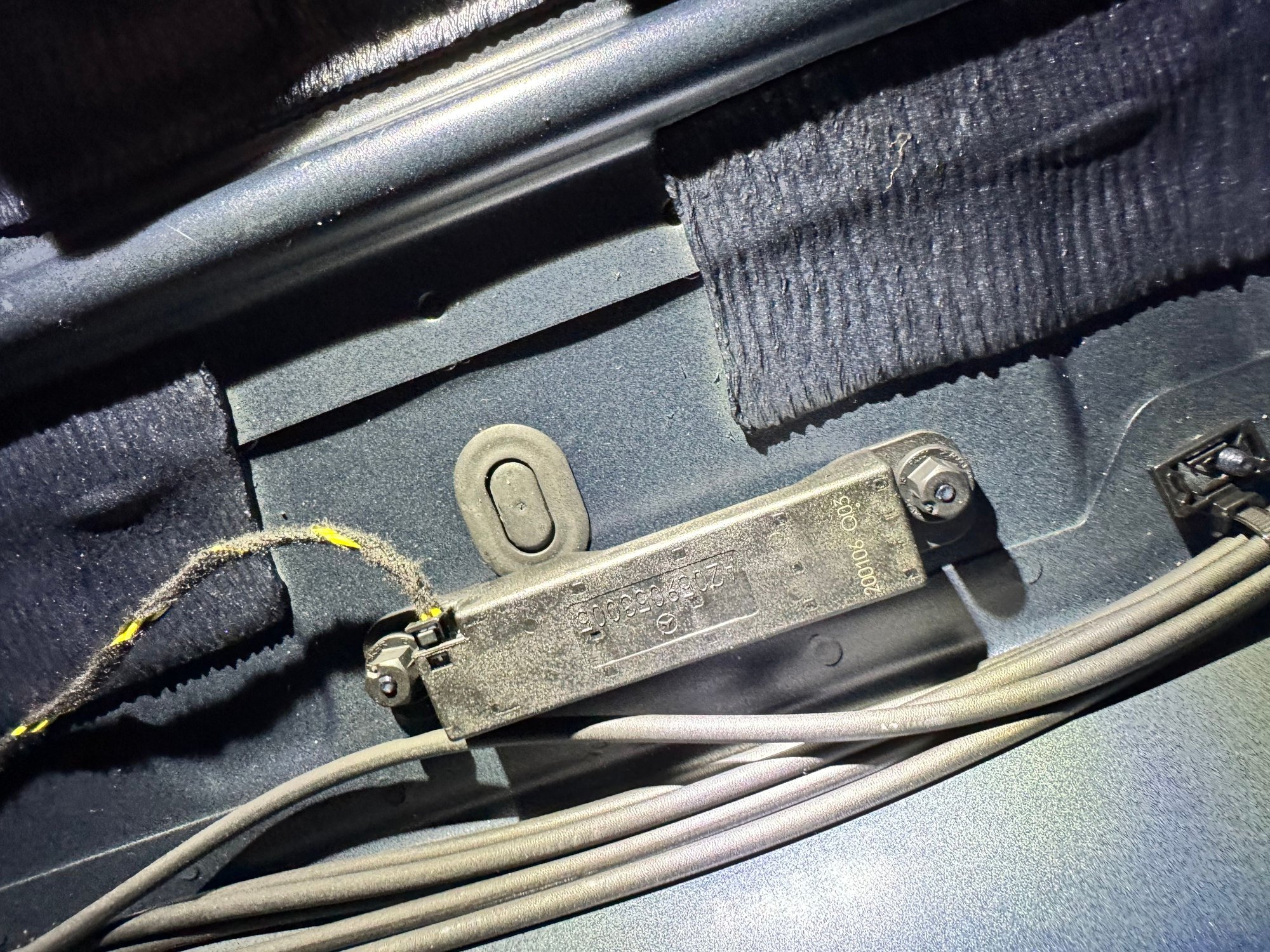

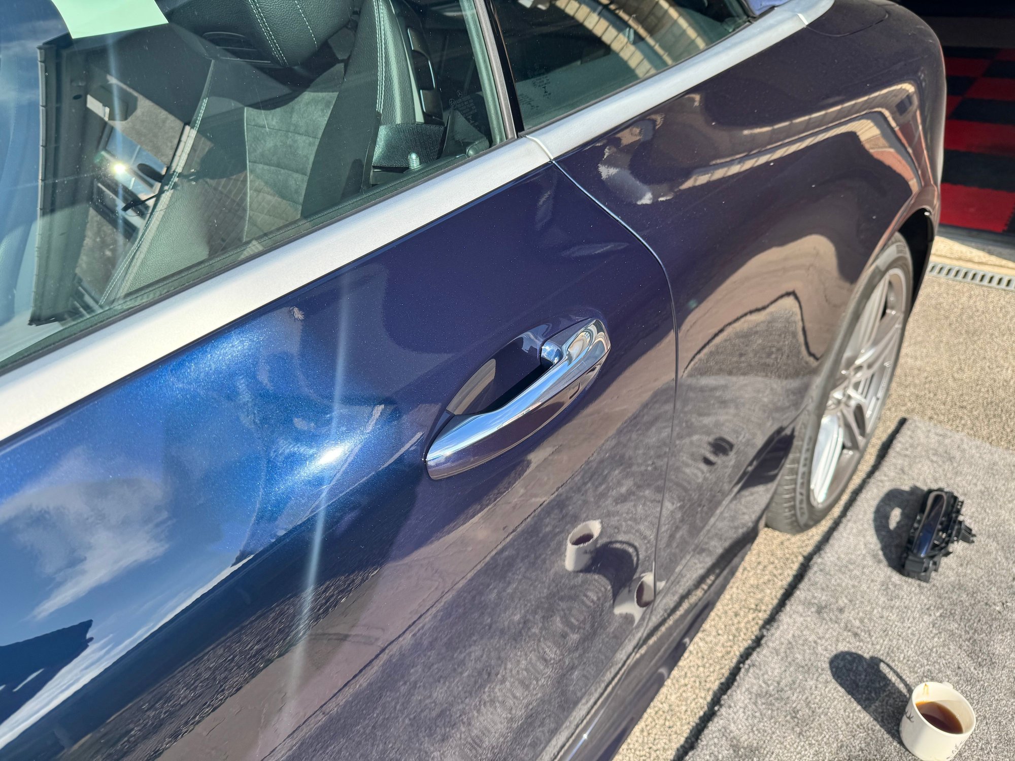

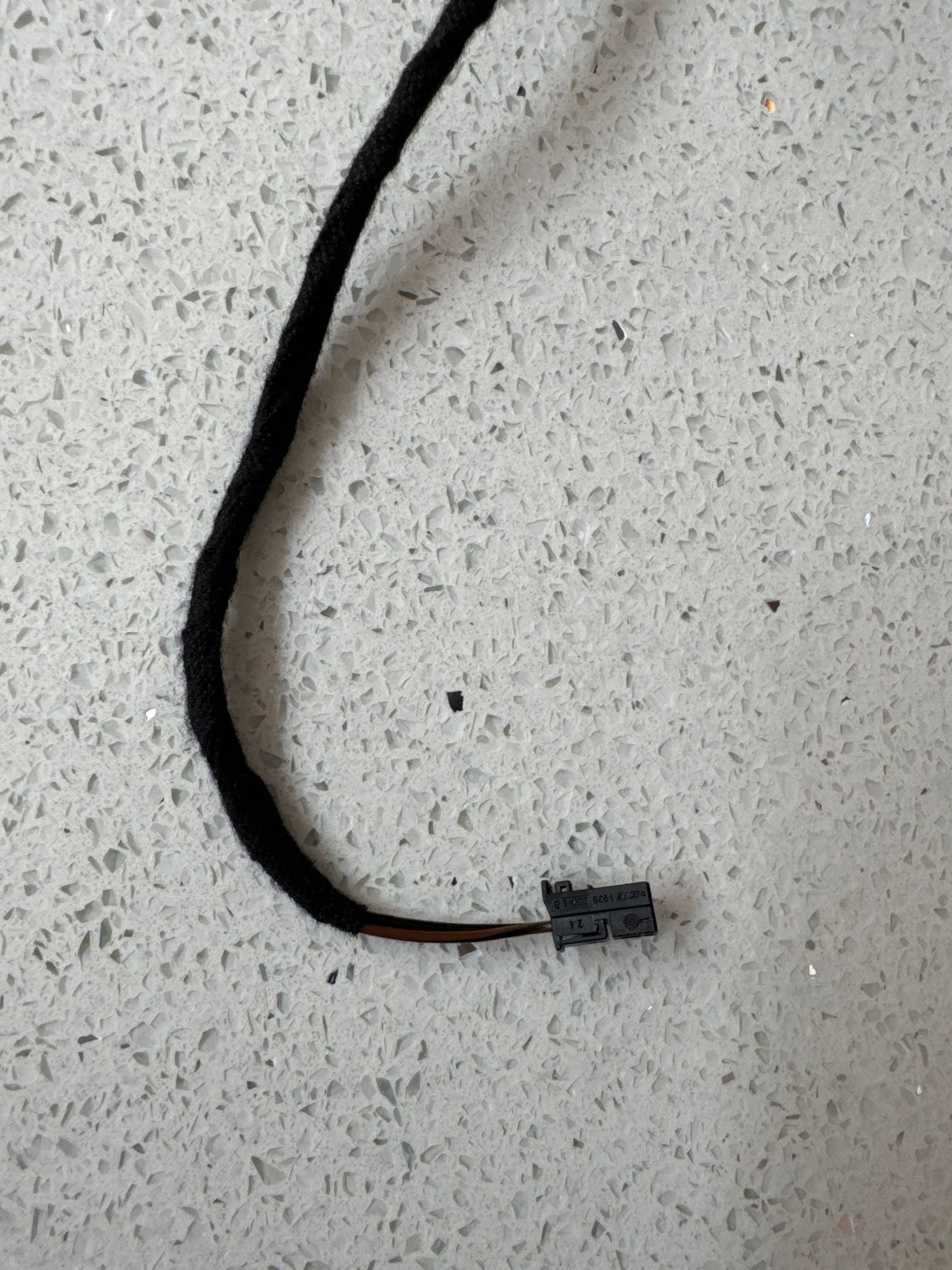

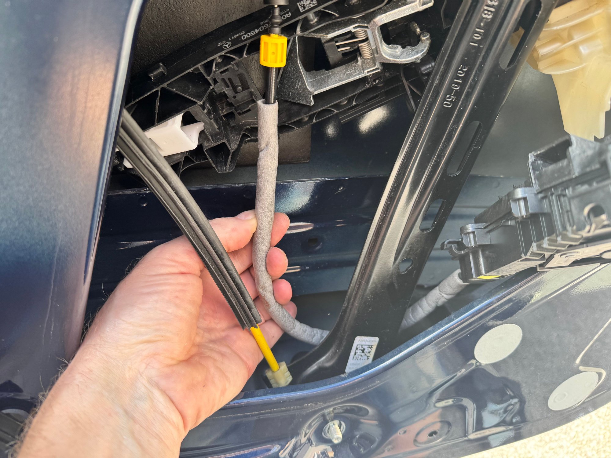

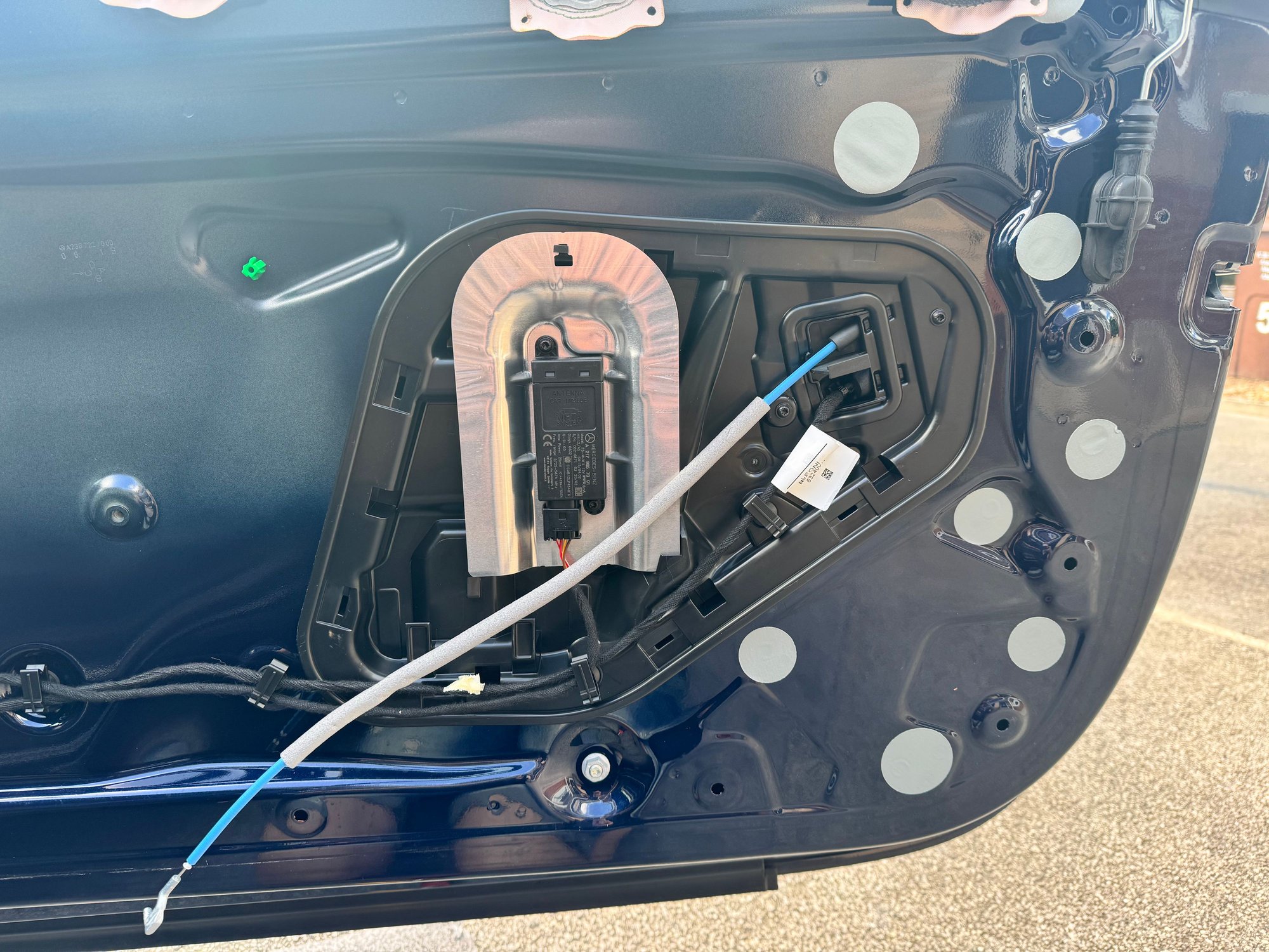

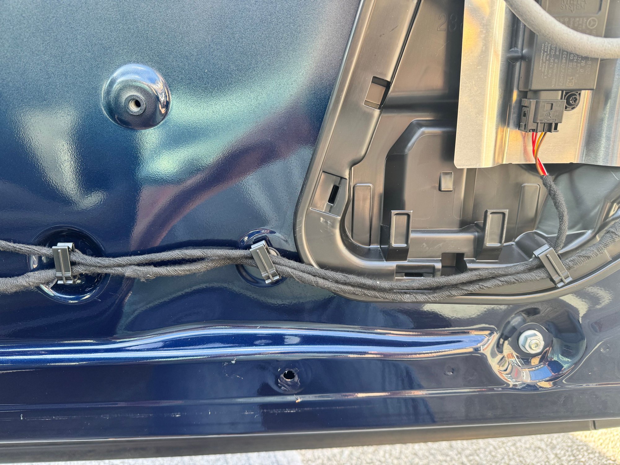

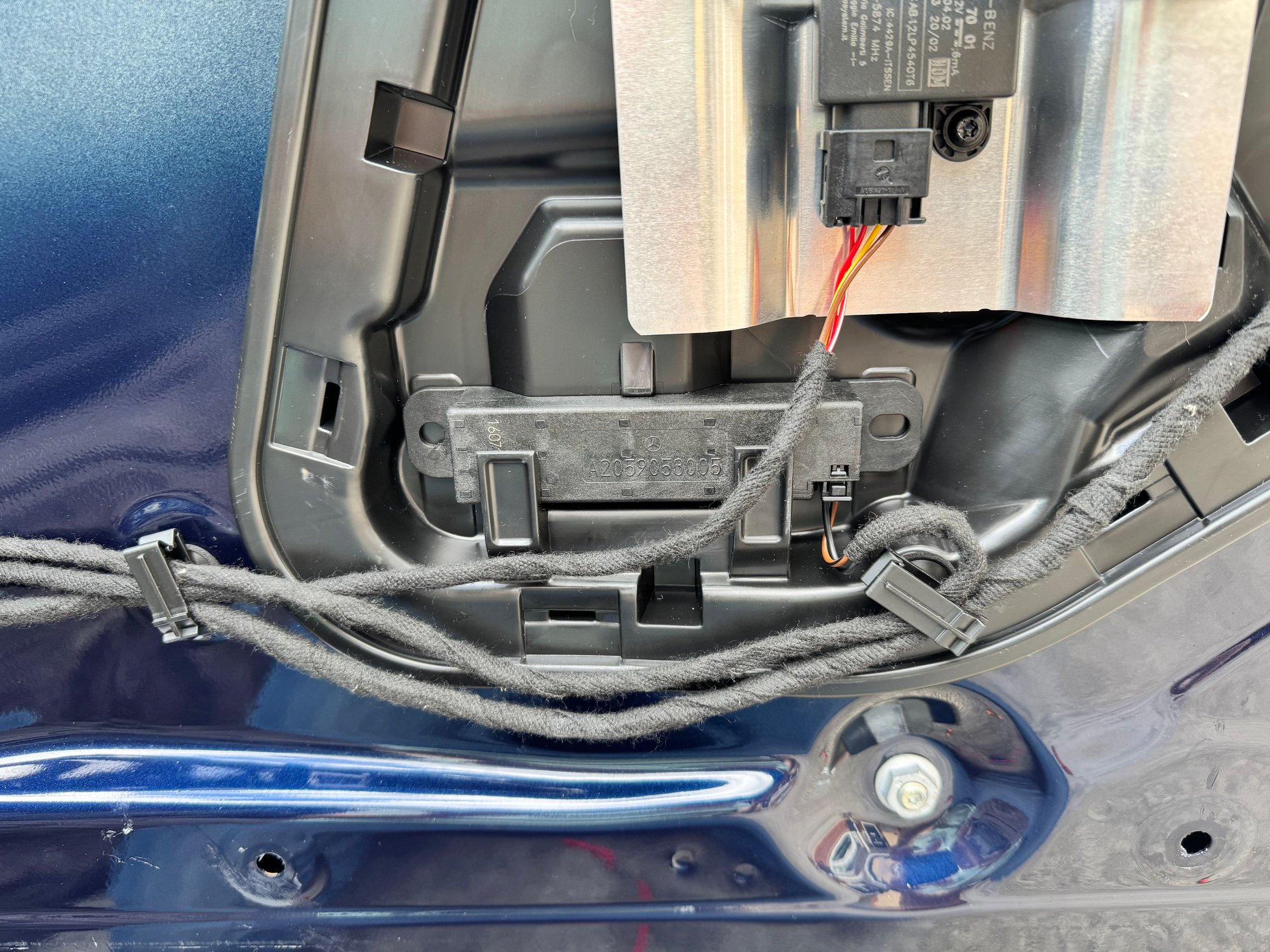

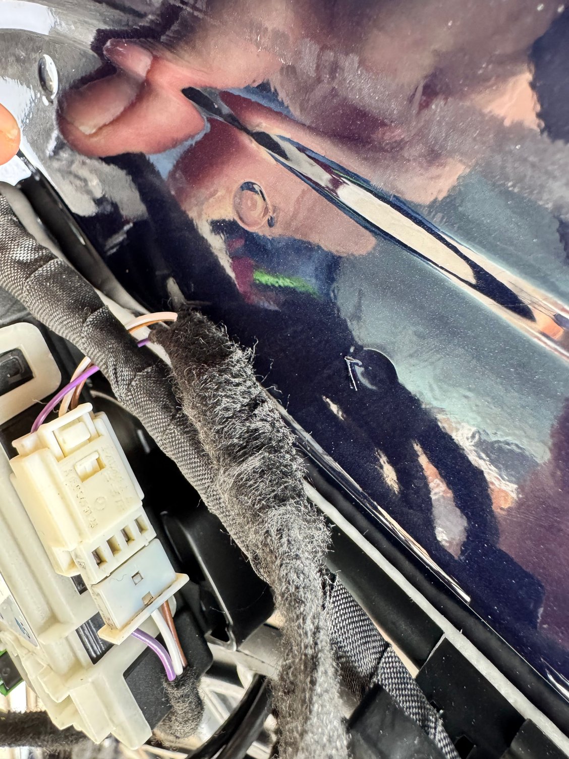

Done a bit more of the wiring today, had a look at the centre console antenna.
Different part number and connector to doors/ rear.
So decided to get all the wiring in drivers door connected and run the loom to KGM
Before
After (Antenna wiring)
Before
After (lock signal)
Door connector

So today i finished off the install, all wired up and tested, did a quick obd scan, just showed one fault within KG module, thinking this could be because it’s not coded to my car 🤞
And as i’ve had half the car apart, interior was very messy so given her an Ocd clean 🤣
Old Sep 6, 2025 | 12:19 PM
trigital's Avatar
Joined: Dec 2011
Posts: 1,692
Likes: 488
W213 All-terrain
A2229004618 is the exchanged module or the original one?
