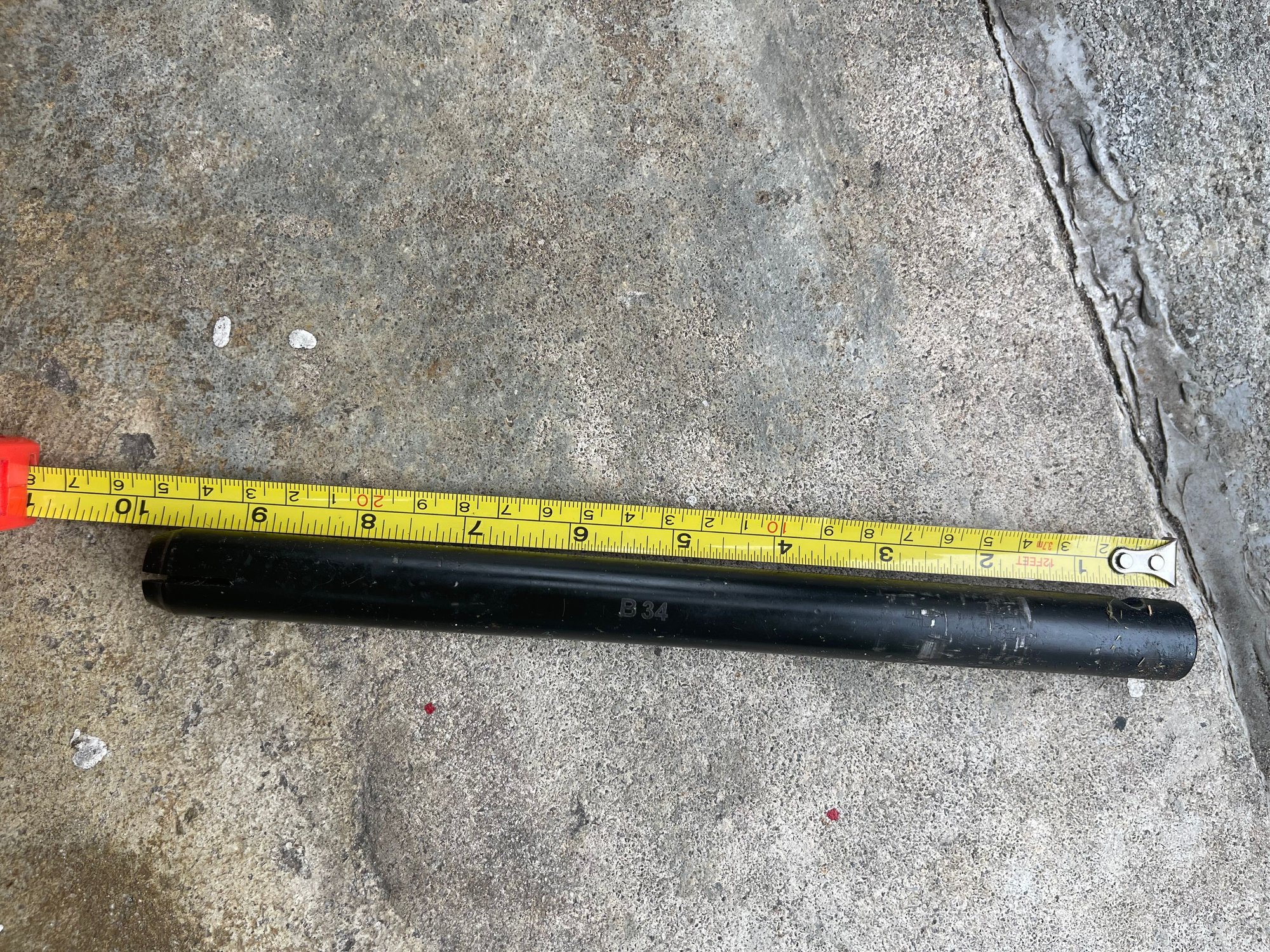

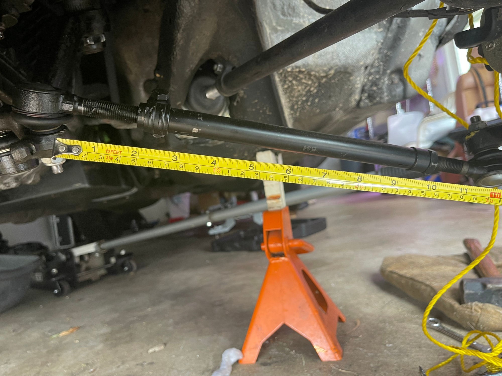

Tie rod assembly center mounting point measurements
Overall length of drivers sire tie rod assembly is 15”.
15” center to center. If I removed to old tie rod assemblies and replaced them with new ones, where the difference in the center points come from.

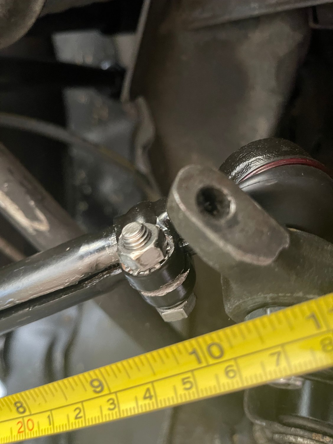

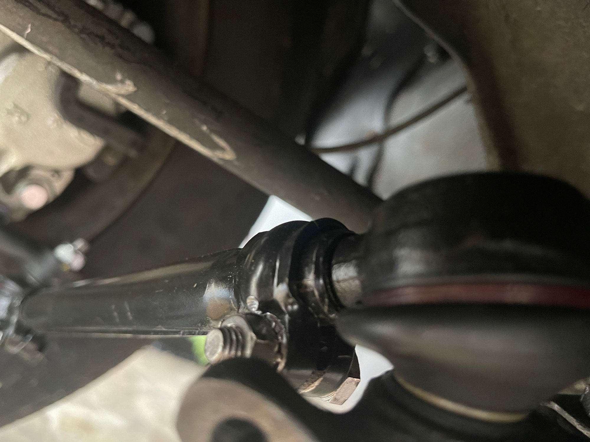

Coupling threaded over entire shank of tie rod, almost maxed out for adjustment

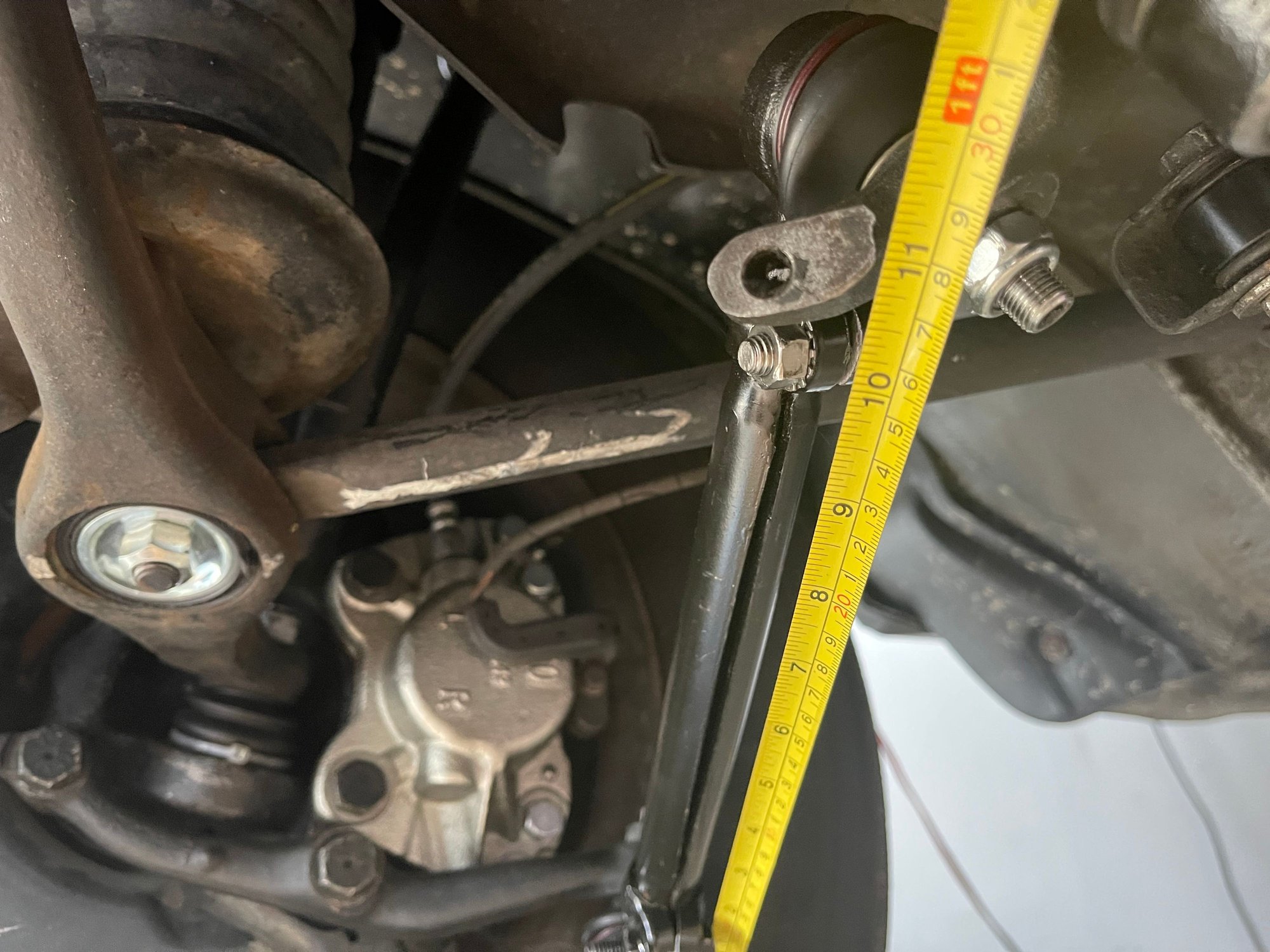

Yet it’s 10 1/2” on passenger side tie rod assembly with not much more room for further adjustment

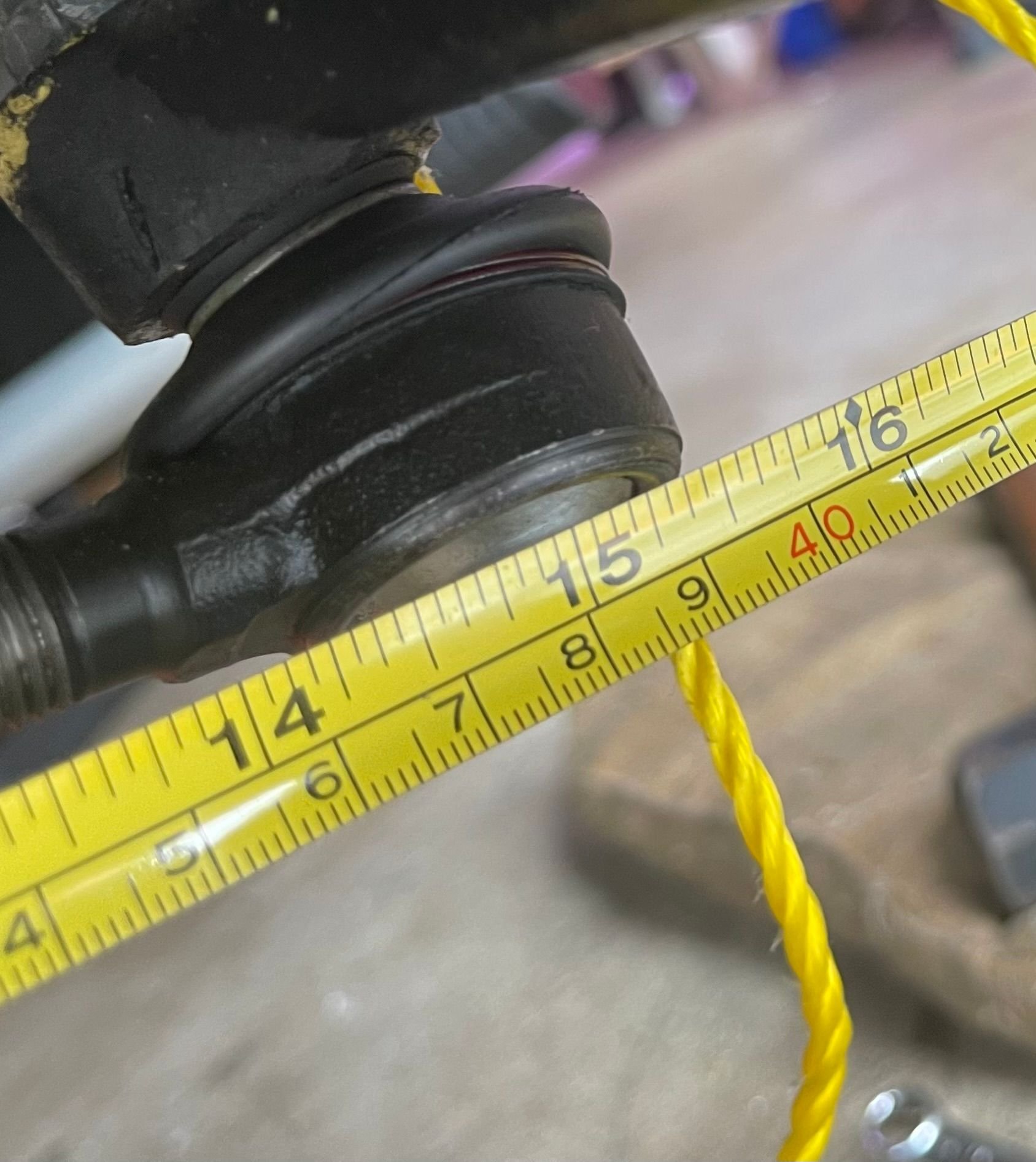

Tie rod coupling on drivers side has seemingly to many threads exposed

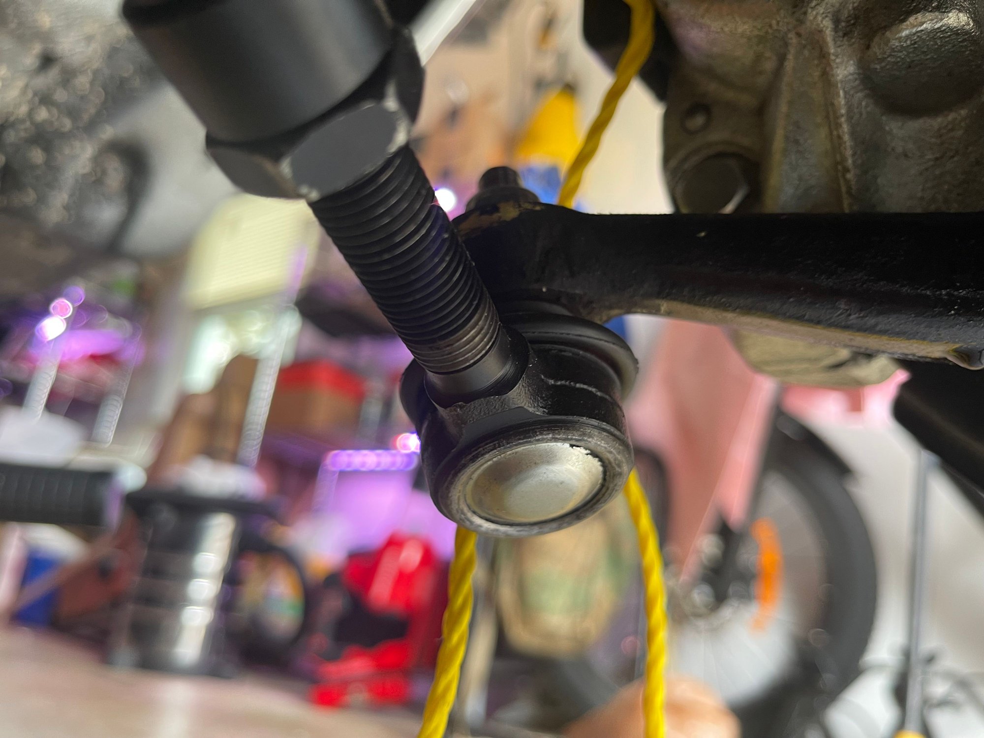

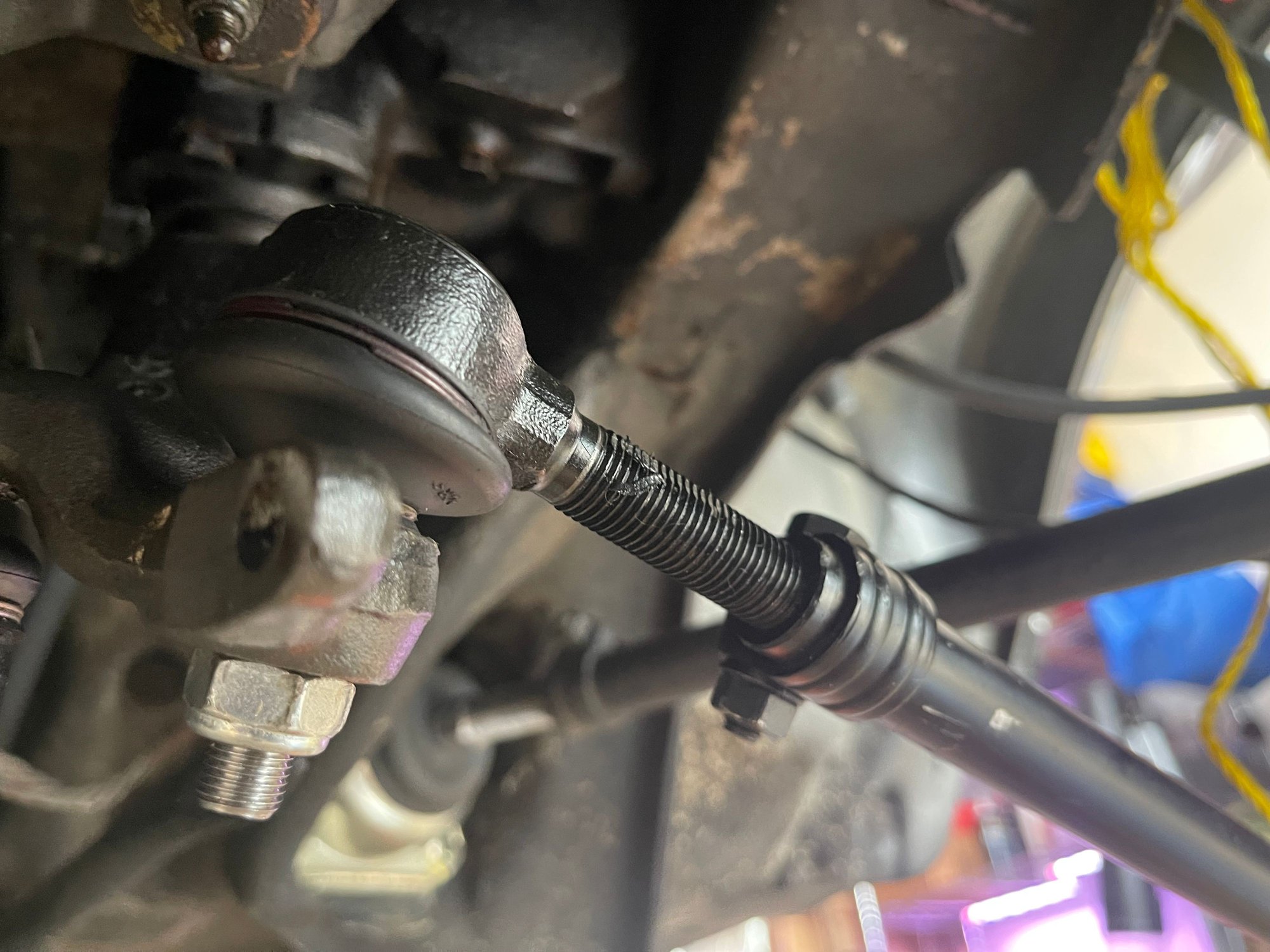

Outer tie rod end on driver side, again…multiple threads exposed slowing full adjustment to toe
Due to the differences in the center distances between the installed tie rod assemblies I had to ditch the 9 3/4” coupling for a Moog 9” coupling because the extra 3/4” maxed out the adjustment not allowing me to set passenger side toe. And these were OEM replacement assemblies. Puzzled.
