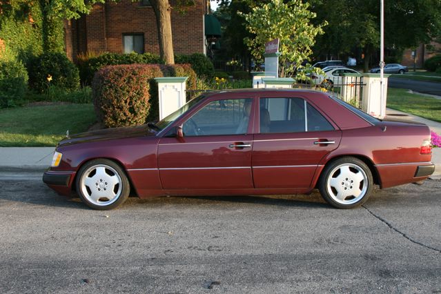

Here is a pic of the car lowered. as you can see, the front is too low. The pin stripe is going soon but unfortunately, it's been painted on!

i also say you switch the front #2 pad to the rear b/c the rear looks a little high. Since you rolled the fenders and what not, rubbing shouldn't be an issue.

I'll change the front first and see if it levels out. If not, then I will lower the rear. I have a #3 in the rear if I remember correctly.
