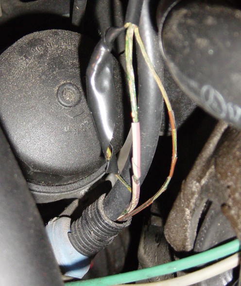

You'll be able to tell if the harness was done or not. Just find a chunk of it where the wires are not wrapped together and see if the insulation is falling off or not.
Falling off in sad, crumbly pieces = bad harness
Not falling off in sad, crumbly pieces = good harness
Really, if it hasn't been replaced, it will be obvious. This is what it looks like when it's gone bad:

I've heard of that harness costing $1k from the dealer and anywhere from $500-$1000 elsewhere. I've also heard of people rewiring their own harness using their old connectors at a cost of $50. The job itself is VERY easy, well - simple at least.

And don't forget the lower harness - it has the wires for the starter, oil pressure sender, and oil level (?) sender. That's what I was showing in the pic I posted. The good news is, the lower harness cost me a whopping $185 (including labor) to have it fixed.
yea, thats the one I told you I found brand spanking new at the junk yard for 20 bux.
