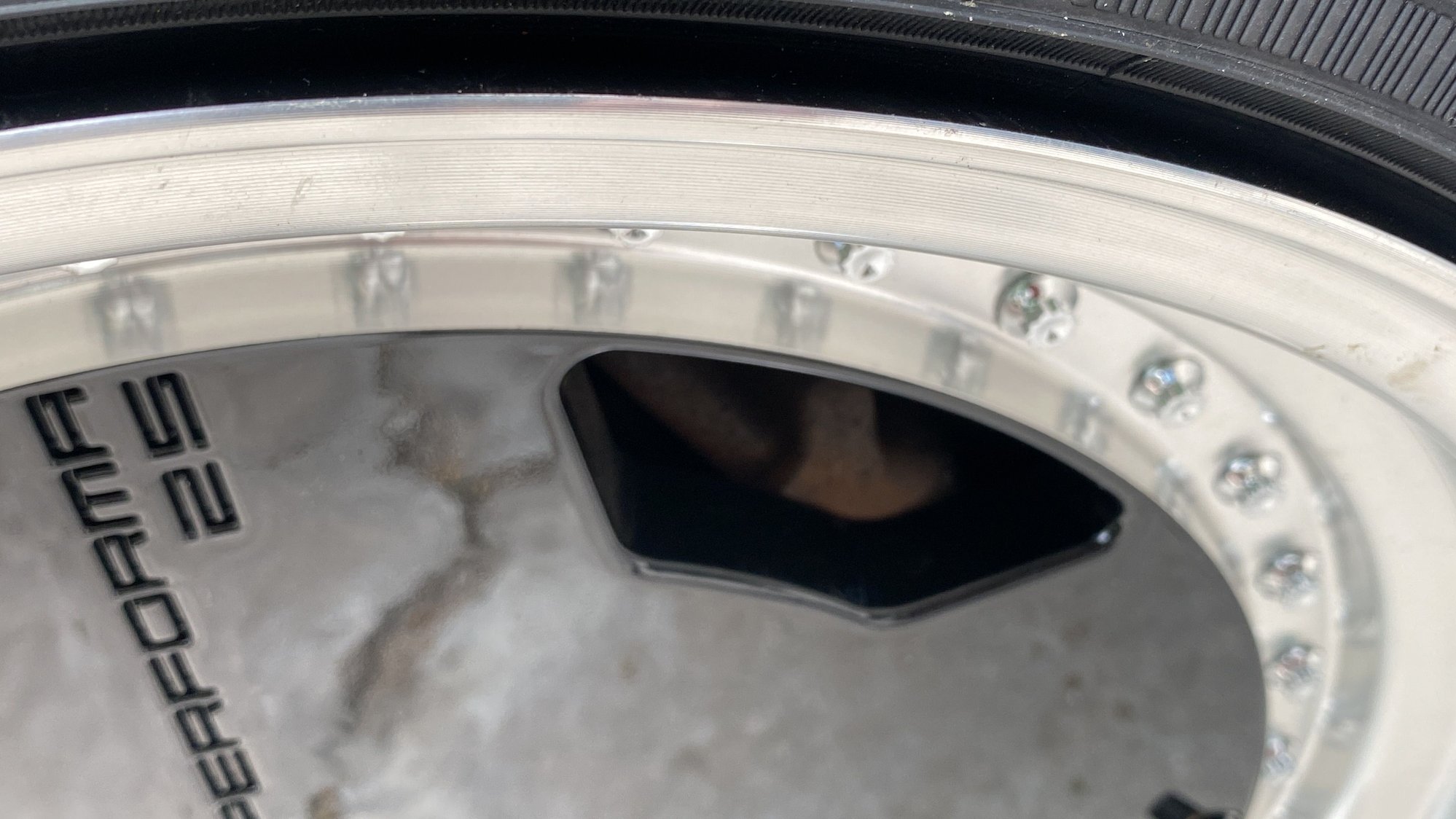

Hello,
I recently bought a square set of wheels (17x8 et 25) for my 90' C124. Unfortunately, I didn't realize that in 1990, the C124's got the larger brakes... (I had originally thought they got the larger brakes with the other models in 1993). I had already planned on rolling the fenders & lowering the car. That being said, these new wheels don't clear the larger calipers and I'm wondering if anyone else has had a similar issue. Do you guys think 5mm spacers front & rear would work? Also, I was able to bolt the wheels fully onto each hub. Does anyone know a good company for extended wheel bolts as well? Thank you for listening!
