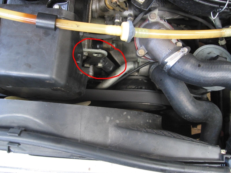

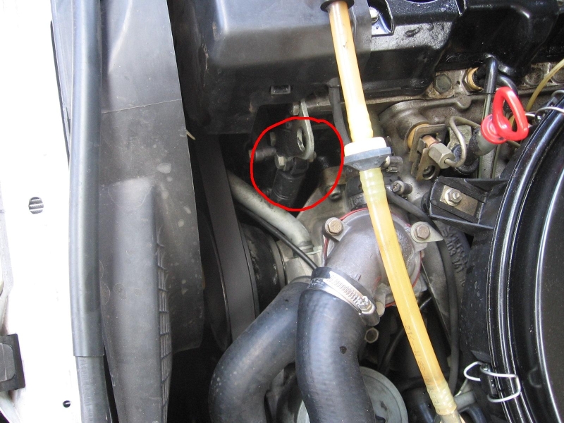

Ok i have this annoying rattle on my Merc When i put it into Drive you can always here this loud rattling when accelerating it goes away or when its in park. Its so loud when i stop at lights i can here it inside the car even when i have the radio going
Ive found the part thats rattling when i put pressure on it the rattling stops, i just need to know how to fix it?

i have a different engine and it's dark so i can't see properly if i have the some thing on my car, but from your pic it looks like there's a bolt there, maybe try to tighten it?

Yeah i tried to tighten the bolt but not luck she still rattles, Would you have any idea why it only does it in drive and not park???

yeap I had that one too, its a biach to replace but I still did it after 4 days rattling came back so pist that I just quit. It rattles because the bushing wears out pretty quick. I remember when I replace it took it out and for like 2 days never drove with it nothing happened but I put it back just in case.

maybe take out the bolt, and put a small rubber washer on the bolt and tighten it back up?

Sounds like a good idea ill give that a try, ill do it tomorrow ill pick up some rubber washers while im out

I had the same issue, I cut a 1/4" washer out of wood and put it on the bolt and tightened it up just enough. The rattling never has come back since and its deff been over 1k miles. Its called the engine shock damper if i remember correctly, I picked one up off of ebay for 25 bux shipped but after I saw how much of a ***** it would be to R&R I began the procrastination

Have you tried adjusting it? Looks like there's a tension adjustment.

Wood may work but wouldn't be my first choice. Adding rubber washers sounds like the deal. If disassembly presents a challenge you could cut the washers and slip over and tighten.
A blob of clear silicone may do the magic after cleaning the bugger with some brake cleaner. Ahhh, fast and dirty ... my favorite.

The part you've pointed out in the picture is a Belt-tensioner/damper. I would not mess with it and get it replaced and/or your belt checked out as well. It's a sensitive part on W124's and I had it replaced twice on my W124's...

Finally Got Around to Fixing the Rattle on my Benz :P
Rubber O-rings work a treat haha

well if its ratteling than its DONE... my brother just replaced his. you cant take it out and clean it or any thing its a replacement thing. i remember when his was doing that... it was annying as fuc.k ... but just get one on ebay and replace it...
