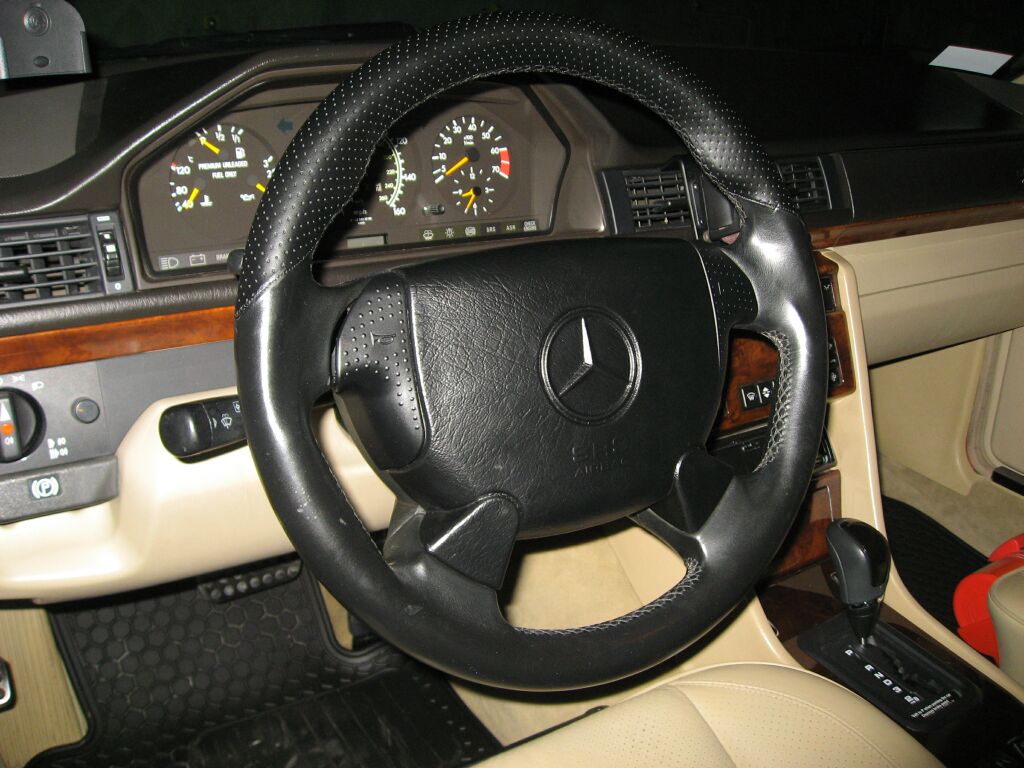

Here is the E55 wheel on my 500e.

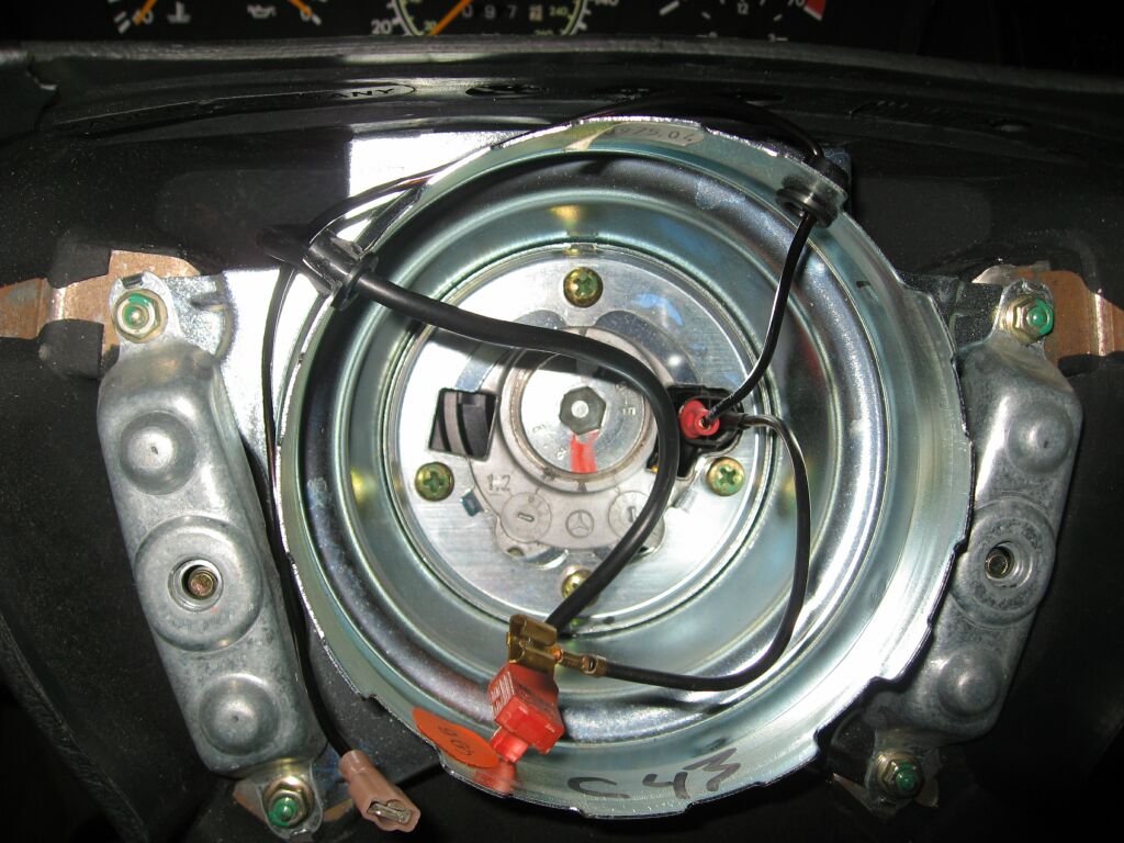

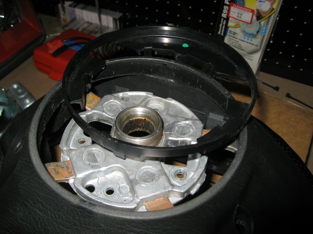

If you have a 90, you can still use a wheel like this, but you would need to first locate a clock spring from a 92-99 regular steering wheel. Most wheels that you buy won't come with a clock spring and the E55/C43 wheel does not use a clock spring like the earlier model cars, look at the pictures and you will see what I mean.
This is the proper clock spring from a 92-99, four bolts hold it on
This is the back of the E55 wheel, notice no clock spring, but there is a plastic ring that needs to be removed before you can install the clock spring.
You will also need to do a bit of wiring to the clock spring, as the stock wires are not long enough to reach the outter horn buttons on the airbag
