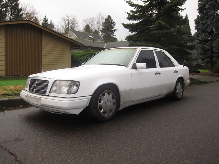

It's kind of a basket case, there is no exhaust and some one put a 'cold' air intake on. I think the springs are cut. Here are some more pics for you guys.
