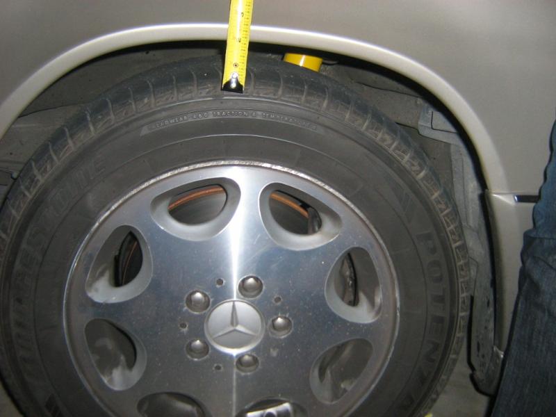

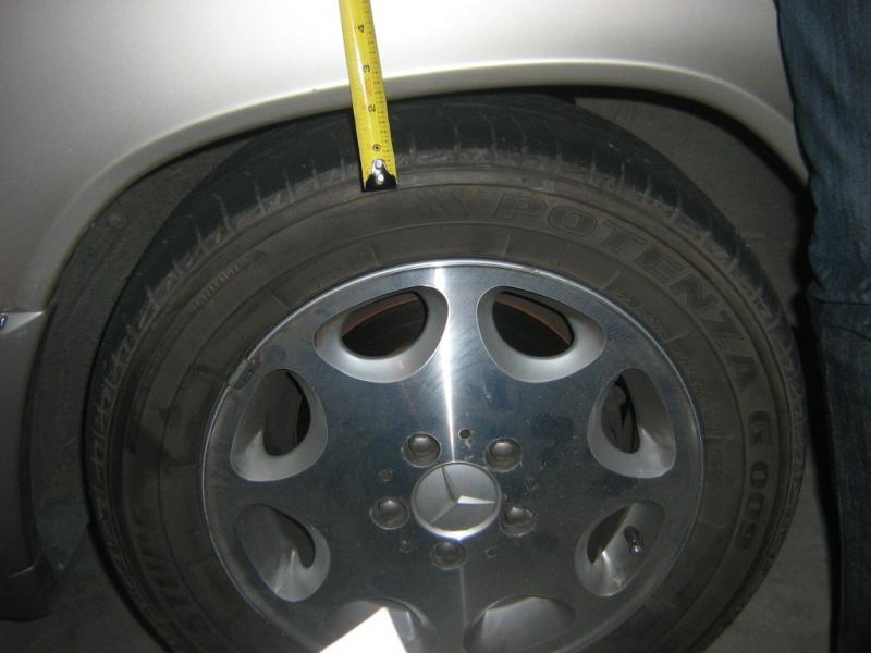

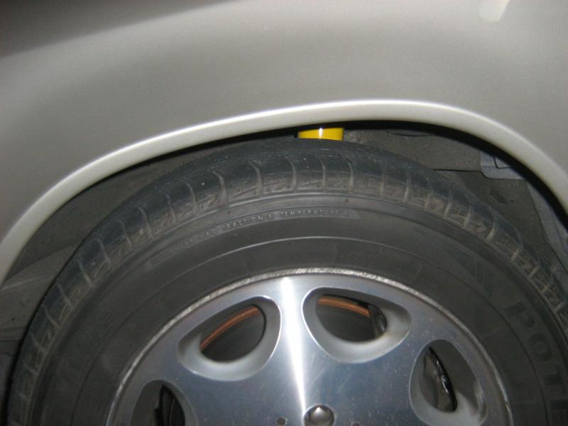

So i have read 100 different posts and i am only abit confused. I may be making this hard but this is what I am trying to do and I cant be the only one LOL
Goal:
Put a 16-17 inch MBZ original wheel with a normal tire(not low profile) for the a good ride. the car has been lowered about 1.5 inches using HR sport springs and Bilstien sport shocks the front and Bilstiens in the back.
It looks like I have plenty of room but I would rather not roll fenders. the look I am going for is more factory than not with a more sporty wheel.
Frankly from all the posts I have read it feels like I have have several choices but It get tough to figure out when the car has been lowered and trying to filter through what everyone is saying. Also i dont trust any of the local wheel shops to know what they are doing with this car...all they want is o sell me new wheels and tires and get me out the door
I know there have been lots of posts on this and I have had several... I have provided some pictures of the current spacing and my old wore out wheels and tires LOL I did read Zeda's post and i do like the wheels, but they are hard to find and to big for what I am trying to do ... and I also read the definitive wheel fitment guide for w124 pdf but that was confusing as I was not sure how it related to a car that was lowered, here is the list for this car(w124) I am wondering how I decide based on the car being lowered... I am thinking at this point only the bold 16s at this point ... and one more ting.. then the spacers come into play that allow yet again another options, I may not need a direct fit just a wheel/tire that matches the spec where at spacer can be used...

As with all standard W124's, to avoid rubbing issues stick to a (maximum) of 17x7.5" with a +30-37mm offset. You can go a tad wider in the rear (17x8"). This of course assumes you want to correct your camber/toe for maximum ride quality and tire wear.
Much false information comes from people who run extremely wide wheels with stretched tires and run excessive (dangerous) negative camber. These types propagate the myth of "I run these and they don't rub", which may be true but the damage to their tires and suspension is not factored in.
