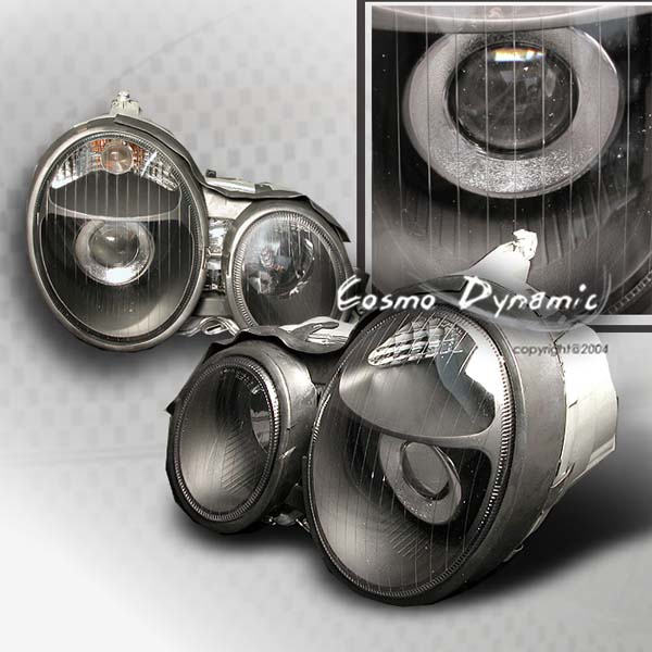

w210 projector style/retrofit project
well since the car's being worked on at the shop i am buying a set of projectors that fit my years car instead of the ones that i moded to fit mine and were off by a little.......anyways here is the thing. I was thinking of doing the projector refrofit but its been so long and i've been out of the loop that i forgot how it all went....
i have my old ones to practice on i guess so i will swing by my shop to get them and try them out....
question is for you that have done this is what projectors did ya'll go with and what ballasts/bulbs as well....
from what i read the rs6 ones fit but one guy was selling ones that were 2-3/4in and i think there small but not sure.....
other then that what instructions do i need to actually do this project and last but not least i'm keeping my theme of black/white on my car but wanted to change things up by getting the black projectors.....
what do you guys think??
Attached Thumbnails w210 projector style/retrofit project-1136621375944_lhp_bw21096jm_ksc.jpg

I saw the black out one, somehow they don't look as nice as the chrome one, but that's personal choise. If you can find a shop that let you try out different version of light in your car, that would be best.
For projector, anything would fit. However, if you go with either the E55 or RS6 bi-xenon, that would require least amount of work, since they are similar size with the projector that Depo use in the headlight. Not to mention that the shroud would fit in nicely.
I have the Lexus LS430 (2 1/2") for my headlight, took me forever to fabricate the housing/mount the the projector and shroud. If possible, you want to use the existing mount & housing of the Depo headlight, unless the projector is really superior, or you just want to try out the challenge. The housing & mount have to be really really rigid, to handle all the vibration & shock during the car moving, at the same time allow the ability to be adjusted. That's why going with the E55/RS6 and re-use the existing Depo housing/mount helps.
For the ballast, from what I've seen, ones like Denso (from Lexus), Mitsubishi (from Acura TL) won't trigger lamp failure when you turn on the light. I think the Hella Gen-3 also won't trigger light message. It's PITA to see lamp msg, and lot of ballast out there trigger the error warning, though they all work in turning on the xenon light.
If you want best light, go with Philips/Osram D2S 4300K, if you want nice color, go with Philips Ultinon, quite pricey thought ($250-300/pair)

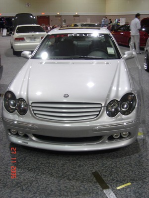

zam check your email or pm on here, i sent a link of what i wanted to buy.....
would audi A4 projectors work as well? i want to do this with the least work possible, i don't have too much time on my hands these days so i don;t want too much custom work.......i rather get the rs6 ones over the e55 just from what i read with what you said about the reviews......
as far as the headlights, i don't know of any place around here that has them in stock other then ebay unless i talk to my bodyshop and ask them to look into it for me.....
i liked what this guy did so it made me think.......
