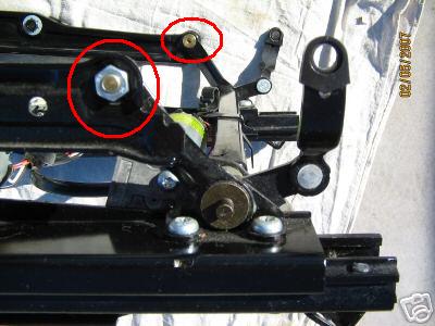

Hey fellas, Is this it??
I came upon some pics. Just wondering if this is the problem bolt. I replaced mine with no luck. Seems to be in the rails themselves in my case. I did tug on the rails with the seat out of the car and the popping noise was still there. So my tracks will pop with the seat out of the car, and these bolts weren't the issue. Any other ideas?
