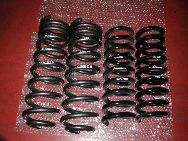

I have received contact from Ken at Lorinser USA and they DO have the lowering springs for 4Matic. However, they only have the springs, not the shocks. I asked him about a picture of the springs and if I had to modify the front suspension. Apparently, the front suspension on a Euro-spec 4Matic is different than a US-spec 4Matic; hence, the modification.
For those that aren't familiar with the springs on a 4Matic, I've attached a picture. The front is a little shorter to accomodate the front axle via a bracket. The fact still remains: no shocks for the front. Second picture attached is a set of Brabus 30mm lowering springs for 4Matic. The modification comes in when trying to keep the spring perched on that grey platform at the bottom of the spring in between the bracket and spring.
I'm a bit befuddled as to how to resolve this problem. I'll know tomorrow as to whether or not I want to drop the money on this set of springs. Will update as needed.
Right now, I'm waiting for Ken @ Lorinser USA to get back at me for some pictures of these springs from their headquarters in Germany. Once I know how they look, that will give me an idea as to whether or not I want to go forward with this ordeal. First, I'll get the springs. Second, the shocks. Lastly, the install, complete with before and after pics. I'll keep you all posted!

Latest news regarding Lorinser...
I finally got word back from Ken @ Lorinser USA, and he sent me a picture of the lowering springs. Apparently, the Brabus springs that I recently bought are for 2WD models If you'll notice, the front springs are open-coil design; the Lorinser's are closed-coil, the correct design. No biggie, so now I will have a set of Brabus 30mm lowering springs up for sale soon ($300 plus shipping). Anyone interested? Here's the picture of the Lorinsers.

From what I could observe, the closed-coil on the bottom allows for the spring to sit flush on top of the bracket. If the coils are open-ended, there would have to be a retainer fabricated to keep the springs from slipping down the bracket.
