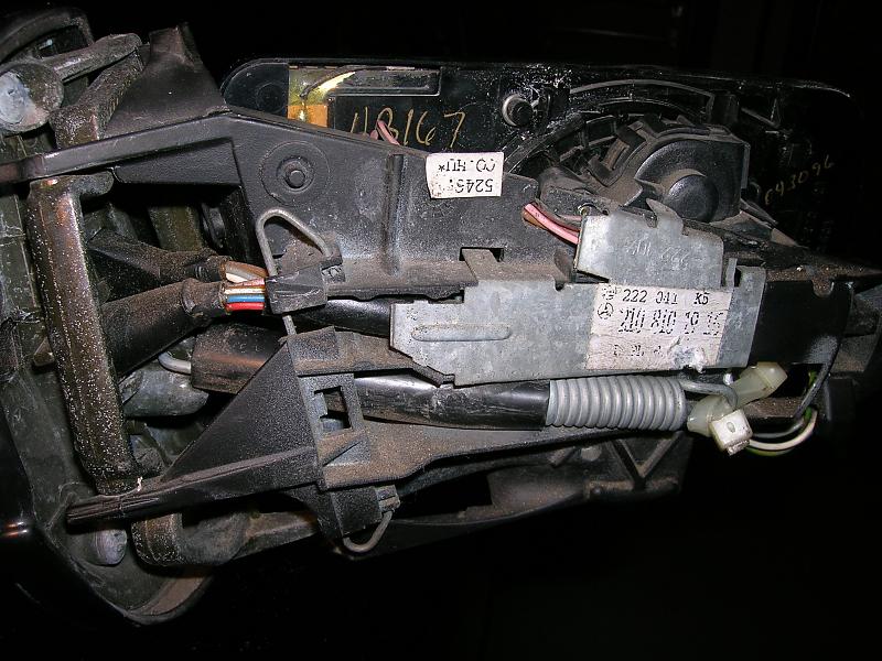

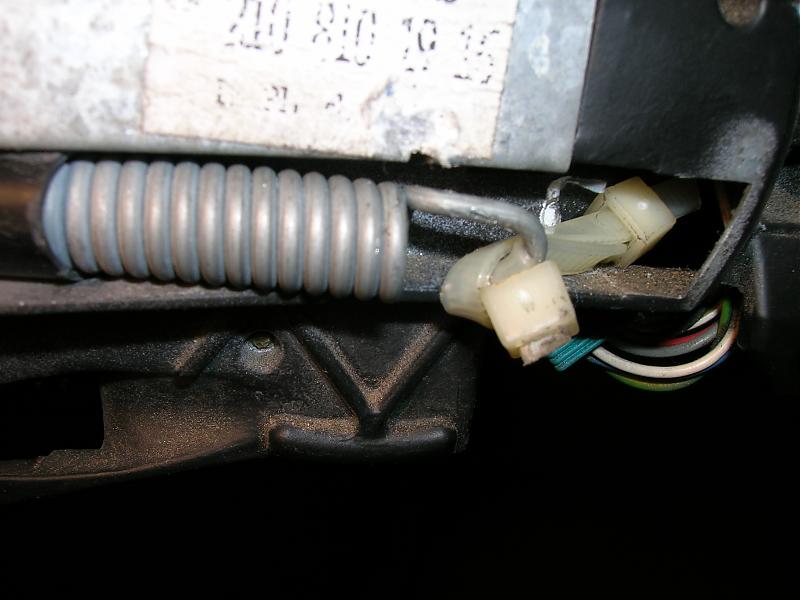

'97 E420, the driver side (exterior) mirror started flopping around. The internal spring that keeps it tight broke off inside the mirror. What actually broke was the spring's mounting point on the mirror's internal aluminum frame.
I used 2 plastic wire ties (zip ties) to secure the end of the spring to the frame. There's an opening through the frame near the original spring mounting point. I threaded the zip ties through that hole.
The spring doesn't see any significant load unless the mirror gets pushed back, so I think the ties will hold.

Here are some pics.
Galleryvw - I think I was able to put enough tension on the zip ties so it holds the mirror pretty tight. I pulled the ties tight using pliiers.
John

I actually fixed it and even make it more permanent. Form the above picture above, you can see the bottom screw (lower left corner). I took the screw off, I then use a flat piece of metal (.5x3 in), drilled a hole about 1/3 of the way, used the same screw to mount this piece into body frame. I then bent this metal piece around the mirror frame bar and hook it real tight, and put back the mirror cover.
Now my mirror cover is not flexible (via spring) any more but it will not come loose again through car wash at all.
JP

in the 1st pic, is the assembly on the car?
if so, why is the mirror on the assembly if the housing is off?

king 1,
Yes the mirror is on the car. If you''re asking why the mirror glass itself is still there, on this particular mirror, the housing can be unclipped and pulled off without removing the glass.
