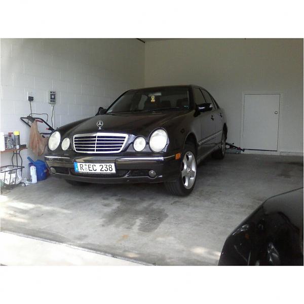

Exclamation re:help
in manual mode it would shift into all gears, after i shut off the car and re-start it. since thursday this has not been working, and it has been stuck in limp mode ever since. the check engine light is on, and the last time i had the codes read something like a trans sensor and maf sensor, i will look for the paper i wrote them in to post it it does make a noise when u shift from park to drive and to reverse to park, like a soft clunk sound. it didnt do that before, i lifted the car up today to look at the linkage underneath and there is a long rod that connects down there that feels to me like its not tight enough as it moves too freely with just touching it

Exclamation please help
miss driving my baby

Exclamation transmission help/cel?
i bought the maf sensor bosch for 220.00 hopefully that helps with the error codes, any suggestions on what to do next?
