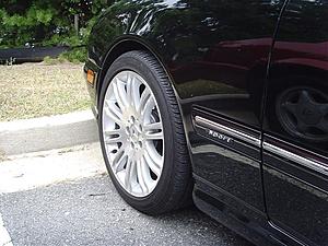

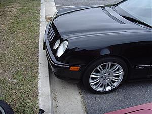

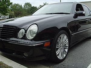

I got the RAD lugs and the 5.5mm spacer this morning so I went out and put one of the fronts on at Lunch to see if it cleared it did so i drove it around the parking lot and no rubbing so far, there is less than 1/4" clearance. here is a picture from lunch. I will post more when I get the rest put on tonight and get the car cleaned this weekend. Let me know what you think.
Attached Thumbnails 18" & 19" wheel owners please help!-snv30575.jpg   18" & 19" wheel owners please help!-snv30574.jpg   18" & 19" wheel owners please help!-snv30576.jpg

From the back it looks like it might rub when you turn the steering wheel AND the front drops for whatever reason - additional load, hitting a dip in the road or speed bumps, braking while coasting downhill etc, at least on the left side side. Since our cars are not completely symmetrical it might be worst or better on the other side. That's just what I suspect because my rubbing side doesn't stick out as much as you but you might get away with it since your's is riding higher than mine. In any case, rolling the fenders might fix it if it does rub.
