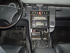

Hi all,
as a newbie here, let me first say that this forum is fantastic! this is how the internet should work: people with similar interests coming together, discussing those interests and helping each other out in a productive way! great
now, i just bought a '97 E420T Avantgarde model, with a rather "old" stock audio system (cassette), Bose amp and cd changer.
from my current car, i have a Sony cd radio (reads mp3) so i no longer need the changer (10cd's fit as mp3 on one), with amp and Rockford Fosgate sub.
Would you advise changing all the door speakers (tweeters too), replace the Bose Amp, and install the new sub.... or other suggestions?
what to watch out for in terms of wiring, connectivity, etc.
thanks for your feedback!

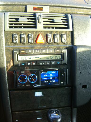

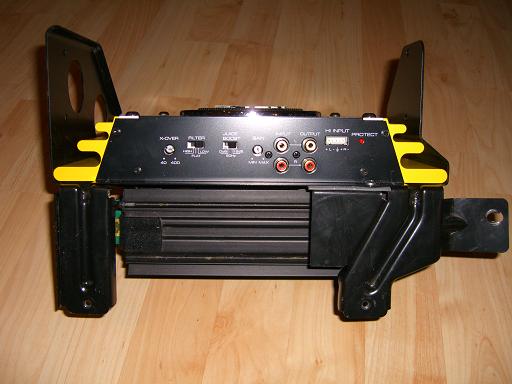

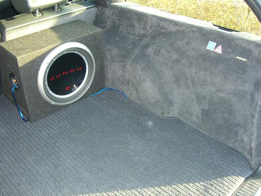

i've got the Tmodel, so lots of trunk space. decided to install a dvd radio system with twin tft monitors, ipod/mp3 and video-in connection under armrest, then sub in the huge trunk connected to amp. I always want everything nicely "hidden" and installed without drilling, screwing, etc. the neat thing is that as i took out the old stock cassette HU and the cd changer, i found the amp fitted in the space that was created on that bracket... not even one millimeter of space to spare. lucky so, way cool to be able to stow it away there. now got the bose amp still steering all the speakers, and the other one the sub (of course with remote power &all).
i took the whole interior apart to pull all the wires -a gazillion of them- through, on both sides and in the center. crazy, but worth it once done!
will build little consoles now that will hold the monitors for viewing in front (out of glovebox) and rear, center behind concole.
now i have one problem.... even before i did anything, and just took out the stock HU to connect my sony mp3 radio, it had a slight buzzing sound on low volume (later, volume up hides the buzzing). i do not understand how this is possible, as i did nothing to the speakers and all is linked to the standard iso-connector.
If anyone can help here, great!!!! it now is especially "annoying" with the dvd system, as the buzzing/distortion is well-heard when people just talk in a movie.
thanks in advance for sharing yr expertise, happy posting
