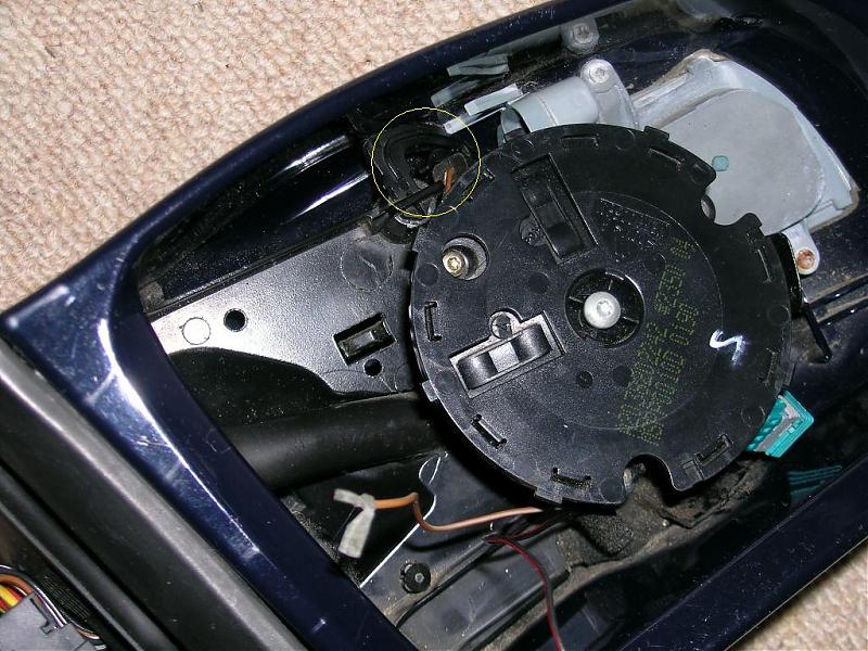

When I bought mine, one was not working. I spent a couple of hours tinkering with it trying to figure it out. It's a very cleverly engineered socket where it's plugged into and almost impossible for it to come off. Somehow, it had unplugged and was able to put it back in. I'm sure the PO never noticed it. Very satisfying repair BTW.

You're right! Nice story. It's been a while ... I recalled I took a picture of it. The LED is in the circled area.

Aha,,now we getting somewhere,,thanks Mark n Oh n Franasia,,,these are folding as well,,Steve did the job 4 yrs ago..much obliged all

Update,,,,got the mirror disassembled but could not get the LED unit out,but I tapped and jiggled the thing,,and the light blinks again,,,man them germans.
