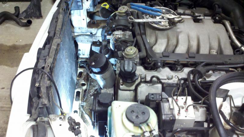

Thanks for the excellent advice. Probably start looking at parts today. Hate seeing it stuck in the garage with the hood up.

Went through all the service records today (the previous owner finally got them to me a year later!!).
There is no record of any cooling system parts having been replaced. The water pump looks original as does the thermostat. There doesn't seem to be any play in the wp shaft, turns smoothly and no appearant leaks. The upper rad hose has a visible merc star on it. The lower hose matches the upper hose but no markings.
Pulley checks:
Alternator - smooth and quiet. (appears orig, no records)
Idler - very smooth, perhaps a little noisy. A tiny bit of play if you twist on it. (appears orig, no records)
AC - Smooth, quiet, no play. (ac service performed, comp appears orig)
Belt tensioner - Very smooth, makes intermittant dull clicks. (appears orig, no records)
PS pump - Smooth with no play (reservoir only replaced in past)
There's actually very little that's alarming. I expected it to look worse with 190k. Really, the only things that are obviously wrong are the rad and fan clutch. (and the 2" of mud on the crossmember under the rad!)
