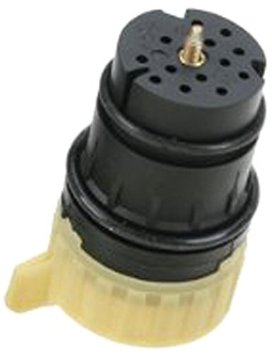

One of the key components that can "fail" happens to the the tranny adapter plug - and best practice if you are servicing the tranny/and in this case replacing the conductor plate - is to replace that tranny adapter plug - use genuine MB/MOPAR part only for about $14.
At the same time - or after in this particular case - is to pull the Tranny Control Module/board - check to see if fluid has wicked up there - and if necessary fllod/clean with MAF cleaner.
Since you have been all-the-way-in and all-the-way-back-out - I assume you covered this - if you haven't - then I am certain you can get this squared away.

I ditto the pilot bushing being the culprit 90+ % of the time.
But when you run into spammers, it is easy to spend bigger money on stuff that you don't need.
Still Serb, if you did not replace the pilot bushing with new plate >> do it ASAP.
Also washing TCM might be good idea if you seen ATF in computer coffin.

Pilot bushing, also called adapter and few other names have good price sold under Mopar brand on Amazon (it is original MB bushing made in Czech Republic).
$10 item have 2 orings that age and let ATF to shorten car electronics.
They are source of >90% of those transmissions problems and MB few years ago made a policy of replacing it with each transmission service.

Since the original plug tends to leak internally - and over time fluid "wicks" up the harness into TCM - you also pull the TCM board - check for fluid - then if contaminated you "flood" the pulled board with MAF both sides - lets contamination run off - air dry w/no heat - spray clean connector - reinsert board - etc..
