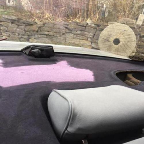

My 1998 E430's rear window bay was pinkish-purple from sun bleaching. The Bose cloth-covered speaker covers were also pink. I looked at lots of solutions like sprays, and considered re-carpeting the bay.
Today, I thought, heck, wonder if I can just hand-paint it? Bought a 50¢ bottle of charcoal-colored acrylic craft paint at Walmart named "Pavement", and hand-painted it with a 1/2" artist brush. Took an hour. See the pink surface? That's the unpainted part. It took decades off the age.

I must say for .50 that result is hard to beat. Looks good!
How does the material feel? One thing I noticed on mine is that after dying the fabric, it seems to become a lint magnet. The sun rot made my deck fabric more brittle so while mine looks new, it feels rough.

The material just feels like slightly stiff carpet, but I don't ever touch it anyway. I just hated that pink bleached look, every time I looked in the rear-view mirror.
