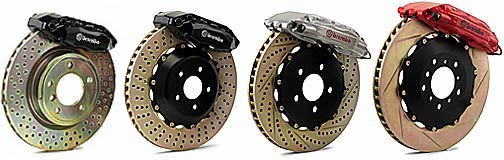

Anyone tried Brembo Max rotors (new ?) and Goodridge braided brake hoses (needs modification) on their E's? Are these any good? Pros and cons? Many thanks.

I wouldn't get slotted rotors for regular use. I would stick with cross-drilled ones.

Actually, I'd just got this setup..........I've found the response and sensitivity is much better than my OEMs- could be the braided hoses but I understand slots also have something to do with it. The reason why I chose these was mainly price - similar, if not less than the OEM rotors.
What are the problems with the slots? Not real sure if this particular slot patterm would be any different to the single direction ones......

Anyway, can anyone enlighten me (us) what the cons of slotted rotors are? There must be other reason why everyone favor drilled, besides appearance and perhaps greater pad wear.........

As the slot wears down, the channel for the gas buildup gets smaller and smaller. As the rotor gets thinner it loses it's ability to stand up to as much heat and that is when it is more likely to warp. Your pads can wear out faster. I have heard you can get a vibration while stopping with the slots hitting the pads. You will have to see how they are down the road after a while. They are swapped out more frequently on a race car rather than on your daily driver.
This is true regardless of whether it is slotted or drilled or a regular rotor.
Race cars in general swap their rotors frequently anyways.
For some more information regarding whether slotted or drilled rotors is for you, see http://stoptech.com/faq/data/faq15.html and also http://www.stoptech.com/whitepapers/...otors_myth.htm

Check out StopTech's braided lines. Ordered a set today. Very high quality and supposed to fit our car exactly with no modification. $114 for set of 4 plus shipping. Teflon inner hose, wrapped with braided stainless steel, plastic coating on top of that for extra protection agains chafing and cuts.
Will be using Zimmerman x-drilled rotors and Pagid pads in addition to the StopTech hoses for my brake upgrade.
Brembo Gran Turismo kit calipers would not clear my wheel spokes.
The rotor will be replaced long before the effectiveness of the slots is reduced due to wear. I've put slotted rotors on several cars. None of them had problems as they wore out.
Cross drilled rotors have their own set of problems including increased cracking between holes when they get too hot. They are generally weaker compared to slotted rotors when it comes to heat cracking. However, if you are getting your brakes hot enough to crack rotors, you've got other problems!

After a few days with the braided hoses and slotted rotors I must say the braking response is much more "controllable" and less abrupt than the OEM setup. The slotted ones squeak a bit during low speed braking but I've been told it will go away when the pads and rotor "get in sync" after a while....hopefully.
Some very interesting discussions here and the Stoptech article certainly shed a lot of light on the "warping" issue/myth. From all this I gather whether slot or drilled, cracking will occur when you subject them to alot of real harsh braking and doesn't really occur under normal driving conditions - perhaps drilled is more likely to do so. Anyway, x-drilled are definitely more appealing to terms in terms of looks to me but I'll just have to wait for my next change to try them.

Yeah right!!! A BBK would have been the first choice but price-wise it just doesn't justify at this stage.....at least I've got the brake lines already

Brembo makes a drilled replacement rotor for the rear of W210. You can buy them pretty much at any Brembo distributor. Do a search online for Brembo and you can get tons of info.

I wished Hubert , I wished. But the cost doesn't justify the extra looks and braking power I don't really need....at least right now. I've not tried other slots before but these sure seem pretty good to me (except for the squeeks, which hopefully will go away very soon).
I think the Brembo Max are relatively new on the market as my research on the web shows separate pages featuring them. Unfortunately tho' I can't find a US site that advertises them, maybe the US Brembo dealers might have them. Here's some info that I found on them - on paper, they sure sound like a great improvement on the OEMs and COST NO MORE THAN THE OEM rotors
