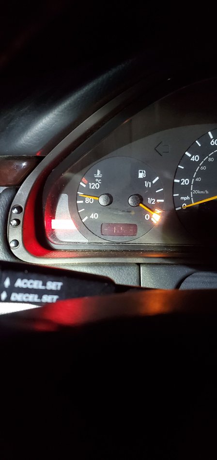

I had some time today and started the car and let it run for about 45 minutes. One other thing I noticed was the temperature of the engine . It seemed to hit about 100 C would this be considered overheating ?
Temp gauge after running 45 minutes parked.

Strictly speaking, no. If the temperature was stable during that period, except for the warm up from cold phase, it's not overheating. If when you took the photo, the temperature continued to climb, it might have been overheating. Was the temperature stable, or climbing?

Hi the temperature did not continue to climb it stayed locked in at 100C.
