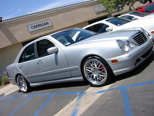

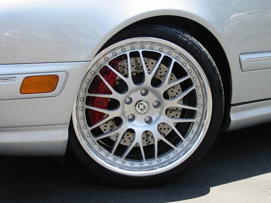

Miracle Fitment!
there is another member with a miracle front fitment. JamE55 upgraded to HRE rims 19X9 et32 with no rubbing. The calculations state this fitment pushes the rim inward 14mm. However, Jam did upgrade to Brembo brakes and I suspected that the brake rotor face (hat) may have been further out than stock which would require a bigger offset, but it was supposed to be the same as stock. No one has been able to explain Jam's miracle fitment yet.
Attached Thumbnails W210 suspension help!!!-jame55-2.jpg   W210 suspension help!!!-jame55-3.jpg
All these discussions on wheel clearance is getting interesting....u sure he didn't space them out. What about tire width?....I guess with 9" he'd need at least 245's right?
Yep hes got 245's up front....
