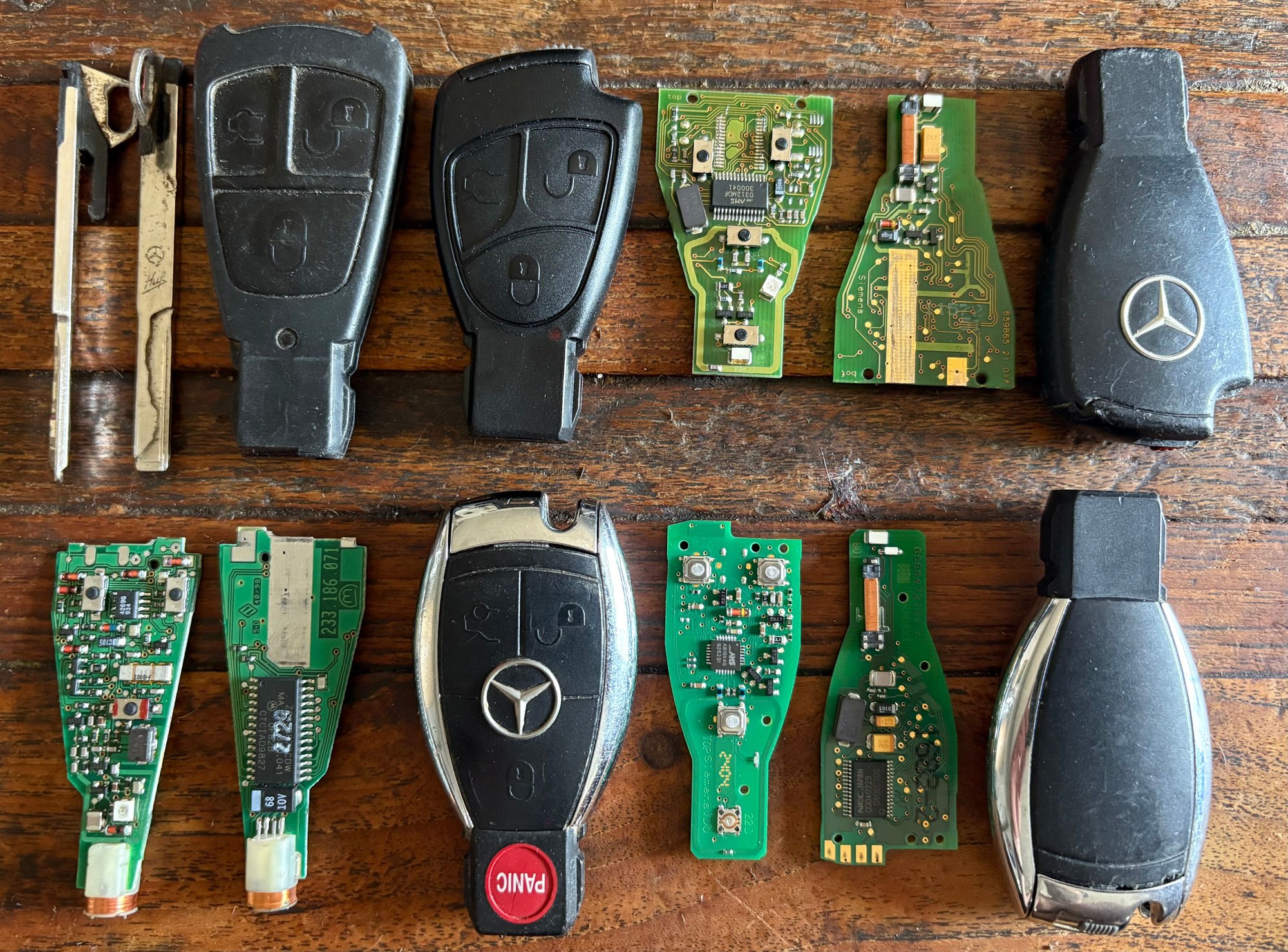

Which one of these?
Does door locking and unlocking work?
More likely it isn’t the key but something AFTER the key. Which leaves EIS (ignition switch) or something after. I’m not as familiar with the specifics after the key but typically the EIS & ECU agree the key is good and enable start and ignition.
You are probably going to have to get access to a diagnostic machine that can speak Mercedes.
It would be helpful if someone familiar with the stuff between key and starter chimed in. I imagine there is a relay somewhere along with ECU.

It’s the bottom left key in the picture you showed me . And yeah I think that’s my best option is to get the 38 pin one so I can talk directly to the brain . I only have an obd2 Which shows nothing . I guess I’m kind of stuck until then . I can update you guys after I purchase one . Thanks
