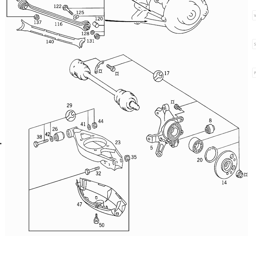

Is this too much play in the bushing? I'm assuming these are likely original, the rubber has no tears, and looks intact. I don't want to go through all the work of replacing it if it does not need to be changed.

Looks "loose" in my opinion. I wouldnt say it looks like they need to be replaced at this time, but they probably should be replaced if youre going to keep driving the car.
I have a 2010 W204 with 160,000 miles and im about to replace those bushings due to wear and the rubber looks all swollen probably from the road salt. Bought the special tool for around $200 to remove/install them due to the odd shape of the wheel carrier and tight clearance.

Change it. Bushing should not have any play in it. Let alone move around like that.
But then again, just how long are you planning to keep the car? If not too long, maybe good used will do. If you planning to run it to the ground, change it with good brand, new unit. BTW, if one is like that, rest is about to go too, so change all of them. Not just upper or lower pair. All. Unless of course, you enjoy jacking up the car and take off the tire, get under it. You got the point. If not, change all of them.

Around $45 for new Lemforder bushings. I believe the Genuine MB bushings are made by Lemforder. If you already dont have the tool then another $45-$200 depending on which one you get or make your own. Looks like easy access so shouldn't be difficult to do.

Got to lube em up! I have used dish soap and mb lube to help pop them in, then dead blow hammer hit.
Also the tool was like $39 dollars on Amazon. Those rear outer looks like toast. you will hear a knock from the rear when cornering eventually.

The bar off the car when I replace the sway links because I am usually replacing the bushings too. Yes, that is the tool and looking back I paid $100 KTC MBZ2002. No, air hammer the outer rear bushing out maybe but then the challenge of reinstallation. The tool makes it easy and exact..
