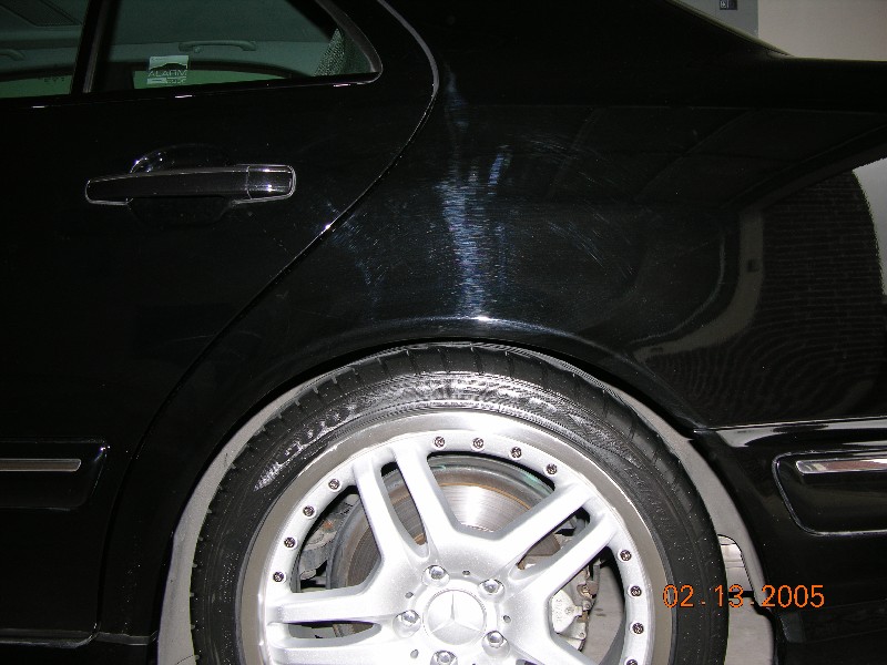

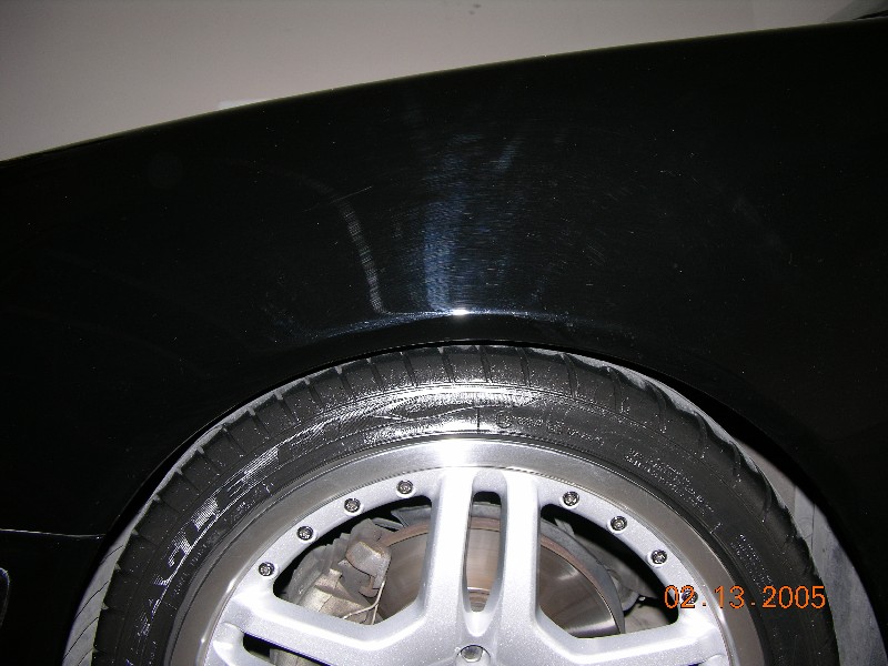

Hi All,
I recently installed the Bilstein SP/Eibach spring combo with #1 spring pads all around on my 01 E430. I noticed the drop is way low, especially after the springs have settled, and I am experiencing some rubbing, both front and rear, especially when going up a slope and on some turns. I think the front is way low there isn't even a finger gap between the fender and tire.
My car had #2's in the rear and #5 up front as stock. It is surprising to me that the stock pads in front were much higher than the rears.
I am hoping someone can give me some advice as to which #'s to use for a acceptable drop and no rubbing.
I appreciate the help.
The first pic is of the front wheel and 2nd is of the rear wheel.
Attached Thumbnails Spring Pad Advice-dscn0183.jpg   Spring Pad Advice-dscn0190.jpg

well from what i've seen, a lot of w210's have different stock spring pad sizes, at least the ones i've seen before.
you will need to roll the fenders, it will get rid of the rubbing...
or other then that you need to play around with the pads to see what you like the most, when i had number 3's in the front i had no problem.. i have h&r cupkit and on #1 pads and i rub big time on the front but i havn't rolled my fenders....you can go 3 in front and 2 in rear...

Wow, that front is way low compared to mine (I have the same setup) but it doesn't look serious - are u sure the springs are for your model car? In any case, I have seen members with differing effects from Eibachs.....I have #1 up front and #4 in the back and my car's the exact opposite (front higher than rear)! I wish mine was sitting like yours and I would just roll the fenders
Anyway if fender rolling is not your choice, as Alex said going up to #3 should fix it. The rears shouldn't be a problem if your wheels are still set quite deep into the wheel well without the 10mm spacers, right?

it would be a waste of money to change up te system now, from the way you describe it i think your best bet is to go to a number 3 pad in the front and stay with the 1 in the rear and see what happens. it'll take a little time for the springs to settle depending on how much you drive so take your time with whatever you do...

Fender rolling is roughly defined as using rollers to fold the inside edge of the fender flatter so you'll get more clearance. However, I really would suggest going #3 pads first. It looks like you'll only need another 10mm (which a increase of 2 springpad sizes will give you, or at least there abouts) to get it to the height I'm at in the front.
Only roll your fender as a last resort since if it is not done correctly, the paint will crack and therefore increase your chances of rust there. I'm not in any position to recommend where to get it done, i would presume a some wheel shops can do it (Alex and others should be able to confirm). It is done with a special rolling tool with some heat applied during the process.
Also, on your dissatisfaction with the ride, may be cuz you're just not used to the harsher ride per se - you have gone 1" bigger and used lowering springs, thats a double hit of harshness. My point was, who knows, the koni's may be worst, even at the softest setting. I've not personally used them but I have been told adjustibles, by nature, tend not to be as durable as the regular shocks. I think you will learn to live with the harsher ride when you start experiencing the improvements in handling, particularly the absence of the wobbles at high speeds, we all did
