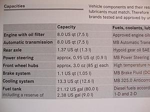

My 05 E-Class E320 CDI book on page 396 says 8.0 US qt.

I'm curious to know at what point the add 1 quart message comes up. When I check the level using the display it indicates 6.0 quarts.
My '06 E320 CDI manual indicates that 8.0 quarts is the capacity.

Oil Levels reading versus Quarts in the Oil Pan!
Today, for the first time, I sucked the oil out of my oil pan in my 2006 Mercedes E320 CDI with the In-line 6 cylinder. Now, I may not have gotten the last half an ounce or 1/4 of a cup of oil, but I'm happy and I'm German with 40 years of experience with instruments in power plants. I even went through the evacuation process two times and was right at the bottom of my oil pan and getting no more oil, just a lot of slurping!
So, I installed the filter and added 8 Quarts of oil to the engine and I'm and happy camper! I was always worried about over filling the engine. I wanted to establish some "base line data" so I parked the car on the level and allowed it to set for an hour before using the "3-click method" and reading the level on my dash. The answer is, for my car only, 8.0 quarts with a filter gives me a reading of 6.7 Quarts. It's good base line data and something for me to remember in the future.
Now, when I read 6.7 quarts, I'll know my engine is full and that's all I need to know.

I have an 06 CDI with an I6 engine. Manual says 8qts I believe. anyway last change I put 8 qts in and my level indicated 5.9 qts even after it sat for a while. I don't think that level sensor is very accurate. Which is terrible because of course you get no dipstick...

Oil Level is Repeatable
The good thing about the 6.7 Quarts that I am reading is that the number is
"repeatable". I don't really care what the number really is, - it would be nice if if was 8.0, but it doesn't really matter to me. Where I park my car, an indication of 6.7 Quarts means that I have 8.0 Quarts in my crankcase! That also explains why I was able to extract more than 8 Quarts of oil from my car when I had a reading somewhere around 7.2 Quarts. It would be nice if the number was closer to 8.0, but it only a number.

05 e320 cdi vs 06 e320 cdi oil capacity
I have owned an 06 e320 cdi and the 05 cdi as well. They have different oil capacity. The 06 holds more oil. I believe it is 8 quarts as opposed to the 6.87 for the 05. The 05 may even have different capacities based on the month of manufacturing. My 06 took almost 8 quarts, it had 425k when it was totaled. We replaced it with an 05 e320 cdi and it takes 6.87 quarts .Just giving my two cents worth.
