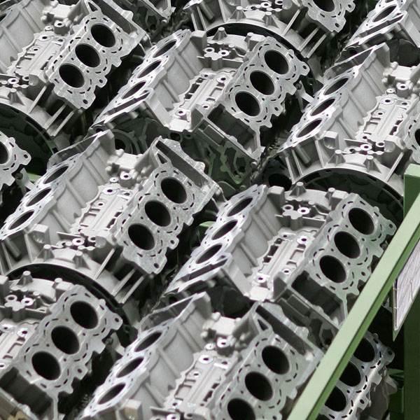

The iron sleeves inside Aluminum flies the the face of what I learned in material science classes... those metals have different heat properties.
If you look at this picture from the Hydra website, the cylinder walls seem to be missing.. so maybe the steel sleeves fit inside and have no aluminum around them.. which would assist in the expansion. However, the top of the block still is made of aluminum where those sleeves must be inserted.

that picture is actually of the 2.0L I5. I can't find a large pic of the I6 anywhere..
It still looks similar and would be easy to tell apart from the V6.
