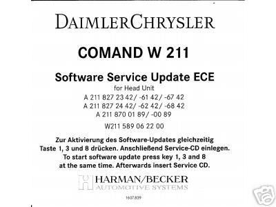

I did a search, and found someone with a slightly similar problem. He had the dealer reflash the command after which everything worked, according to him/her.
Do you think my dealer can reflash a euro command ? and what exactly do they do?
Old Apr 26, 2007 | 02:03 AM
georgedaman's Avatar
Joined: Jun 2006
Posts: 375
From: Toronto Ont Canada
GL350
I would be supprised if they attemped to do it...and even more supprised if they could do it.It needs the service CD(european version)
It is similar to reinstalling Windows on a computer..
Let me know if you need the reflash CD.
What version does it reflash to?
Got my [EURO] COMAND from Steve in 2004 and have been wondering whether there were any updates to the COMAND software since...
It doesn not specify the version but here is a link
https://mbworld.org/forums/attachmen...6&d=1156284047
