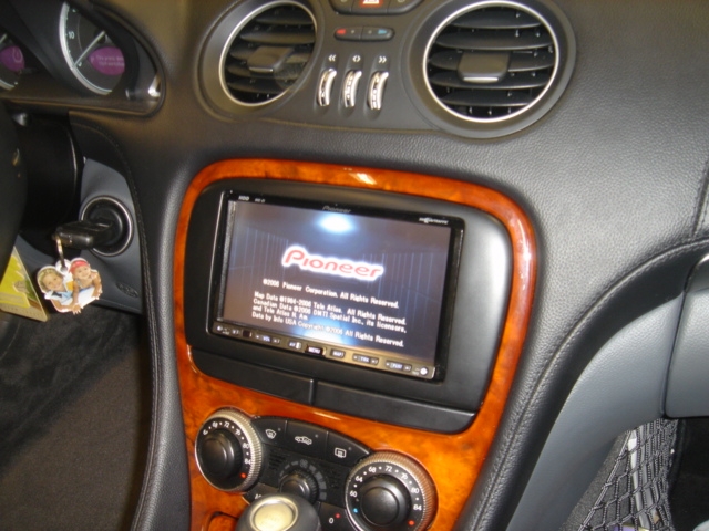

For those of you who may be interested, a solution does indeed exist to replace the anachronistic COMAND system in the W211.
There are some very experienced with high-end vehicle car audio shops that can retrofit a Pioneer AVIC-Z2 unit in the slot where the COMAND head unit sits. There is a modification made my SoundGate electronics that allows the steering wheel volume controls to still be functional, however, the NAV/AUDIO information on the multi-functional display inside the speedometer is rendered inert.
Because the head unit is replaced, the new Pioneer unit must have a new amplifier to drive it, however, you can keep the stock speakers if you'd like.
While the Pioneer unit is exemplary in functionality...it contains a 30GB hard drive that contains the navigation maps, and about 12 million POI's, allows you to rip CD tracks onto the hard drive and create music libraries that are instantly accessible, and the unit can be easily modified to allow no lock-outs while in motion, the drawback is an extremely slow boot-up time upon start-up...about one minute.
The upside is that the unit is a completely self-contained panacea for the discriminating gadget-freak kind of driver that loves the W211's driving dynamics.
The unit has a bluetooth hands-free optional pod that integrates seamlessly with the touch-screen, XM and Sirius can be run simultaenously, and can be connected to a back-up camera.
I'm considering the modification to my '08 E550, but, it comes at a very dear price. With enhanced amplification and replacement of the stock speakers, we're nudging up against the five figure threshhold. But, you get what MB should have allowed you to have initially. I would imagine next year's revamp will have far better COMAND, but, I couldn't wait.

FIVE FIGURES??? OUCH!!!!!! Do you have pics of what the end result would look like? I can't imagine ANY aftermarket stereo looking OEM, no matter how expensive.
Old Nov 28, 2007 | 02:01 AM
airactivist's Avatar
Joined: Aug 2004
Posts: 12
No photo right now...
But, I'll post one of a unit that was put into I believe another class and a little older model. I'll have to sift through my photos to find it.
Part of the reason for the high cost is the fascia molding that the shop hand-crafts in order to preseve a factory look and feel.
It's flush, and extremely stock looking, not something like a Best Buy or Circuit City slap-on add job.
No, it's not cheap, but, neither is an E550. The unfortunate one teeny drawback to the E550 are the antiquated electronics, but as I've seen written many times in these threads, and I wholly agree with, give me the E550's dated audio/nav aberration over the Accord's state of the art electronics/audio/navigation stack any day. At the end of the day, it's the drive.
I'm just letting you know that if you want to pay, you can have your navi/back-up camera/bluetooth hands-free touch-screen cake, and...uh...eat it, too.

Here it is
The Pioneer AVIC-Z2 installed in a 2003 SL500. Note the bezel. Nice work.
i think the stock command looks better albeit being stone-age in functionality.
