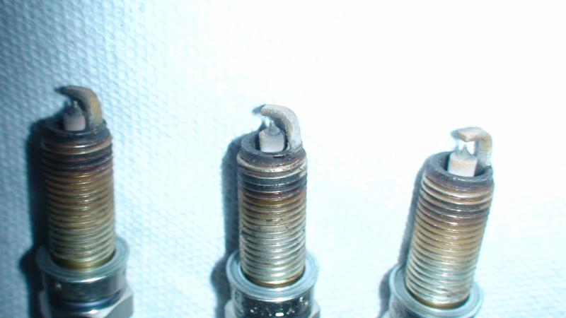

I did my spark plugs today, took abt 2 hours
but what I found was HORRIFIC!!!! No wonder my car had severe vibrations in idle
So on the passenger side, the plugs were NGK (with mercedes Logo on them) ...... On the Driver side of the engine, Plugs were Bosch
Now here's why I think NGK SUCKS - the tips were totally worn out as if they were raped or something ..... Bosch was still okay, even if only driver side plugs were replaced, NGK shouldn't have corroded (my car has 46k miles - these things are supposed to last a 100k right)
And here's the mystery question - WHY WERE ONLY 3 PLUGS REPLACED ? Come on guys, I've started to get worried now - Is the engine rebuilt or some einstein tried to test his new 'unsymmetric spark enhances torque' theory ??? I'm totally shocked!!
Also, pls advise by the color of plugs if my combustion chamber is in good health - My vibrations are I would say 90% gone .... there's still 10% there which I'm sure are natural unless you guys recommend I change my coils out too
First Pic:
LEft one is Bosch, right is NGK - observe the tip of NGK is totally worn out compared to the pointed tip of Bosch

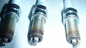

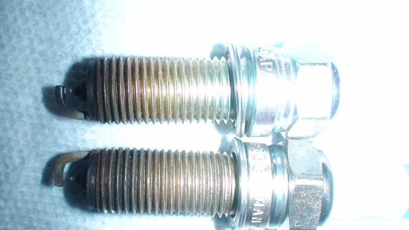

Second & Third Pic are NGK
Fourth is Bosch
Fifth and 6th are more comparisions (NGK, Bosch)

Not sure if I would be too happy to find different plug makers in one engine.... How do you know the two different brands of plugs were installed at the same time???? This might answer the question why one brand is worse than the other.... That being said, the plug color looks fine, should be a nice light charcoal grey in color with no oil present....

I'm the second owner of this car, it had 39k miles then. Just curious to know why would someone change half of the plugs (all on one side of the engine) ??
Head work on one side??????

hmm... should I check compression on every cylinder just to make sure all 6 are equally 'healthy' ... There was a valve cover leak near cyl 6 which was dont by benz dealership ... The car still has some vibrations in idle..

Since both plugs are OEM, perhaps the car was brought in under warranty with a misfire and the dealer replaced one side. Or pehaps the prior owner did one side and found it too difficult to continue.
Those plugs looked pretty bad for such low miles. I changed my plugs on my w210 at 100k and they looked better than that
I agree. They look pretty bad for so few miles, especially if some of them had already been replaced.
Platniums should last longer, although I probably would not spend the extra money until I figured out what was going on. I would suggest dielectric on the spark plug boots to eliminate the possibility of carbon tracking. I would also replace one or all the wires. One to try to troubleshoot but all of them for piece of mind. I don't think it is the coils. Seems odd that all the plugs are pretty well shot. Not usually what happens across all cylinders.
I am thinking you have a lean burn problem. I am thinking a weak\bad fuel pump. This would account for a problem across all cylinders. A pressure test should be easy to perform or fairly cheap to have done. I discount bad gas or dirty injectors. Rare all of them go bad.
I do know that MB Dealerships are instructed to replace spark plugs only if they are verified to be bad/misfiring (if you are NOT doing a maintainence service where spark plug/wiring replacement is included). I know because I had to go back to my dealership 4 separate times within 1.5 years for spark plug replacements and spark plug wiring replacements on my 2002 C240 since they wouldn't change everything out at once... only the 1-3 that were deemed "bad" by their diagnostics. This policy probably saves MB some money by not replacing "usable" plugs or wiring, but gives the customer a lot more hassle driving back-and-forth so many times... and makes a lot more money off them because they charge the "diagnostic" fee each time the customer comes in!
Maybe that's what happened with the previous owner (before he traded in his car)?
