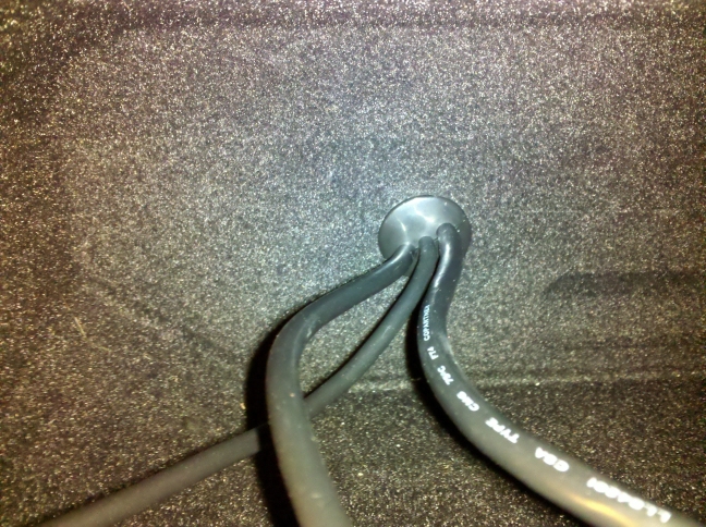

The switch is on a little module with a status light and an additional set of RCA phono aux in connectors. There are two other wired cables, one with a USB end for memory sticks, and the other is the iPod cable.
I have for the moment placed everything to the glove box, where it all fits alongside the document organizer. There is even a supplied cable grommet that fits perfectly in the hole in the glovebox where the OEM factory adapter cable came through.

Where did you find the factory gromet? It makes the install look very nice.

"Factory" grommet CAME with the Dension kit - as I said it fit PERFECTLY where the OEM grommet and cable used to be.
