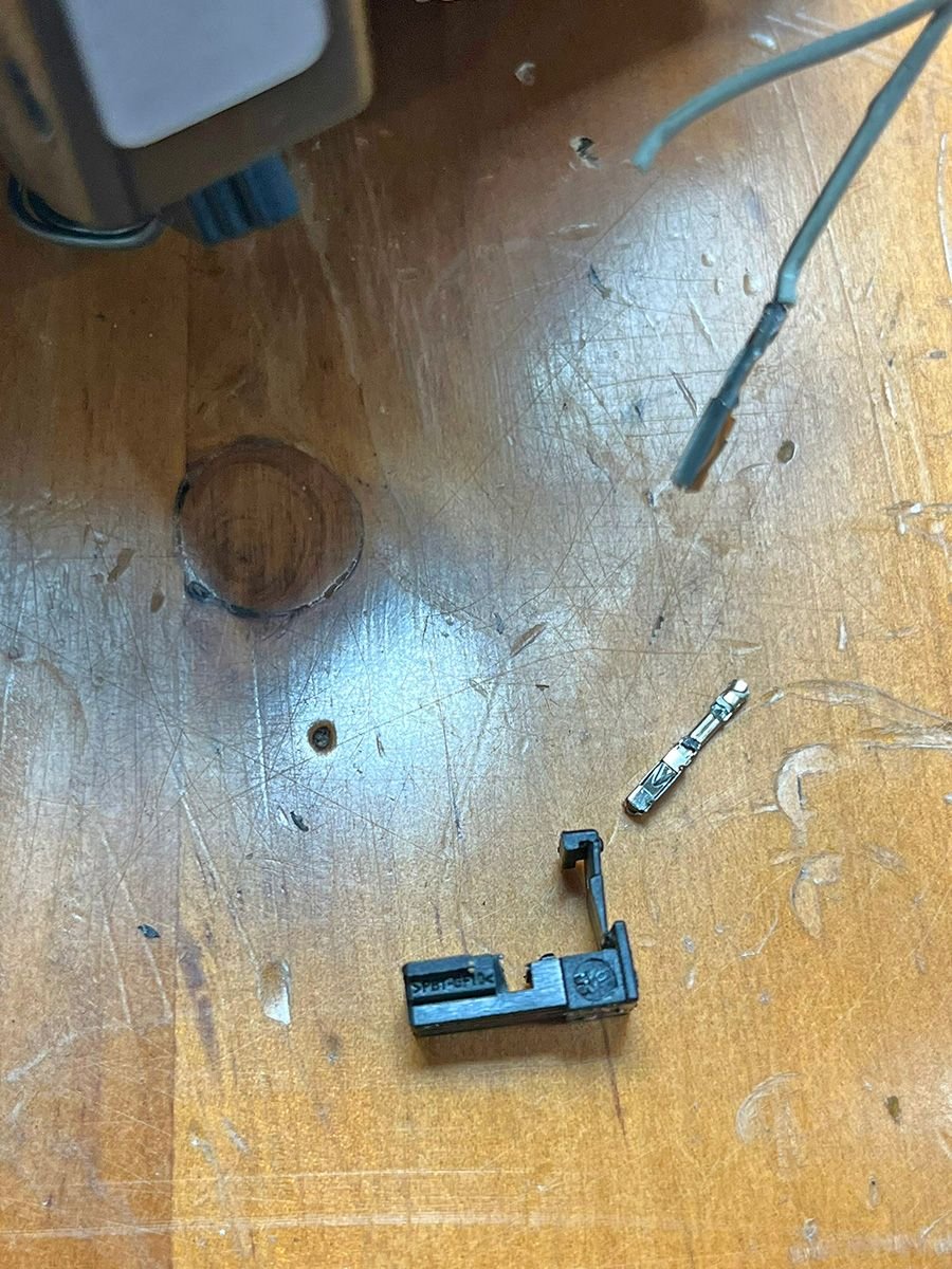

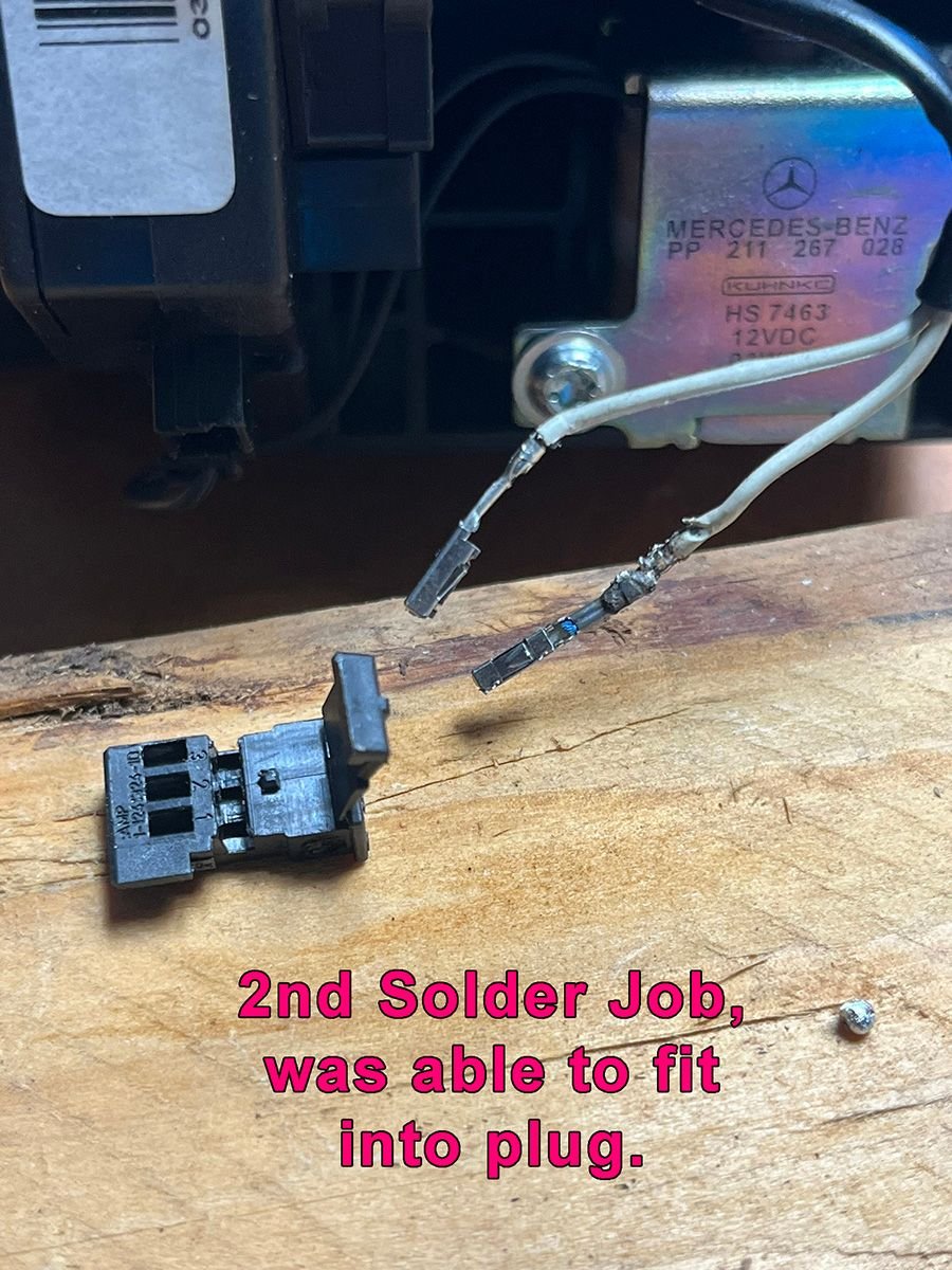

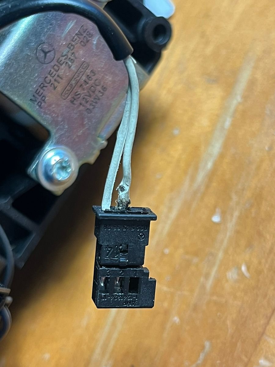

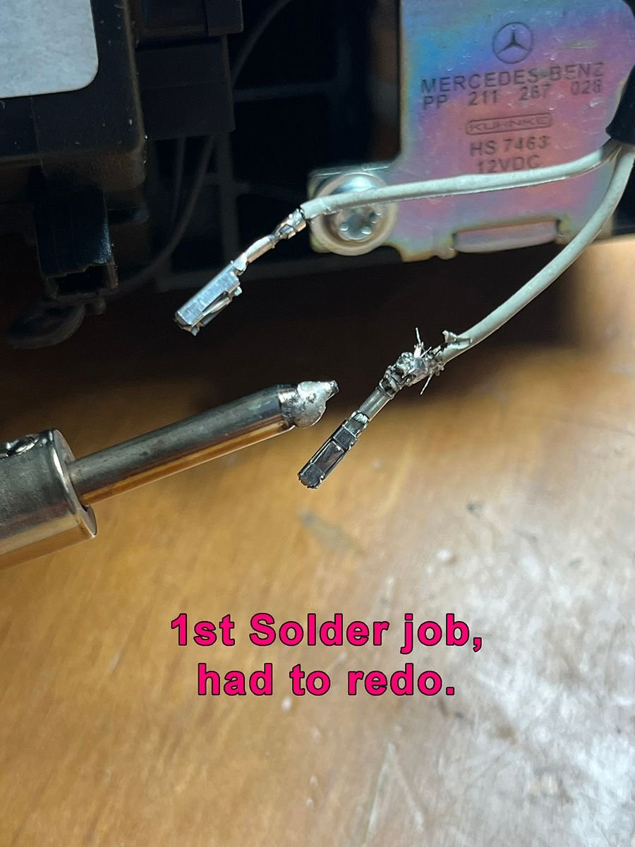

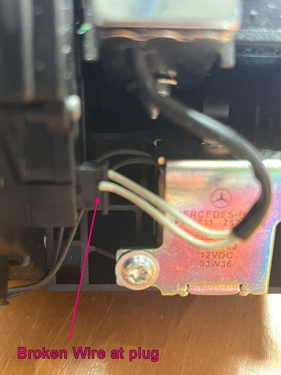

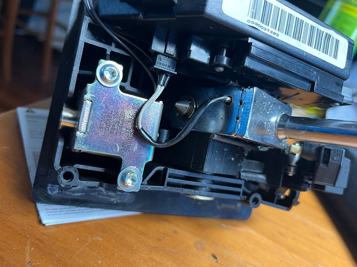

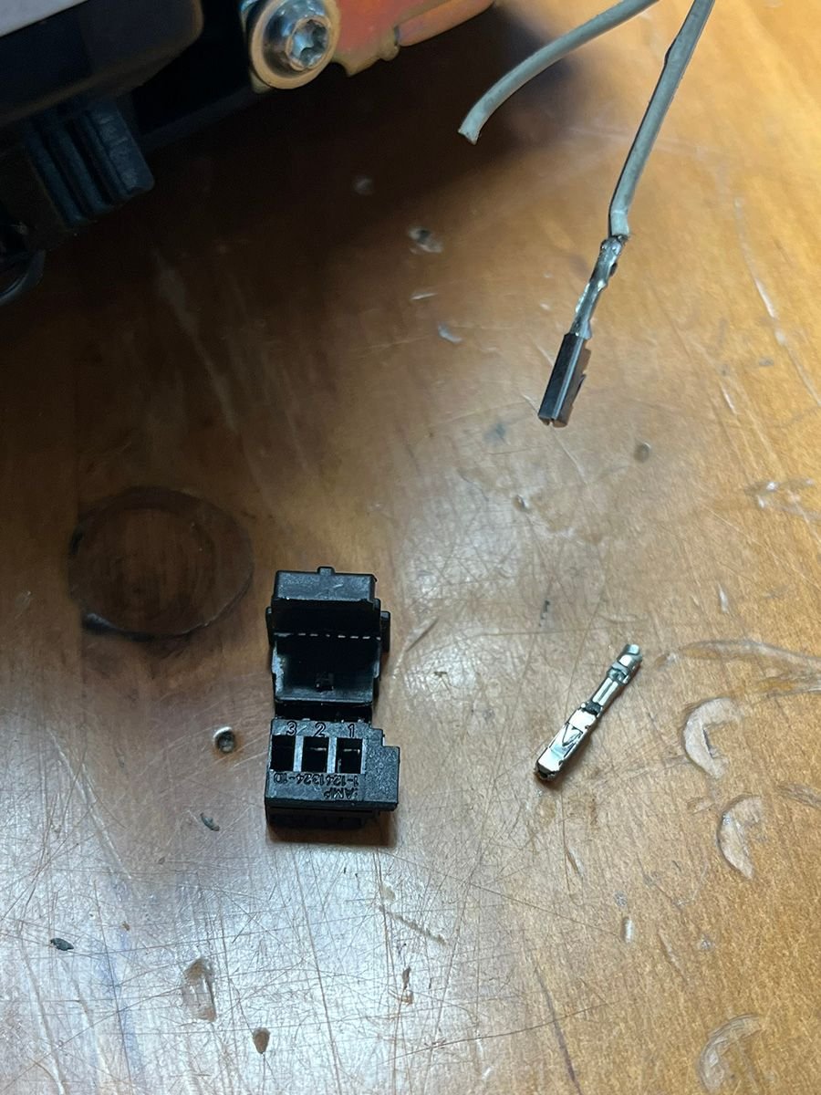

I've been meaning to do this for quite some time, probably 5-6 years and never dedicated the time to do it. Tackled it today. Took me 8 hours start to finish and I didn't go too fast. Took my time re-reading this post, studying pictures and making myself somewhat familiar. Mine broke the exact same way Marius' from Norway did, right at the plug. Same wire too, the white only wire. However, his plug looked slightly different than mine. HIs was a 2x2 hole plug, mine is a 3holes in a row stylei plug. Pretty much a moot point, but did notice that. In doing the job, I didn't realize from looking at the pictures that once you get everything unhooked from the shifter unit, you can remove it from the car and take it to your workbench to pull the yellowish plastic cover off and do the wire fix. That was a pleasant surprise, as fixing it in the car (if was attached still somehow) would have made the job more difficult.
I was able to pull the pins out of the connector/plug to do the fix. The plug on my car can be opened up to make the pulling of the pins much easier. A few pictures showing it popped open, with pins pulle out are shown. Ended up stripping maybe 3/32" to 1/8" of wire off the broken wire, dabbed a little solder on it, while dabbing a little solder on the end of the pin. 1st job wouldn't work, as I layed the wire on top of the connector, overlapping by 1/16" or so. I couldn't get the pin to go all the way back into the plug/connector, so I had to heat it up, pull it apart, and redo it. The 2nd time I soldered it, i just did it right to the end of the pin without overlapping. Still was a bit of tight fit, but she eventually popped all the way into the connector/plug. Then I used and exacto knife, cutting some very thin strips of electrical tape, wrapping around each lead from the connector/plug. Pushed the plug back into its spot on the shifter, then re-assebled everything. Once all done, had my key on me, and pressed the start/stop Keyless Go button, and VROOOM, the 'ole girl fired up!! Great feeling of accomplishment.
Before the fix, my car too was not giving me any warning or notice on the dash when I would push the Keyless Go Start/Stop button on the shifter to start. So I suspetcted the broken wire was the culprit and sure enough it was. My car is a 2004 E55.
Thanks to OP for the original post and to Marius for his post as well. All very helpful and such a great feature to get back working again!
