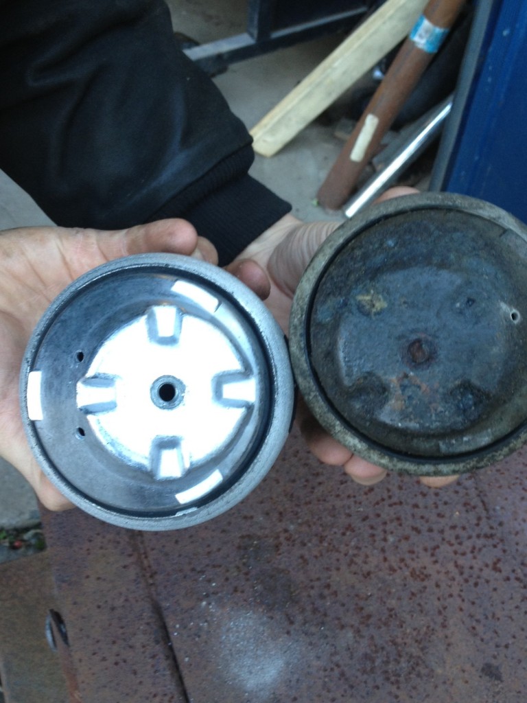

Mine failed at 142k... both of them. Apparently, two bolts on the bottom (the ones that secure the engine and the mount to the frame) rusted through and a hard acceleration finished the job. Almost took out the driver side axle because of the rotation of the engine. Will be replacing both of them. Pics of the failed ones are to follow soon.

Pics of the old and new mounts:
As you can see in the second picture, that is where the bolt secures the mount with the engine to the frame. On the old one, part of the bolt is still inside the mount. Other than that, took probably an hour to replace the mounts. Jack up the engine a little bit, undo 2 bolts (one top, one bottom). There is plenty of space to take out the old mounts and put new ones in.
