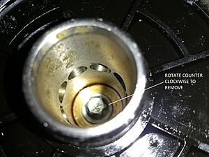

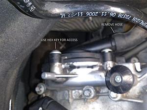

For the oil seperator AKA - rear centrifuge. You will need 2 parts and a 4 pack of screws (highly recommended). The M272 & M273 share the same part number for the Housing.
Part Numbers
Centrifuge = A 273 010 01 62
Housing Cover = A 272 010 06 31
T30Housing Cover screws package of 4 = 000000-001478
Tools needed
T30 socket bit
T30 Hex Key
6mm Torx OR Spline deep socket
1. Once you have removed the air box, you will be able to remove/replace the centrifuge and housing cover.
2. Remove the hose attached to the Housing Cover.
3. Using a combination of the T30 tools, remove the 4 Housing cover screws. The top screw closest to the shock tower was/is a pain due to the firewall. The Hex key worked very well for me.
4. The 6mm Torx OR Spline deep socket is where you will need to insert into the back center of the Centrifuge. My socket had to be clocked counter-clockwise to remove. Once the screw is removed, the Centrifuge will come out.
5. There is a paper-like substance inside the center of the Housing. Notice the old Housing is worn (or should be worn) compared to the new part. Once the new Centrifuge has been installed, snap the Housing onto the Centrifuge. The paper-like substance will "snap" onto the Centrifuge. Just be sure the gasket on the new Housing does not shift during install.
6. The 4 new screws can now be installed into the new Housing.
7. Reconnect the hose on the Housing and re-install the air-box.

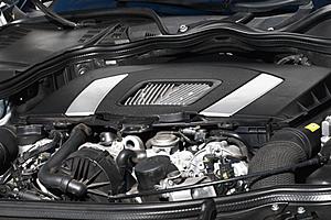

I am struggle to remove the back cover. The Front cover is just lift it up but for the back cover, I tried but it did not move. Any trick or should I remove some screw??
Help please.
--John
Attached Thumbnails Any Repair Instructions for 2007 Cam Plugs and Oil Seperator Replacement?-dpp_101_1.jpg
Old Oct 21, 2013 | 08:55 PM
Quadcammer's Avatar
Joined: Dec 2006
Posts: 4,949
Likes: 39
From: Clifton, NJ
96 and 08 911 turbos
nah, it sits on rubber mounts. It takes a good tug to lift it off the mounts but theres nothing else to it. some cars, like the cl550 have a metal bar that holds the cover down onto the maf in the back. that just needs to be popped off.
