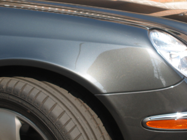

Here's what I'm talking about

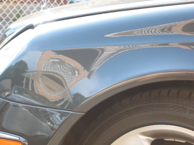

and the good side...

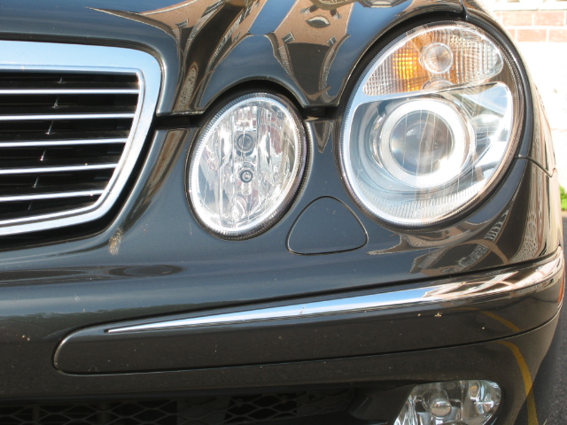

the bad side again

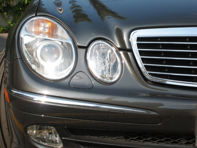

and the good again...

wow, that doesnt look good. i think it is a defected hood, i remember when we got our prenav car, i opened the hood, and closed it after looking at the engine, i didnt close it hard enough, and when we started to drive, i thought it wasnt closed, so i would try to close it again, just put a little bit more pressure on the right side, i push hard to close the hood properly, just make sure nothing is broken before, nothing worse than a hood hitting the engine or something GL with it man, hopefully the hood isnt bent or anything

hmm, after looking at the last two pics, i do think that theright side isnt closed all the way, and hopefully thats your problem, because hopefully it will close if you give it a little bit more pressure, i would try to compare it with my car, but right now the dealer is fixing a little problem with it, GL
