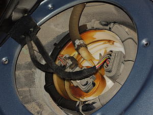

As our cars get older these plastic caps holding the fuel pump in place are stressing and cracking, causing a small leak that doesn’t smell inside the car until it is VERY bad.
MB is trying to get out of fixing this problem by letting us pay for a whole new pump and install. As far as I can tell it is the exact same part (new old stock), so depending on how long it’s been sitting on the shelf, it fails again.

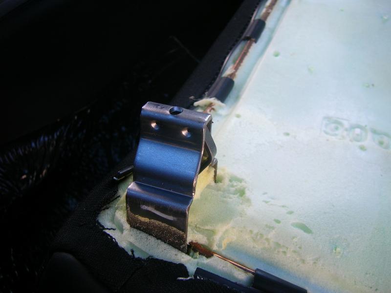

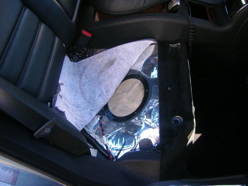

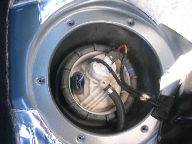

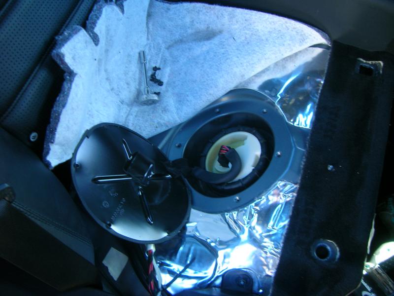

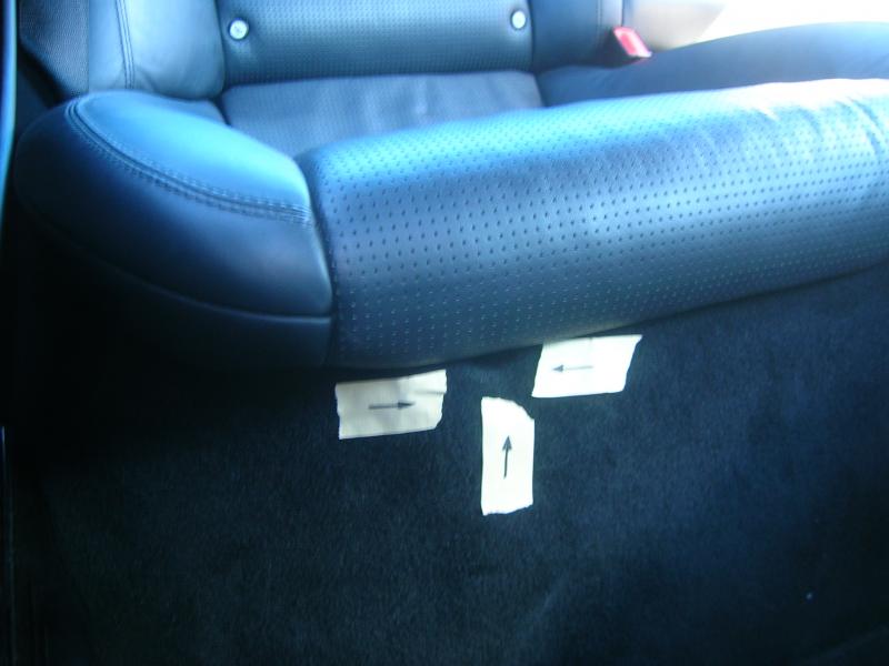

Put your finger in the hole to release the catch, lift outside corner of the seat cushion, then just pull it up (hard) The other side (inside front edge) is spring loaded but tight. It won’t break. Then fold the sound proofing mat back and unscrew the cover. 8mm socket or 5/16 if you don’t have metric. Use a screw driver or strong fingers to pop the cover loose. If it looks like it’s been wet in there (slightly oily) and smells like gas, it is starting to leak. Mine has been cleaned already to investigate further, and will look slightly different from an E class, but it is the same problem. The passenger side gets stress cracks from holding the pump in place.
There are other problems to be found, but they are not inevitable. The drivers side can have bad clamps, and occasionally the tank itself is cracked. I don’t claim to know everything about this, so if someone more knowledgeable has something to add please do.
