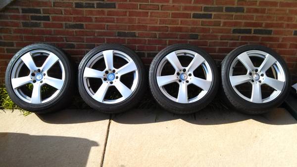

Will the attached 18" sport wheels off a w212 4matic fit a 2006 E350 4matic (non sport) model? The tires are Continental all season 245/40/18 all around.
Anybody has done that with pictures?

Welcome to the forum and be part of the MB family. Take a look at this https://mbworld.org/forums/e-class-w...s-05-e500.html I think he did what you are trying to achieve too.
In summary, you need spacers and longer bolts as the W212 wheel offsets are too aggressive (higher et)

The wheels and tires I found is square setup, all the wheels and tires are the same size, not staggered. They are 18x8.5 ET48 all around.
