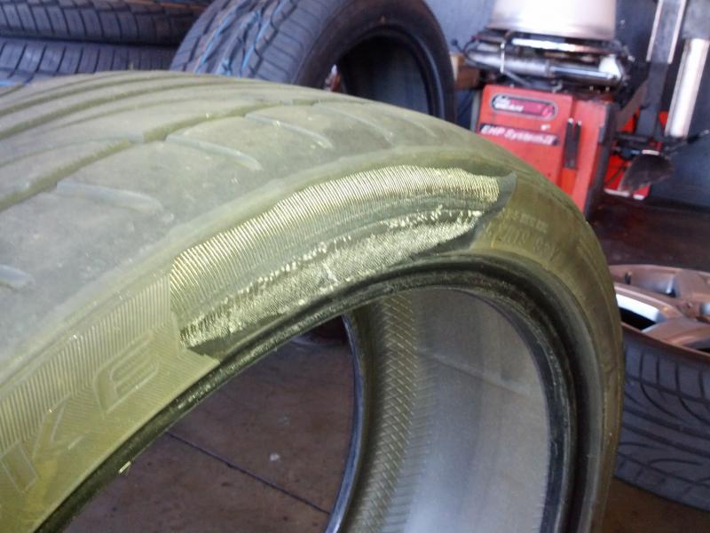

Currently running 285/35/19 10" rears and 235/35/19 8.5" fronts.
Also have 275/35/19 rears and 245/35/19 fronts
Also have 255/35/19 for the fronts.
I think the 235's are too skinny for the front. but they dont rub.
The 285's rub a little but I just need to adjust the lowest ride height with the star computer.
Had some nail and screw battles with the recent construction here in Vegas.
Also had a Falken FK452 245/35/19 that was officially defective..Falken is refunding me for 2 toyos I had to get because they dont make the Falkens anymore.
So DONT BUY FALKENS!! SEE PIC.

Old Jan 28, 2014 | 10:02 AM
Craftysince86's Avatar
Joined: Apr 2011
Posts: 902
From: Arizona
W211
dang that's ****ty about that tire, i've rolled tires with -4.5 degree a camber for over a year that looks better than that
if you don't want to rub, and don't want to go smaller tires you're going to have to either roll/pull fenders, more camber, or raise your car
low aggressive fitments require all three: stretch, pull/roll, and camber
