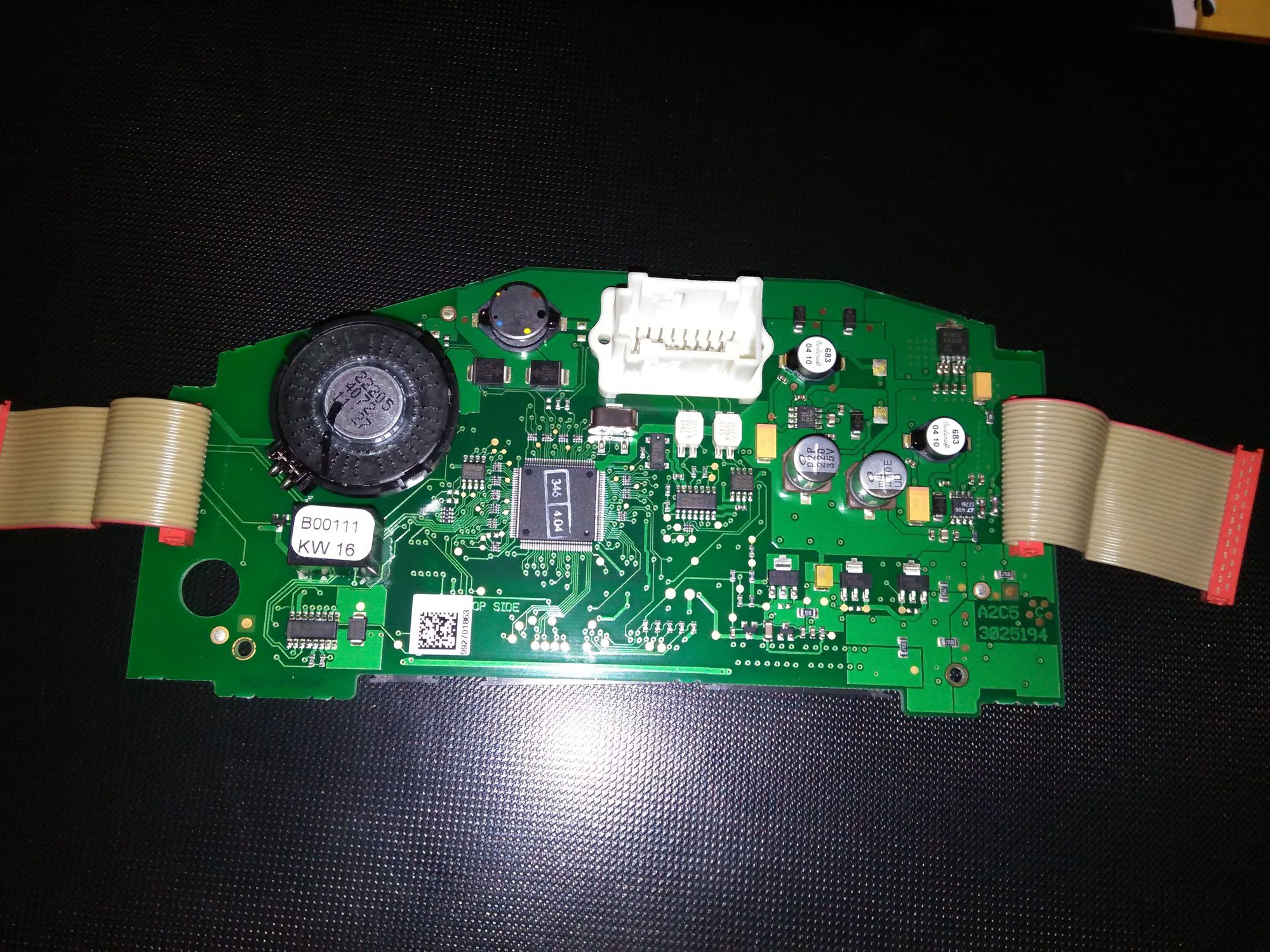

Hmm, just had the gas, temperature and odometer back light led fail.. common? Has anyone attempted to repair these..? With all of them failing at the same time I'm guessing a driver chip failure.
The gauges still have readings just no light shining from behind..
All other indicator and gauge lights work..

leds behind odometer, fuel and gas gauge (noted by arrows) are not coming on. gauge lighting (w/headlights) are working normally.
Quick update. the ribbon cable is fine, in fact it looks like an updated version. The LEDs that are not working are on the back 3 circuit boards. I'll update soon..

So it came to the point of parts swapping and I was able to purchase a matching part number speedometer cluster and found that the lights in the old unit were fine. The issue resides in the main board. Keeping the new speedo is tricky because the mileage doesn't match and it won't sync with the main ecu. (suggestions?) I'm guessing it could be synced at the dealer or maybe a good independent shop. (suggestions?) North Houston area.
Meanwhile I'll start looking for a likely controller chip or mosfet/transistor that might have failed on the old board.
minor update.. On the lower left is a Darlington Transistor Array IC.. it's failing to operate so I bypassed it and enabled the failed lighting. (I won't leave it that way because the lights, odometer, fuel and temp LEDs, stay on regardless of key position. )
