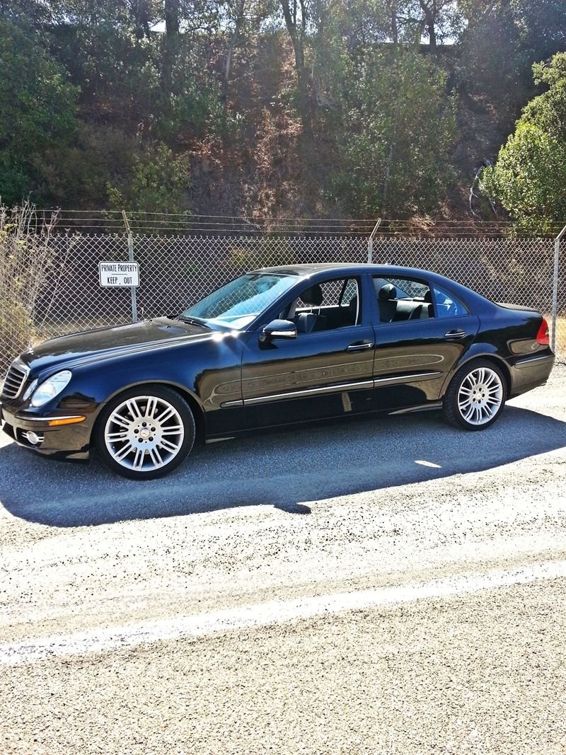

Not new to MB but grabbed a E350 2008 with 50k on her. Loving this car so far.
Quick question, anyone know the widest tire size I can do on the sport 18s? I know they are staggered, but wanted to go a bit wider then the stock recommendation, unless someone knows about rubbing issues etc.

Just for the record, stock wheel sizes are as follows:
RWD Models: 18x8.5 with 245/40/18 fronts | 18x9 with 265/35/18 on the rears.
4-Matic Models: 18x8.5 all around with 245/40/18
As for the front, you can run 255 on an 8.5 wheel with a little bit of sidewall bulge, which is what I do as I have 255/35/18s on 18x8.5 all around. For the rears, you could go as wide as a 275 with a little bulge.
If you want "square" sidewalls then you have the perfect combination as it is, 245 front and 265 rear. 255 is the widest I'd recommend going in the front regardless of wheel size just because of rubbing. It is different for every tire manufacturer and tire out there, since tires are made to fit a range of wheel sizes and will conform to the wheel itself - within reason. Go outside the recommended spec and you may be stretched if the tire is too thin, or bulge anywhere from a little to a lot depending on how wide you go. But for 8.5 front 245 is the ideal, and for 9 rear 265 is ideal.
In the looks department, you might want to go wider with aftermarket wheels if that's your concern. If traction is an issue, which seeing as how you are on an E350 it probably isn't as much, then get a better tire. You also want to make sure you have adequate rubber up front in comparison to your rubber out back otherwise you will increase understeer since there is less grip out front.
Hope that helps.

Thank you both of you! That was incredibly helpful. Thanks for the detailed responses. I'm thinking of going a bit wider in the back to get a little bulge, right now the tires I have on it aren't even squared they are "rounded inward" not sure how to explain it.

Yeah I would describe that as stretch, I would go with something like a 275! 285 would probably be pushing it I would recommend a 9.5 inch wide wheel for that. Beautiful car by the way, all of these black E-Classes are exactly what I like to see.
