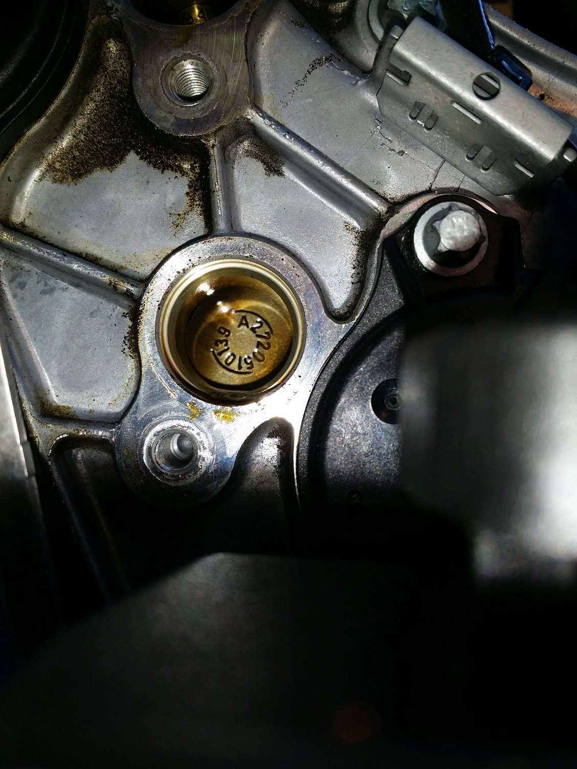

I came up with the same engine number. The balanced shaft issue scares the he'll out of me so I rolled the engine over to 305 and took these photos. As you can tell the circles are not perfectly in the center but I don't know how far off they can be.

I rolled the engine over to where i thought the marks were perfectly center and then looked at the crank and it looks like about 308*. That seems to me like acceptable but i dont know what the variance should be.

I wouldn't worry about the balance shaft until you get fault code 1200 or 1208. For your intake manifold, you can do the repair kit, but if your tumble flaps aren't broken then it probably needs a entire intake manifold. The pressure sensors never go bad and i mean never. There is a guided test for these intake manifold faults, you have to apply vacuum to the black capsules on the front of the manifold and that is how you decipher whats exactly going on. Just my two cents!
edit: I listened to your video, that sounds like a stretched chain to me. You could pull your cylinder covers off set timing to 40 until all the marks on your chain line up with your pulse wheels and go from there.

You can't really tell if timing is off by the way you are doing it unless you don't see any of the engraving at all through the peep hole. Set timing and remove those cylinder head covers since you already have everything else off. Just make sure you have some sealant encase you need to button everything back up to drive it somewhere.

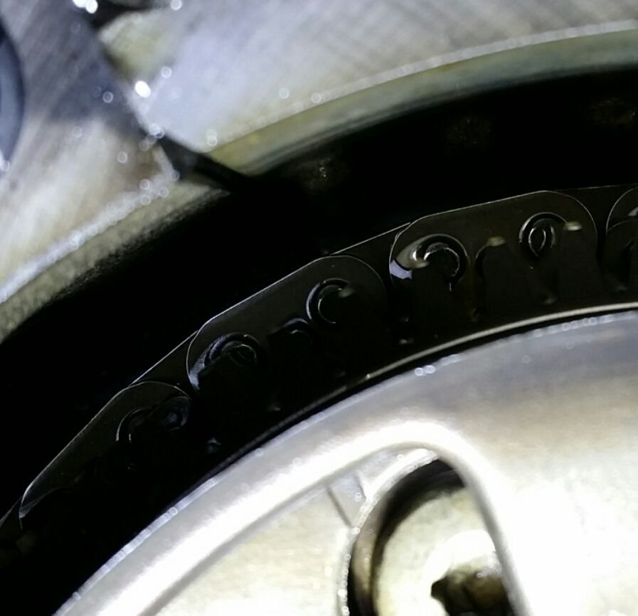

So I still don't know how to physically check timing chain and or guides for problems but I did check the can timing. What do you think? To me the cam that the chain goes around (intake I believe), looks like the seam doesn't line up between the lines.
