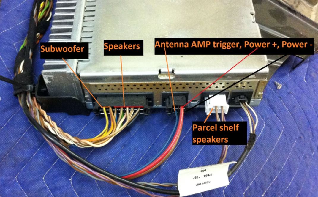

Hi all, I am trying to install an xtrons unit in my E55 but I am getting no sound. I am thinking the fiber optics decoder is bad. The head unit is powered on and I have the front L/R outs going to the decoder. The decoder has power and I confirmed using a multimeter. However I don't see any light emitted out of the decoder. If there is no light would this be a sign of a bad decoder?
Can you post pics of how you have it all wired?

The decoder has a yellow +12v wire and black GND sliced into the ADS 50 wiring harness which are yellow/red for +12v constant and brown for GRD.
Those are the only wires outside of L/R RCA inputs that are connected to the Xtrons HU.
I would think that a functional fiber decoder would have light being emitted if there is power and gnd.

Gazosnic was asking about all the wiring. In searching today for any answer I came across a very good write up on this xtrons unit. I am not sure if cross posting from other forums is allowed but google "Intall Xtrons head unit to work with MB AM" and you'll find the most detailed write up I have seen.
Still thinking i have a bad decoder as I have double checked every connection and still have no audio.

**note, no head unit can work well with the built in Optical Fiber amp. Once you go after market, you need to be prepared to remove the optical fiber amp and either run another amp OR power all your speakers from the new head unit**
Extras that you must order (Ask the seller for them)
IF your car has Harman Kardon logic 7 Stereo (COMAND NTG1), OR if you have amp in the boot and insert your navigation CD in the boot
*6M long speaker / power cable (AkA amplifier Bypass cable) (this will bypass your original amplifier, and provide power to the new head unit and power the amplifier for your radio antenna). **note this cable will not power the subwoofer, nor the front centre speaker, nor the 2 parcel shelf speakers, just the 4 door speakers and the small tweeters**
*6M long Antenna cable (because the factory amp had the antenna connected to it, now you must run this connection to the new unit at the front).
In order to connect the 6m cable, you need to remove the stock AMP and original head unit.
How to remove your old head unit http://lmgtfy.com/?q=how+to+remove+w211+stereo
location of the factory amplifier http://www.mercedes-forum.com/upload/img/IMG_4679.jpeg
in order to remove the stock AMP, you need to remove the cradle for the GPS DVD Player and undo the fuse box mounts. (This will give you bit more room to work with in order to remove the amp.
The amp is held in by 3 10mm bolts, 2 on the side and one between the quarter panel and boot cavity.
Completely unplug the old amp and connect the corresponding plugs from the 6m cables.
Those extras are all plug and play and will have the unit fully operating in your car.
END

Running the unit as is (with just the 6m amp bypass cable) will give you adequate sound levels, however because the car had Harman Kardon stereo in it, the speakers require more juice to operate efficiently and give that nice sound you previously had with the original amp, ALSO, there are a few speakers still not being powered by the head unit. Why? Because the unit simply cannot supply that much power, the old AMP’s IC alone was 10 times the size of the new units combined amp + processor IC. (Integrated Circuit)
To resolve this, we need to install a new amp(s) in the boot:
At this point, you have 2 options.
#1 Run 2 AMPS, one for the Subwoofer (mono block AMP), and one for the remaining 7 speakers in the car. (Surround sound)
#2 Run one high powered 4 channel AMP (200+WATTS per channel) and run 2 channels to the subwoofer, 1 channel to power all LEFT speakers of the car and 1 channel to power all RIGHT speakers of the car. (Stereo sound)
**note, unless you’ll be watching DVD movies on your new head unit, you won’t otherwise be experiencing any surround sound from the MP3’s you download / music you stream on Bluetooth, because they are all based on 2 channel Stereo output**
From this point I will be showing / explaining my setup which is based on option #2 as mentioned above.
* AMP: 4 channel, 4x300W = 1200W TOTAL. ~600WRMS
* 2x High to low converters (converting all 4 channels from the unit to RCA outputs)
* 1x Splitter box, (provides signal for tweeters and mid-range speakers) will be used for front centre and rear parcel shelf speakers.
* 1X automotive Amp fuse
* Appropriate gauge wires for powering the AMP etc.
LETS BEGIN:
Since the battery is in the boot, powering the amp will be easy.
Make sure you use an inline fuse for the + and DO NOT connect the ground to the battery! Follow the lead from the negative terminal and you will see a black box! That box filters out electrical noise, so make sure you connect the ground for the amp on the part of the black box that is connected to the body.
If you look at the 6M speaker / power cable. You will see a black 4 pin plug with thick RED, BROWN and a thin blue wire. (That blue wire is a positive remote trigger for the antenna amp. Splice into that to trigger the new amplifier into powering on. OR run a 5m long trigger cable from the new head unit as it has an amp trigger output.
Connect all 4 channels to the Converters so you have 4 RCA outputs in total, 2 for the FRONT, and 2 for the REAR. (Make sure you adjust the gain on the converters) (Don’t set them too high or else you will experience signal clipping which sounds like distortion)
Connect them to the AMP accordingly.
Connect the 2 REAR outputs of your AMP to the 2 inputs of your subwoofer (adjust the amp accordingly (set it to Low pass filter and set the Hz limit at 80-100Hz) anything higher and this will cause the subwoofer to play vocals (BIG no no!)
Connect the 2 FRONT outputs to the corresponding side of the car.
Front right channel connected to all the right speakers of the car (excluding the parcel shelf and front centre).
Front LEFT channel connected to all the LEFT speakers of the car.
from the LEFT output, run a new wire to the splitter box, and from the splitter box distribute the power to the FRONT centre speaker on the (Tweeter output) and REAR parcel shelf speakers on the (woofer output). (FYI, woofer on the splitter box just means mid range/ vocals and not thumping bass)
the reason why I set the front centre speaker to tweeter and not woofer is because I began to hear it crackling. And I have a feeling it’s smaller than the back 2.
That’s it!,
Set the gain and bass on the subwoofer high on the amp. Then go on the head unit and adjust the FADE effect so you have most of the sound FRONT bias, this means the sub won’t be as loud. If you wish to increase the sub level, change the FADE so it’s more REAR bias.
