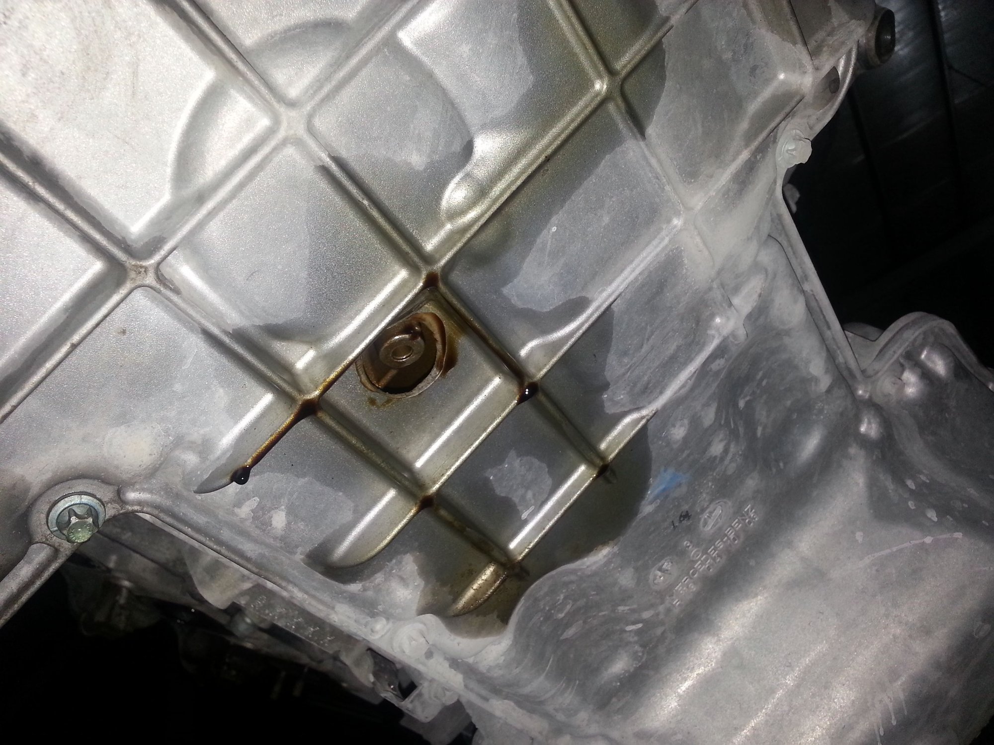

I'll post photos of the damage later if anyone is interested. Connecting rod went through the bottom of the engine case and punched through the oil pan. Intake manifold was full of water.

Yeah - basically wife was driving in a deluge and was suddenly in 18 inches of water for a short distance. Would have been OK except she accelerated instead of moving out slowly. Water covered the intake ports beside the lights, and she ended up taking water into the cylinders. Hydrolock resulted, and a connecting rod broke. The rod inverted on the crankshaft and pointed down on the next stroke, punching through the case and subsequently through the oil pan.
