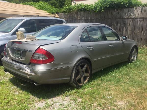

This was the damage. The paint and the lines between trunk life/body appears to be done correctly, but we will see how it looks in person...

You do realize that the manufacturer doesn't have to honor any warranty once it's a rebuilt vehicle right? The only one that comes to mind is the fuel tank extended warranty which is good for 15 years unlimited miles on non Pzev cars. E350's didn't have airmatic unless it was a wagon. Sort of a basic car, no p2 just p1. The front looks a little off too, the right side inner high beam light looks like it's not flush with the body. There are also random isolated issues you may encounter because it's been in an accident. If it was hit in the rear, I'd worry that maybe the trunk might leak when it rains. Happens occasionally even when there's no accident. You could go with a 2008 too, that doesn't have the balance shaft problem and you can just burn a copy of the navigation DVD that's out there. The 2009 had the updated nav which is good and bad, you need to get the original nav disk in order to update it, but you could sell it afterwards.
