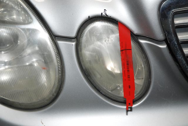

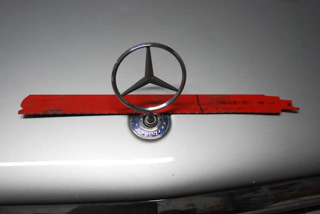

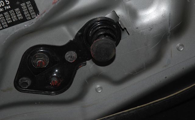

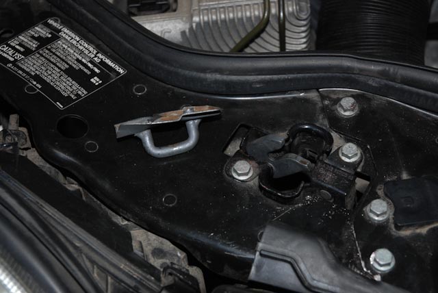

If the release cable is permanently stuck so that a passenger side latch cannot open, there is one simple and inexpensive solution -- reciprocating saw with a long blade. The only access to the hood grab locked in the latch is through a very narrow clearance between the smaller headlight and the hood.
Here are the steps. First, estimate the location of the latch relative to the headlight. Then insert the saw blade (without the saw) between the headlight and the hood to the estimated depth and locate the left and right edges of the latch grab by moving the blade around. This will also allow you to determine the initial angle, at which you will start sawing the grab off. Connect the blade to the saw (without removing it from the determined position) and start sawing.
The whole procedure takes no more than half an hour.
After the job is completed, unlock the latch manually and remove the sawed off grab. Don't forget that there is a "hood open" spring sensor under the latch. Use smth to have the spring permanently engaged before you buy a new hood grab.
See photos.
